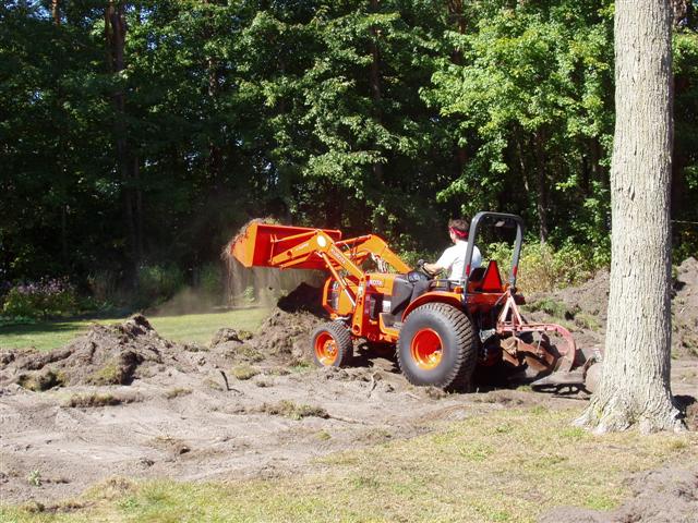

I bought one last fall and paid $250 for it so I would say that is a fair price. Mine is pretty much worn out. The points are good and it plows well, however the moldboard is wearing through on the leading edge and there is a lot of play in the tail wheel and coulters. I only use it for my small garden and for a landscape project I did last fall. It does the job I need it to do and will last me a long time. I found some in better shape, but they were priced higher, too. In excellent condition and with a modern two piece moldboard I think they would be $400 to $500 minimum.
