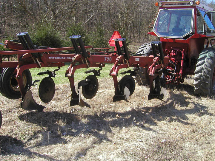

I would go with the three bottom but much depends on your soil. I am using a 4 btm IH plow behind a 140 hp tractor and there are many spots I would not want anything bigger. Even with a 4btm you feel like there is a lot of plow back there. Easier turning, more manuverability with the 3 btm.
