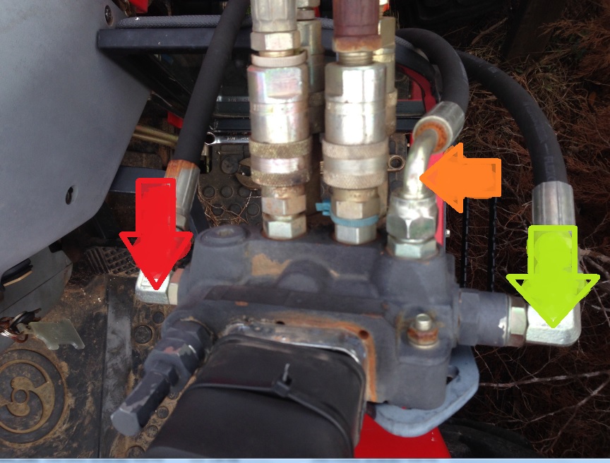

There are 3 hoses on my loader valve - what does what?
Red:
Orange:
Green:
I would like to add a remote for my log splitter,
which has pioneer couplings and it's own control valve.

What do the indicators say?...just guessing...green is pressure, red is return and the orange is power beyond back to the 3ph...just a guess...

The tall hexagon thing under the port with the red arrow is the pressure relief valve, which makes me think red is pressure coming in.
I don't know if green or orange is power beyond.

After a second look I think you are right...I was looking it at upside down...with all the valves I have you would be correct...
can you trace the hoses to see where they go? and just to be sure check the parts list diagrams for a description...

More than likely the red line is your pressure into the loader valve. The green is your power beyond (pressure out) and the orange is your return to tank line. The fitting under the green line is most likely the power beyond adapter plug.
If you want to make it simple and as economical as possible, just run a line from the green port to the back. Have a set of couplers at the back. Then run a return line to were ever the green line now connects. This will make a complete loop. Couple the hoses at the rear together or uncouple and insert your log splitter. This will work as is. If your log splitter is a 3 line system, then you will need to tee into the return to tank link with the return to tank line on the splitter.
Pretty simple, just have to remember that the lines at the rear MUST ALWAYS BE COUPLED, either to themselves or to the log splitter.

That is right the green is PB.
/ 3-hoses on loader valve - what does what? #10
A way to be sure about which one is the pb port...remove the line and the adapter and see if there is a removable plug inside...

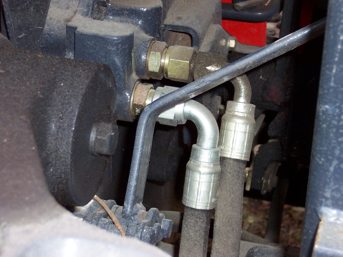

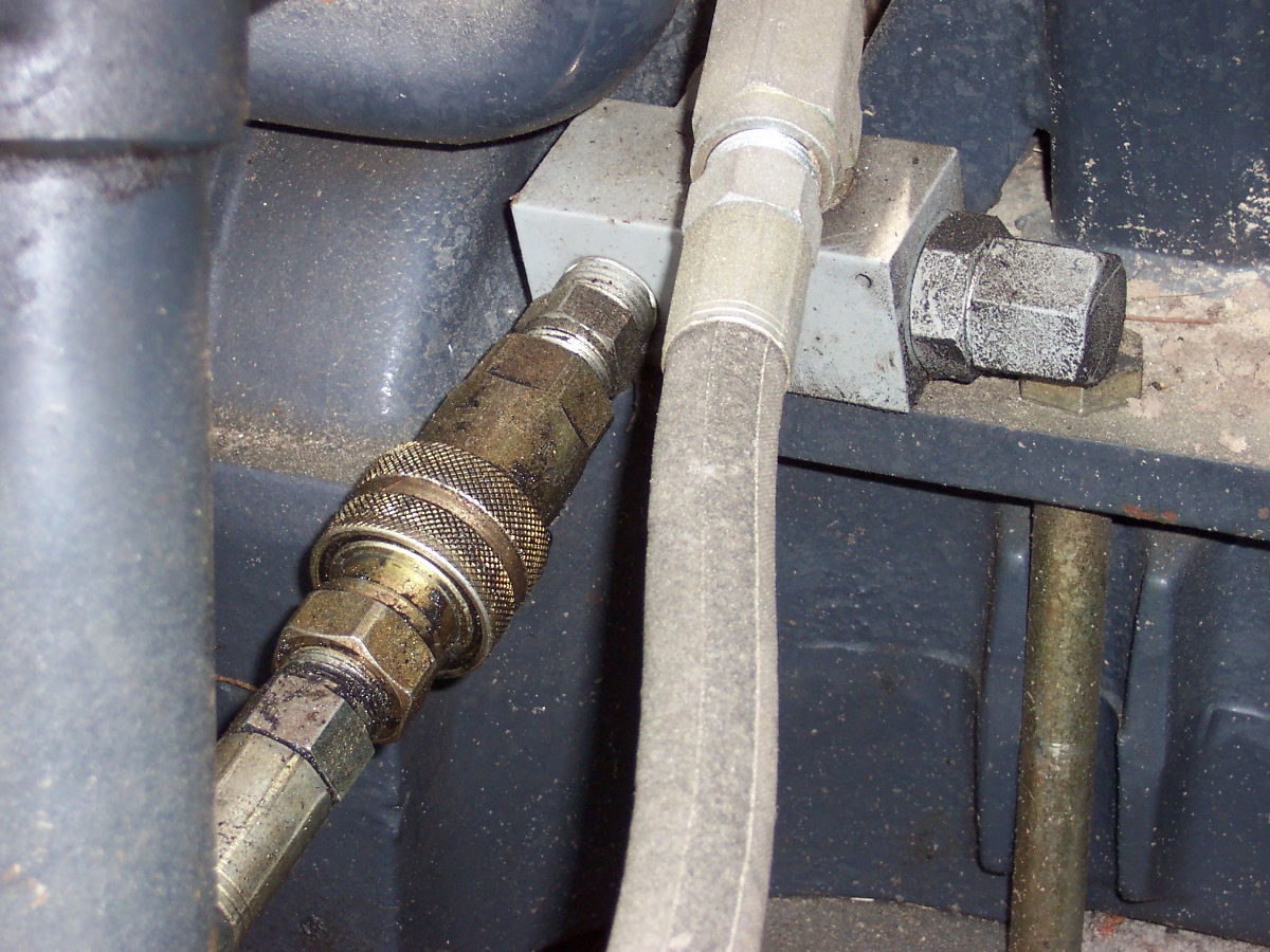

I needed power for my after market (Jinma ) Hoe so I located the ports at the rear on my 3510 and plumbed into them.
I put the bypass valve (aluminum block) in the circuit to make sure I would never Deadhead the circuit.
When the Hoe is not on I plug the 2 hoses together to keep them clean and let the oil flow it's normal path.

Red is pressure in from pump
green is power beyond to 3 point lift
orange is tank it will dump on right hand of lift housing
