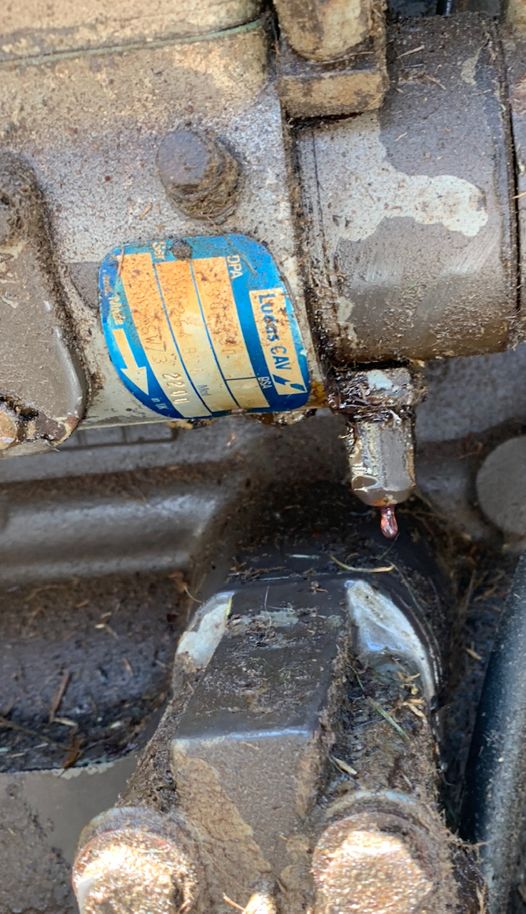

Got a MF-240 with 3 cyl Perkins diesel. About a year ago I replaced seals on throttle and shut off shafts now have a new leak. Its dripping fuel off what I think is a banjo bolt on bottom of pump onto oil filter below it. Thought it was coming from inspection cover to the left but after cleaning it up a bit can see it leaking above the banjo bolt, or what I think is banjo bolt. Have read they use copper and soft iron crush washers, anyone know which it is? Figured I would try and replace them first.

Yes, they’re Teflon washers..
I always send back more washers than people need, incase they drop some or find someone in need..
U can either wait for someone to chime in or u can send me your address in a private message & I’ll send u some..(free)

Thank you! Sending PM now
   / 3 cyl Perkins Fuel Leak #5
Gotta love this place! (y)
   / 3 cyl Perkins Fuel Leak #7
Kool.. 1 goes on each side of the line..& gets TORQUED TO 25ftlbs..
