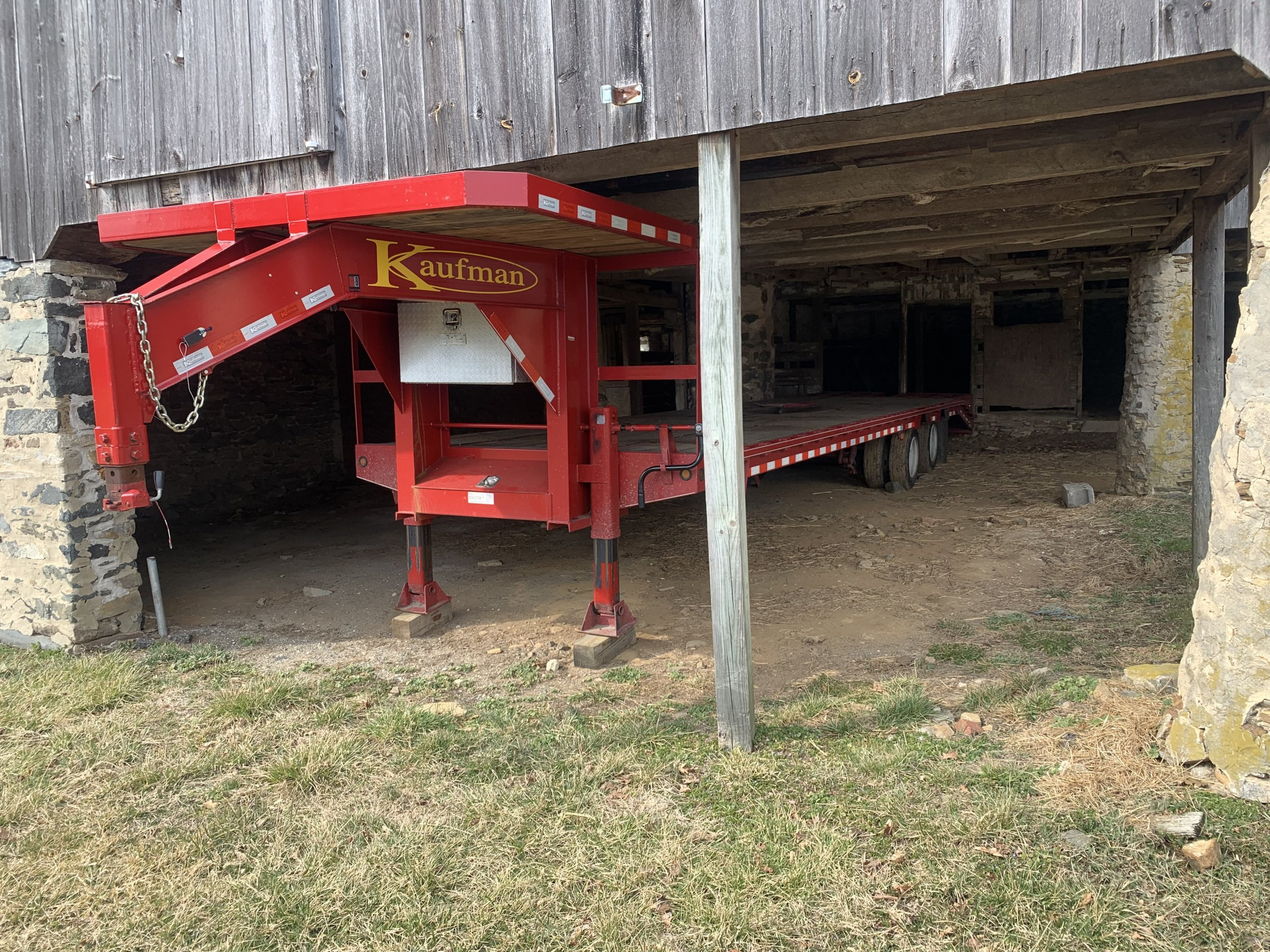

What Im looking for is on the trailer side, not the truck side.
For example, lets say you have a 3” ball already set up in your truck bed.
You buy a gooseneck trailer with a 2&5/16” hitch on it.
How would you convert it (trailer) to 3”?
From everything I see, trailers with round tube receivers are 2&5/16”. Only square has 3”.
Heres my Kaufman with 3”
Notice the hitch is square, not round tube.
So what I am trying to figure out is how to purchase a GN trailer with a round 2&5/16” receiver and convert it to 3”
My Elite horse trailer has a round tube and is 2 5/16, my Kaufman 24’ deckover has a square tube and is also 2 5/16. I think Kaufman just uses a square tube, because it is cost efficient.
I wish they all would. That way we could have the option of a 2&5/16” or 3” square coupler.
I notice a few other trailer brands will use square tube.
