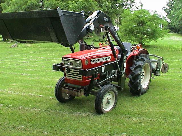

I went through the same debate just days ago. Finally purchased a YM2500 (2wd) with front loader. Used it all day today doing landscape work and love it. Had the tiller on for counter weight and worked fine. Had a mild slope to the ground I was working. I originally believed 4wd was a must, but now I know that is hog wash. I've attached a photo of my new toy. I purchase from Hal Livengood at Livengood Equipment in Villa Grove IL. He has real nice tractors and is a great guy to do business with.

That's a beautiful setup! If memory serves me correct, folks have been using FELs with 2WD for many years.
Thank you for that post. Opens up a few more options for
me.

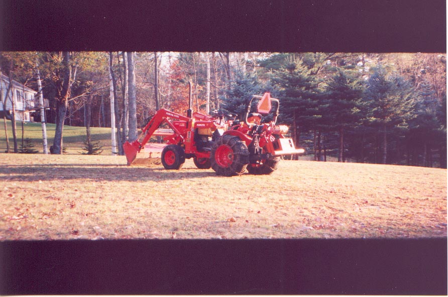

I very seldom use 4wd when there fel work to be done..except snow removal..just some counter balance plus tire chains for the rear turf tires.
Hope you have power steering,if not have a good grip on the steering wheeling. /w3tcompact/icons/wink.gif
