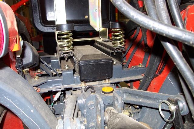

This last one is from the rear (hoses up and to the right go to the T&T).
The GlueGuy

Thanks for photos. You must have a 2710. The 2910 has a little different seat but the basic idea is still doable. I don't think the extra 2 inches will do much to the center of balance. I have alot of steep terrain.
I think I know what you did. You replaced the original bolts with ones 2 inches longer then drilled through the 2" square tube. Another possibility would be to use two sets of bolts and offset the seat to the rear.
Thanks again
Rick /w3tcompact/icons/smile.gif
   / 2910 Light/Turn Signal Switch Mount #13
Actually, it's a B7500. /w3tcompact/icons/smile.gif One of the reasons that I'm curious why a B2910 doesn't fit you when we are so near the same size. With this little seat extension, the B7500 fits me just fine.
The bolts going into the seat rail are the originals. I put 4 new 3/4" bolts into the frame. So there are a total of 8 bolts now.

Perhaps I am just a clutz /w3tcompact/icons/smile.gif
When I went tractor shopping. I "tried on" the tractors- checking for fit. The BX models were just too small. The 2910's adjustable seat gave me a little more room than the 2710. Its still a tight fit. Mostly, my legs stick up so raising the seat would be a real help.
Rick

You know I was always knocking the turn signal or light switch with my knees too. Then I discovered the little lever that allows you to push the seat back several inches/w3tcompact/icons/shocked.gif. That and the extensions made all the difference.
The GlueGuy
