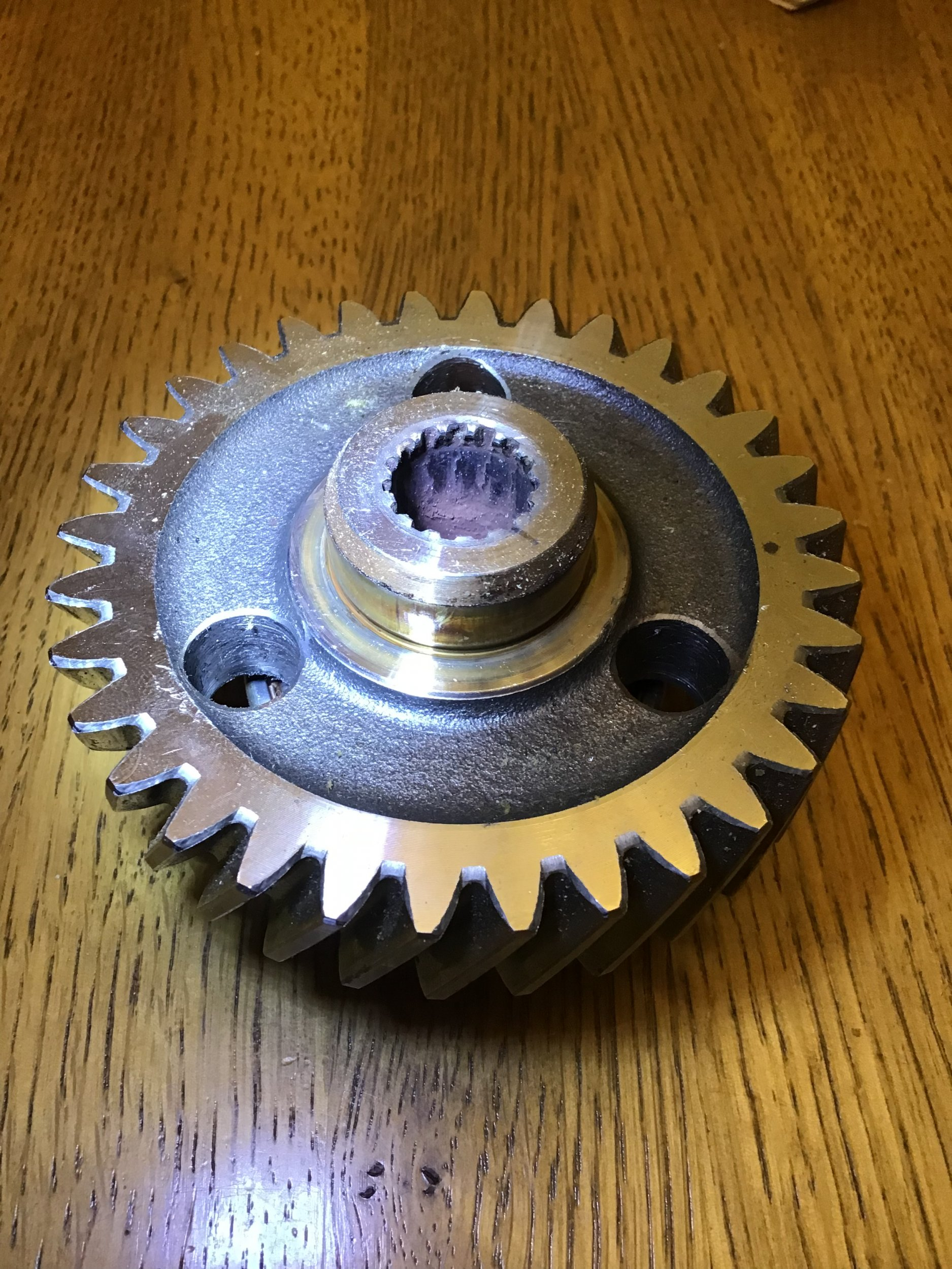

This is a photo of the drive gear for the main hydraulic pump. About six years ago, this drive gear stripped out it's spline. The pump shaft was ok, but the drive gear stripped its spline.
The folks at Branson said this was indeed a problem on some of the units and attributed it to the fact that there is no lubrication in this part of the engine. After reading up on "fretting" I would say this gear was a victim of the same thing. It was not an easy repair, as the front cover of the engine needed to be removed (after numerous other layers 😜) to access and replace the gear. I will be pulling the pump off and checking it and adding "spline grease" to it while it's all down.
I went through the exact same failure on my 3510, I had enough damage to the pump shaft that I didn’t feel like I could just replace the gear.

Reading this makes me wonder if I should pull the pump on my 2400H and look at splines as preventative maintenance. A little elbow grease is cheaper than new parts.
Same here. I even have to pull the suction pipe completely out to fix my mishap, so may very well take full advantage of that. May also do the same on the splines for the 4WD shaft.
I never even thought about 4 WD shaft but that is another rather easy item to inspect.
When mine failed, the pump would not come out. I tried everything I could think of, even driving wooden wedges between pump/housing. I damaged the housing finally getting it out, luckily the housing was cheap. The remaining splines were out of alignment, had I known maybe I could have rotated the pump. The very edge of the drive gear had enough teeth left to cause the hang up. As 6shotz mentioned, it is a pretty involved job replacing that gear. i really don’t know why it failed, maybe there’s something to it not getting lube, mine definitely showed rust inside the gear.
