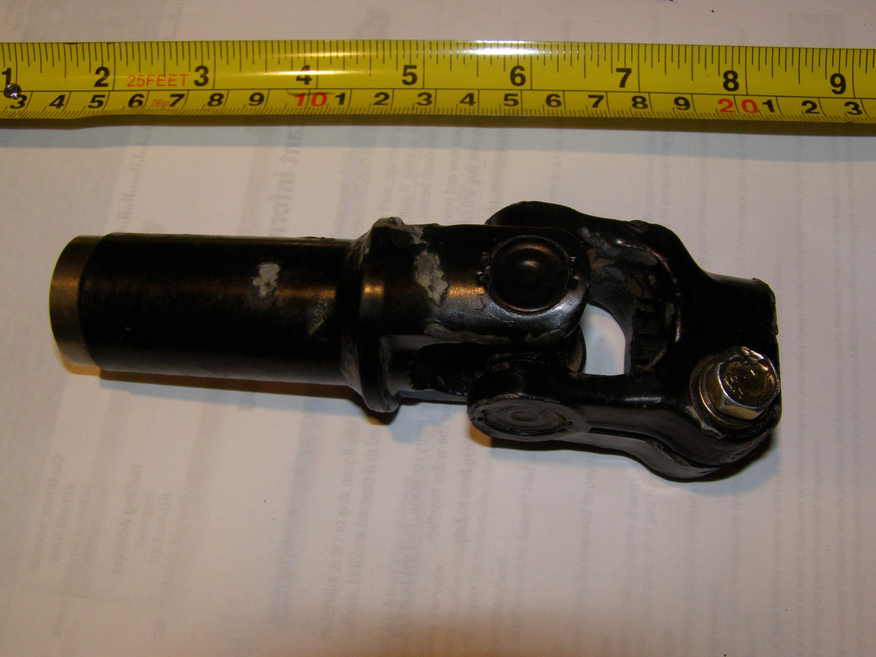

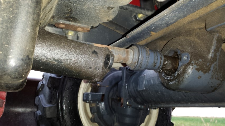

You have a photo of your new drive shaft? Or the old one for that matter?
/ 273 Drive shaft - Me too! #3
I assume the old one looks like this? Has anyone had theirs replaced before failure?

Nope. It is the shaft above that between the engine and the HST. The shaft you posted powers the front end in 4wd. The ends of the shaft you pictured are the same as the old style shaft being replaced.
