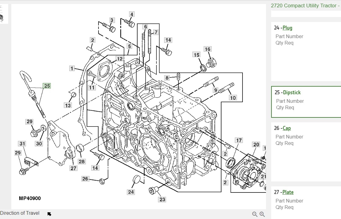

My 2720 has been a challenge and no one seems to have an answer. My jd is 11 years old with 86 hours on it. My site glass is completely red.( always has been) Parked it on flat surface. Moved it up a hill, down a hill and the red stays constant. Jd corporate insists I have a dip stick. NO such stick on my tractor. They tell me to remove some fluid so I see a level in the site glass. Rather than open the valve and have it gush out, is there a way I could siphon some out? Supposingly 4.6 gallons in the unit. Suggestions?

Not sure I follow what the "challenge" is, but apparently you have a reason to be concerned that the fluid is over-full. (or is there an apparent problem of being over-full?).
If no problem, then I would leave it be, knowing that there is enough fluid to keep the sight glass full.
If a problem, then think I would just remove a hose end coupling and run some fluid out into a clean container carefully.
The red is from a red dye, so the fluid is visible in the sight glass.
Per JD parts, the schematic for the tranny shows a dipstick on the left side, key #25
