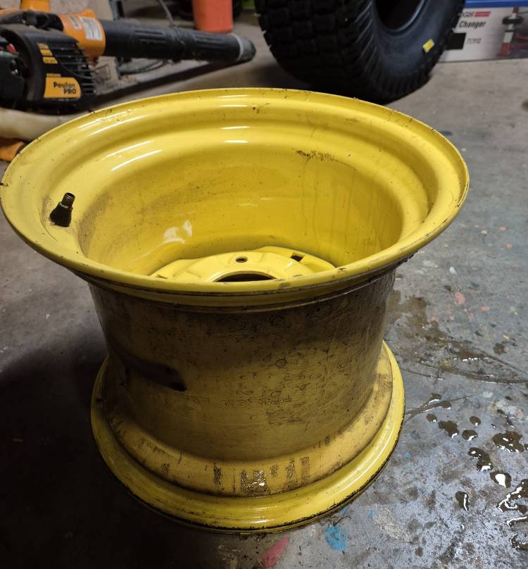

I have a Deere 455 I'm installing new tires on new rims. I used a Harbor Freight tire changer, removed old & installed new tire. Getting it to make the bead is problem. I tried ratchet strap tire middle but seems worse. I have Ruglide and dish detergent brushed on, then tried rubber and dead blow orange mallet trying to at least get one side on...nada...
I've never tried but heard of I'm thinking lighter fluid in tire & match will work???(?).
Any thoughts...thanks. Last resort I guess I could order inner tubes.

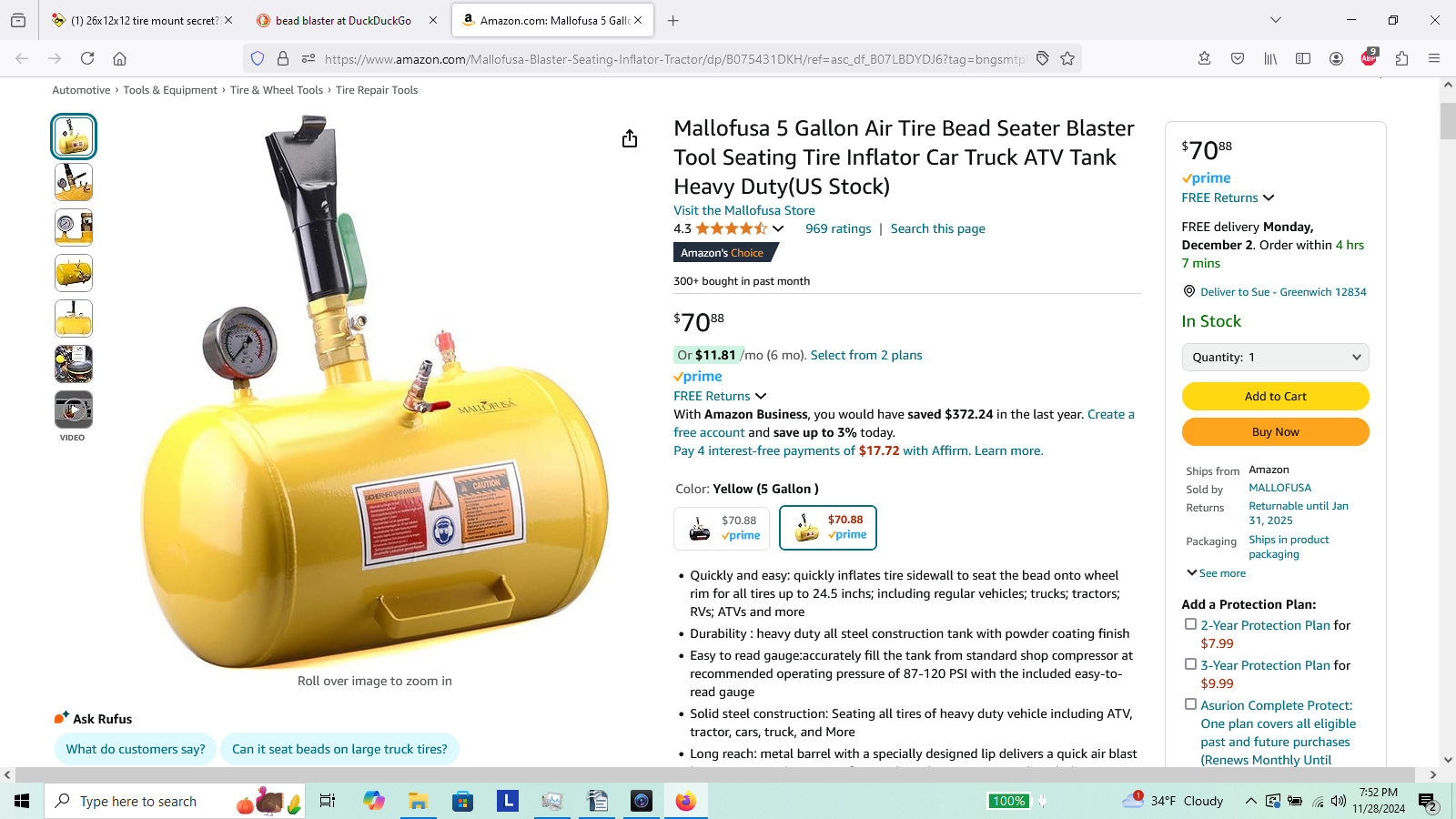

A bead blaster can be your best friend;

I'ved use all 4 methods: starting fluid (NOT strait ether), the tank blaster, a corn grease based goop that fills in the gap and then squirts out, and tubes. Tank blaster works OK may need multiple shots to seat both sides. Starting fluid is the most scary but YouTube videos show safest way to do it. Most guys use too much and don't get enough inside the tire carcass to stay (it leaks out the lower bead). The corn grease is a sure thing, but leaves a mess that can leave some 'remains' inside the tire. Next time it's on your hands, tools, changer, the tire, etc.
The 12x12 wheel is the problem because tires, as shipped, look to prefer an 8" bead width. Heat the tires up to soften the sidewalls which will make the air blaster a sure thing. I use my air supply with the schraeder valve guts removed simultaneously with the blaster or goop use.

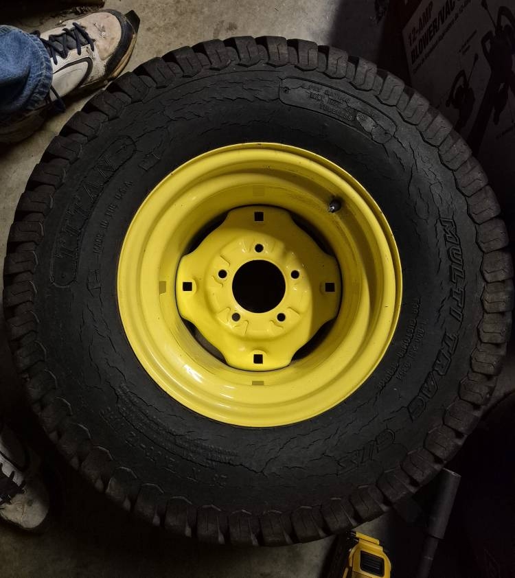

I tried everything, nothing worked. I was about ready to order the bead sealer when I tried the spray. It just took a few seconds, worked great. The only mistake was I had valve core in stem, so apparently created a vacuum inside tire, making a perfect square box! I quickly filled with air and it's fine. It's mounted on 455 in picture.
