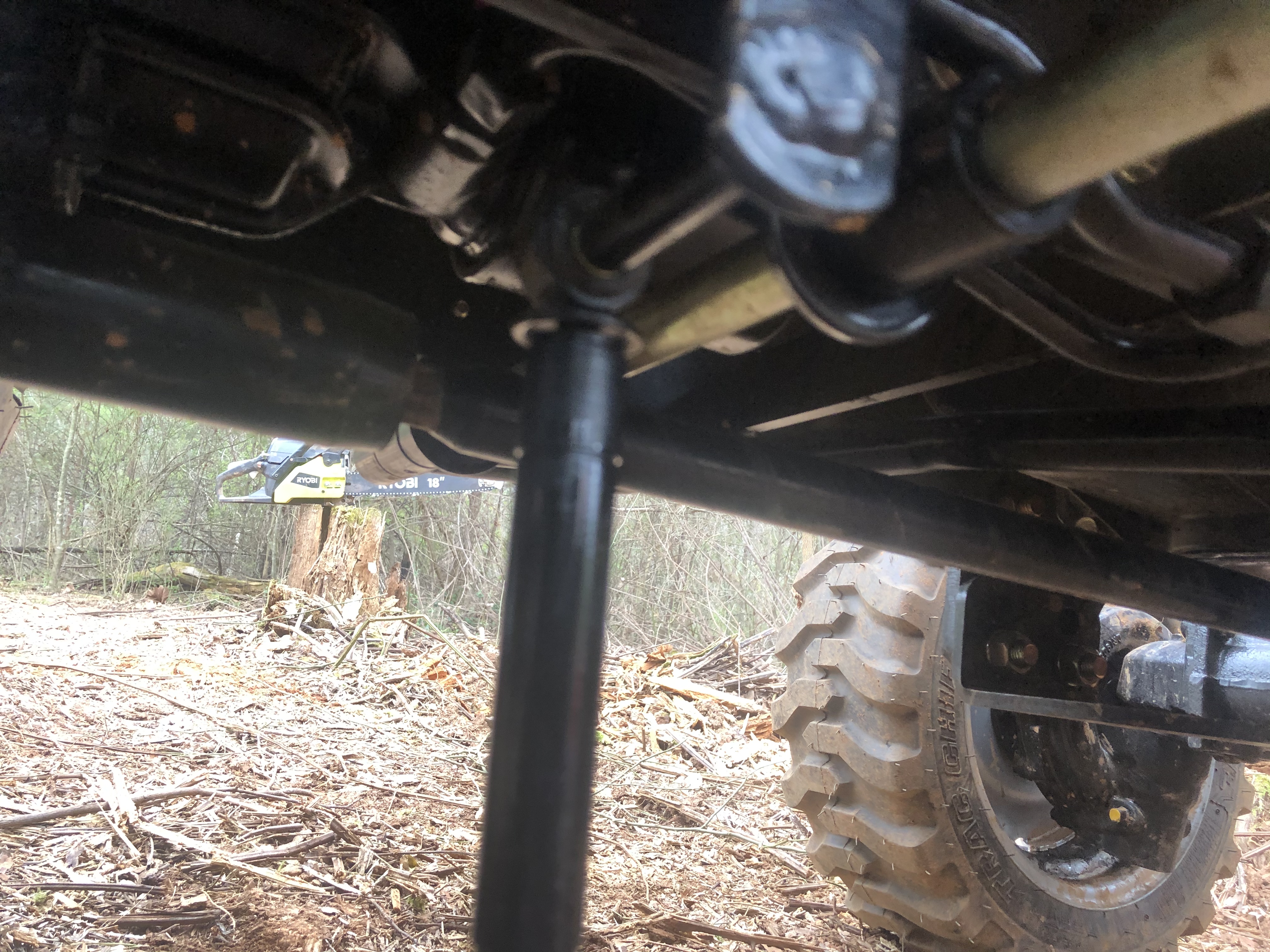

What is this piece and should it be connected to something? Not sure if it痴 related or not but my trans fluid sight glass is empty even after putting in 3 gallons but I can稚 find a leak anywhere. 39A870CF-9F79-4F8F-9619-17A1D75ED117.jpegB3C08094-8881-4F58-97FC-545BFAF71695.jpeg
/ 264 - What is this? #2
Looks like a hydraulic damper cylinder.. :2cents:
/ 264 - What is this? #3
+1 for the damper cylinder of the HST linkage. Although it shouldn't be flopping around like that. There should be a tube where that thing slides into.
