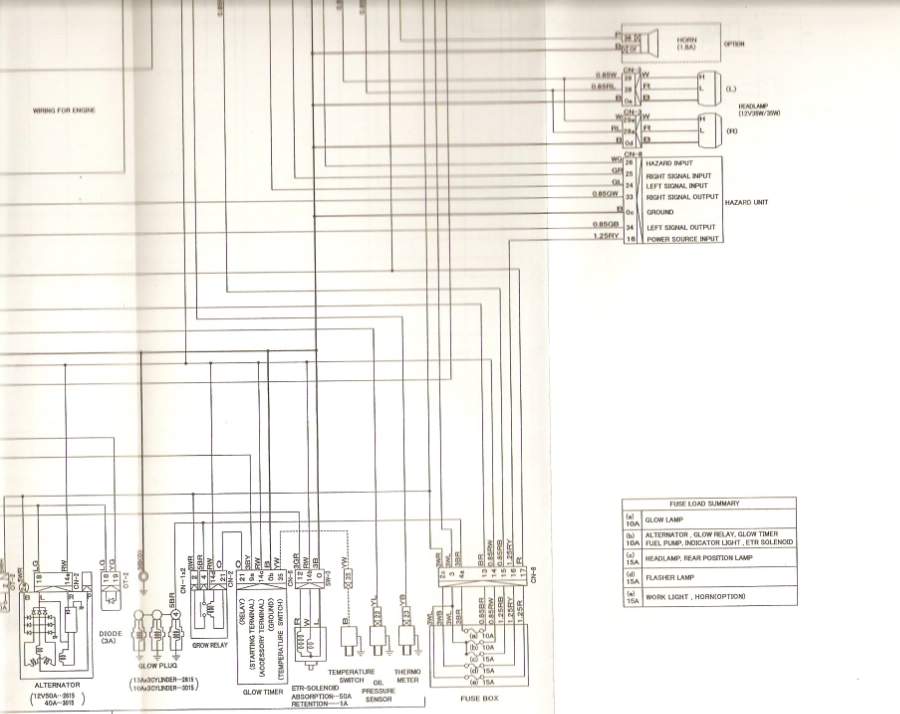

I bought the parts and service manuals that cover 15 series tractors. It lists the glow plug relay as #MM431-28201, controller/timer as #31A66-05100, and plugs as #31A66-03201. The service manual has schematics.
I mentioned earlier that the glow plug indicator fuse is fuse A (10A) also the glow plug relay and timer is on fuse B (10A). Fuse B also serves the alternator, fuel pump, indicator light, and etr solenoid.
According to my parts book the 2015, 2615, and 3015 all use the same relay, 2015 and 2615 use the same controller/timer,(3015 is different and has separate controller and timer). all 3 use different plug #s. I attached a partial drawing for the glow plug circuit, maybe it can help you.

The part number I gave you is taken from the part that was originally installed and has been working fine since I bought the tractor, which I think was in 2005. There was a change in the glow plug electronics, which based on the serial number on my tractor (26G050771730), was implemented a few thousand units earlier than mine.
I appreciate you sending me the schematic. Unfortunately, because of the change in electronics, it doesn't match what is installed on my tractor.
