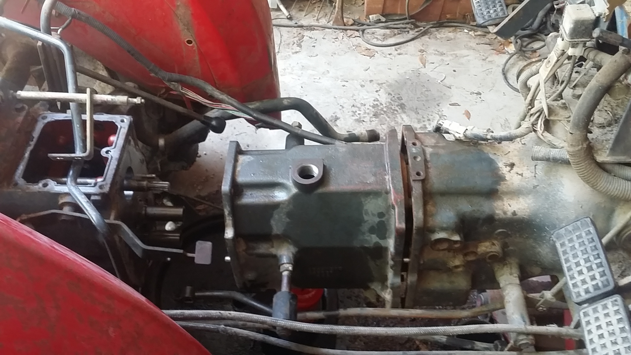

20140922_125711.jpggot it apart but second half at bell housing dosent want to seperate?
   / 2615 pto stopped #32
Got to hand it to you. Don't know i would attempt this. Keep us advised!
   / 2615 pto stopped
#33
She's working !! Thanks for all the help!!!
   / 2615 pto stopped
#34
With a 3/4 pipe cut in half run along shaft through access under seat and tap coupler forward until it stop .
