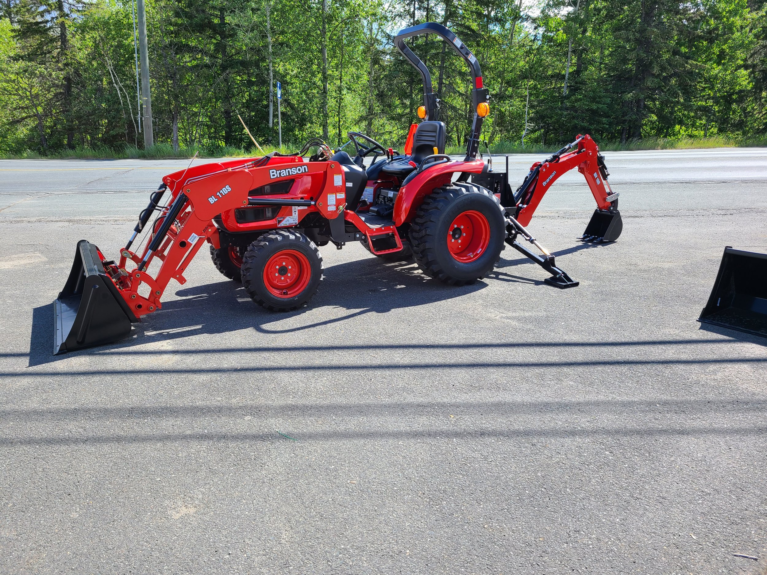

There’s a new Branson dealer in my area, they don’t know a whole lot about the tractors yet. I’m still waiting on an answer if the mid PTO is an option or standard equipment on the tractor. If anyone out there has one, can you tell me if it is an option or not? OR does it come with the mid mount mower setup? What mower do they use? Branson’s website is not updated showing the BLS110 loader on the 2610H and I can’t find any info on the mower. Does anyone have the 3rd function kit? If so, was it a dealer aftermarket install? I’ve researched all the colors of tractors and I keep coming back to this as the best value for size as a replacement for my old JD1050.

Sorry for the late reply, I am new here.
Yes your dealer can add a mid pto, a bm60s mowing deck (same as 2510h) and third function valve. Those are options from Branson.

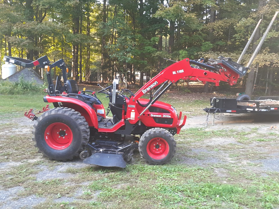

Mid-PTO is stranded on the 2610H.
