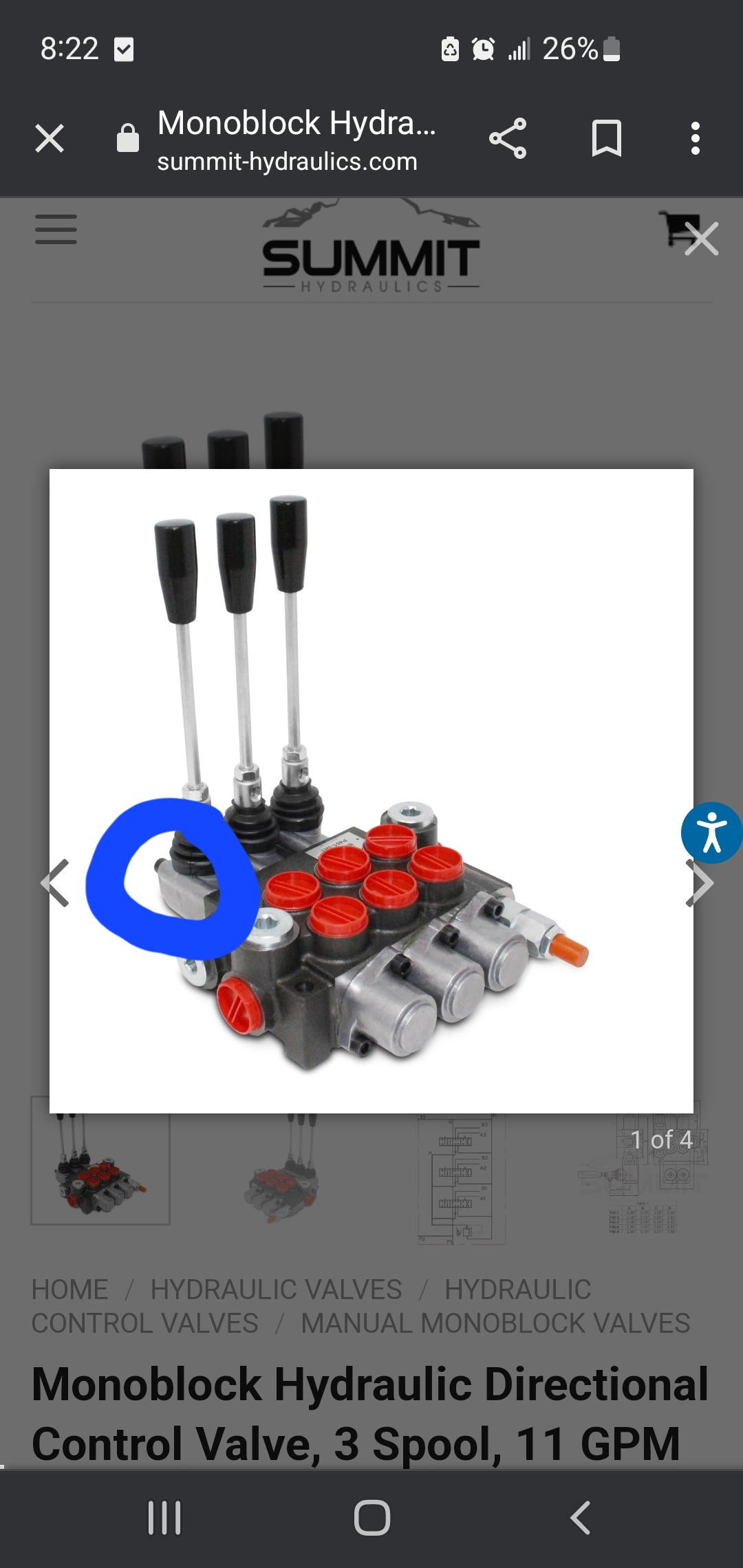

Got the valve mounted in place, now I can measure hoses and order fittings. Is it possible to reverse the end of the ?spool housing? (In the picture below that would make the handle boot point down. ) that would really clean up my install. Screenshot_20220914-202226_Chrome.jpg
Hope you can make sense out of that.

Yes. Take the two bolts, rotate 180 degrees and bolt it back on. You don't even need to pull it out completely. Just rotate it.
EDIT: It's either a 4 or 5 MM Allen wrench.

Perfect! I thought that might be the case.
