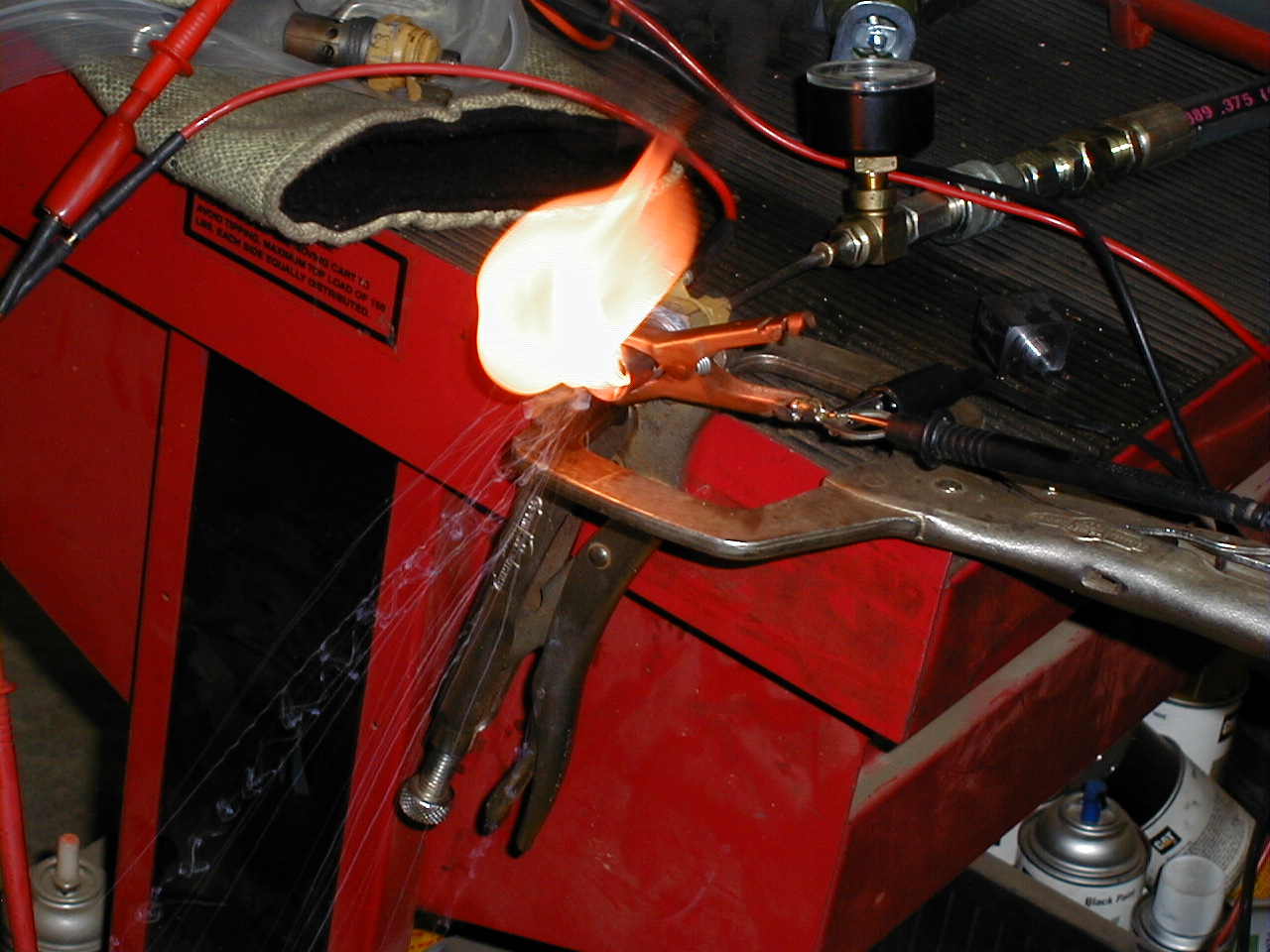

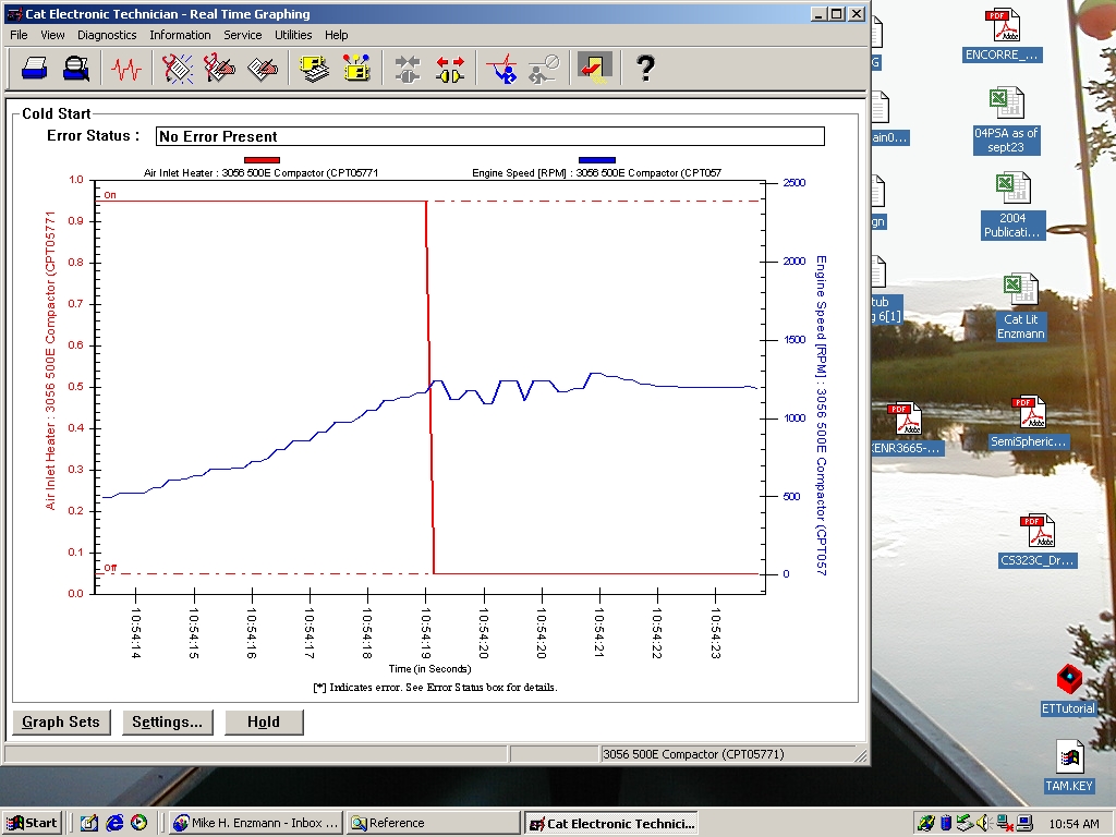

Here is my opportunity to show the Perkins thermostart. The first picture shows power applied to the coil. You can see the element inside the tube like housing. Holes in the sides are to allow oxygen to feed the fire. In the second picture heat from the element has opened the spray valve and the coil ignited the spray - you can see unburned fuel shooting out. This is actually a Caterpillar version - same Perkins engine painted yellow, a 3056E Tier 2 engine. The graph is information from the engine ECM on which I plotted engine speed versus the thermal start. Once the engine reached 1200 rpm it turned off the thermostart which cut the fuel flow to the manifold. Notice how smoothly the engine had been gaining speed over the 5 seconds before the thermostart cut off but then immediately started running a little rougher without the manifold heat for the next 3 seconds until it warmed enough to run on its own.
With this computer monitored system we could control lots of things - length of burn, time the coil would stay energized, etc. Most operators didn't know that with the manual system they didn't get any manifold heat until they started cranking - no fuel no fire no heat. You could, however, burn out the coil from overheating. Electric lift pump machines could get fuel sprayed and lit but without the engine cranking it would burn up all the oxygen and the fire would quickly die. It even took the techies in the lab in the UK to get it right. They first turned off the thermostart once the engine started cranking. We didn't learn that until we had new machines to ship on below zero Fahrenheit mornings and they wouldn't start. Fortunately we had a forklift with which we could pick up a 35,000 pound machine, place it on a truck, and send it south while we figured out where they had screwed up.

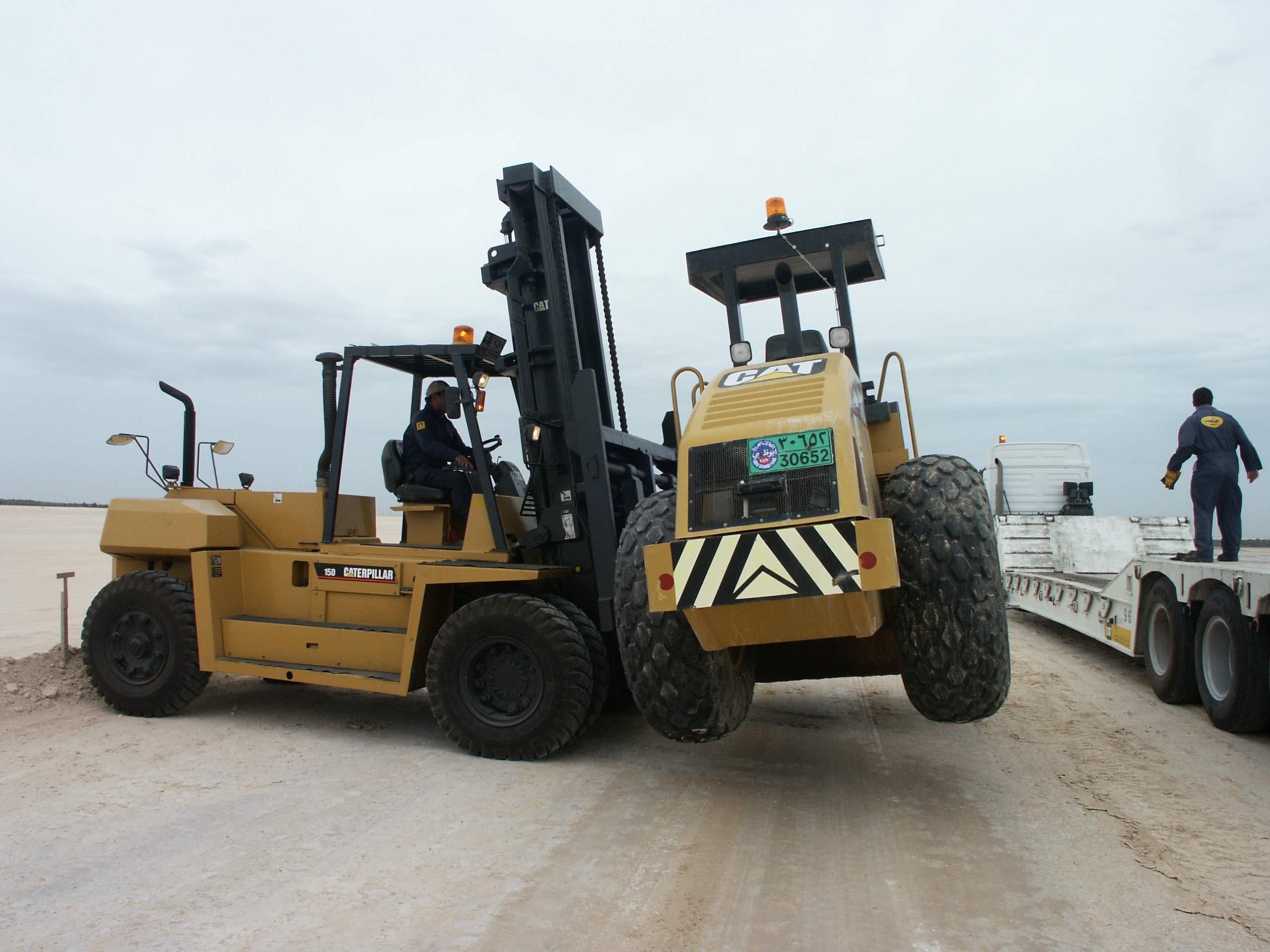

This isn't the fork lift we use at the plant but it is a similar one I took a picture of when we were loading a compactor with a bit of a problem onto a truck in Abu Dhabi. I mean send a Minnesotan out to the desert to trouble shoot a series of hydrostatic failures? Now way! Bring them into the shop and let me sit in air conditioning. Well, not really the case but nobody wants to break into a hydro system out in the blowing sand so they are well prepared to haul most broken equipment into the shop. Load the fork lift onto the truck, unload at the job site, pick up the breakdown and set it on the truck. Drive the fork lift onto the truck. Anchor everything down. Attach the tractor back onto the trailer and off to town we go. When I found a pic that showed the complete forklift I felt I had to attach another pic from that folder.
I really haven't had much experience with determining the lifetime of the thermoheat. Since the products on which I worked were compactors - not many get used when it gets cold so almost all my experience was helping guys in the plant (Minneapolis) getting them started for shipping on cold winter days. Other than that I would pass on requests to Engineering from dealers needing to supply machines for out of the ordinary applications - gravel roads over permafrost in the deep of winter, customers wanting to run at 16,000 foot elevation in the Himalayas. These were out of the ordinary applications for a vibratory compactor but Caterpillar never turns down a sales opportunity and some of those challenges were so interesting I took them on myself rather than passing them off to my staff. Those more exotic applications - once the product leaves the factory they go to dealers who are so capable of handling the exotic location I would never get feedback. The setup in my pictures are from a test setup one of our mechanics made so I could send proof to Engine Division they had a software problem. They gave me feedback about why they wanted to limit heating duration (increase system life), then admitted they goofed, quickly corrected their software and we created a field program. Part of my job was tracking reliability and thermostart valves never showed up on my radar screen as being a problem. Of course I would only be able to look at failure data during the warranty (including any extended program) period.
