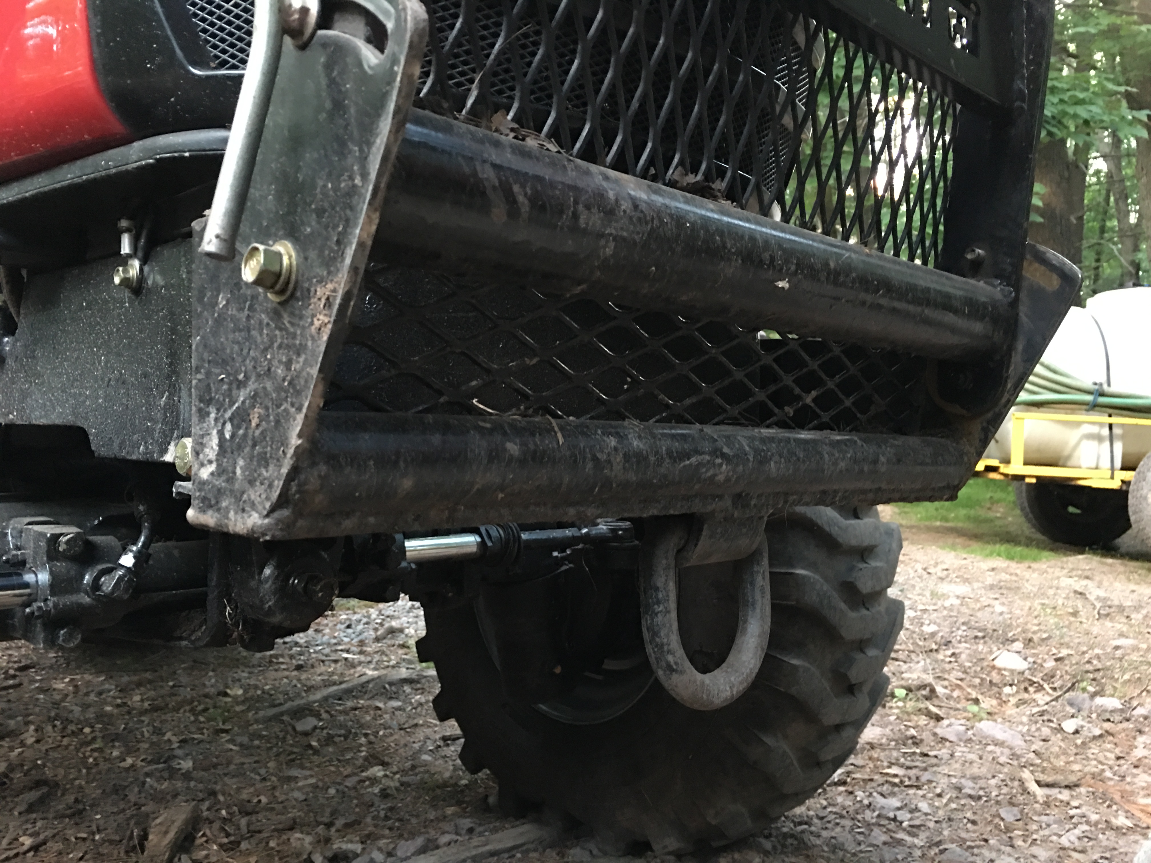

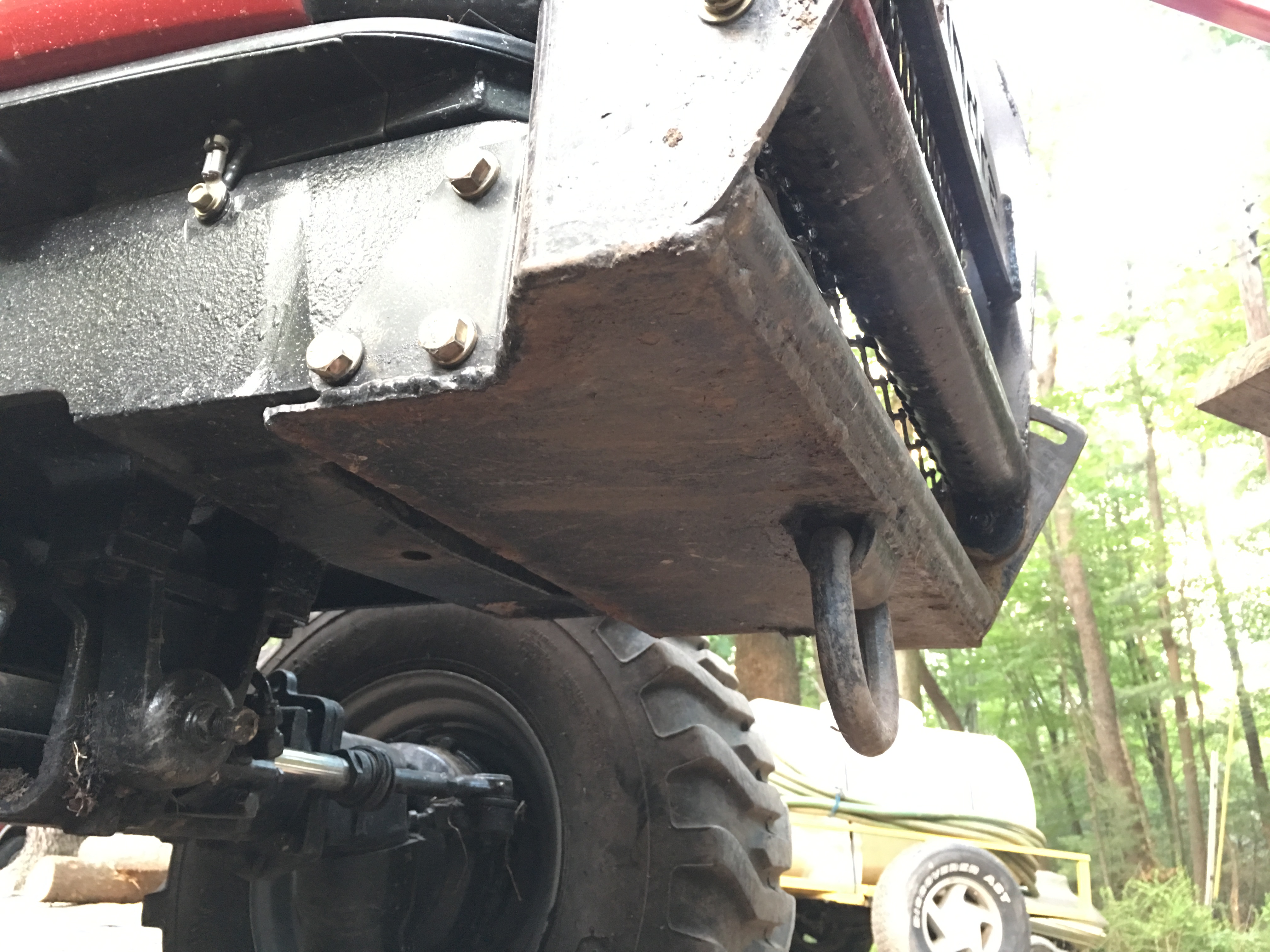

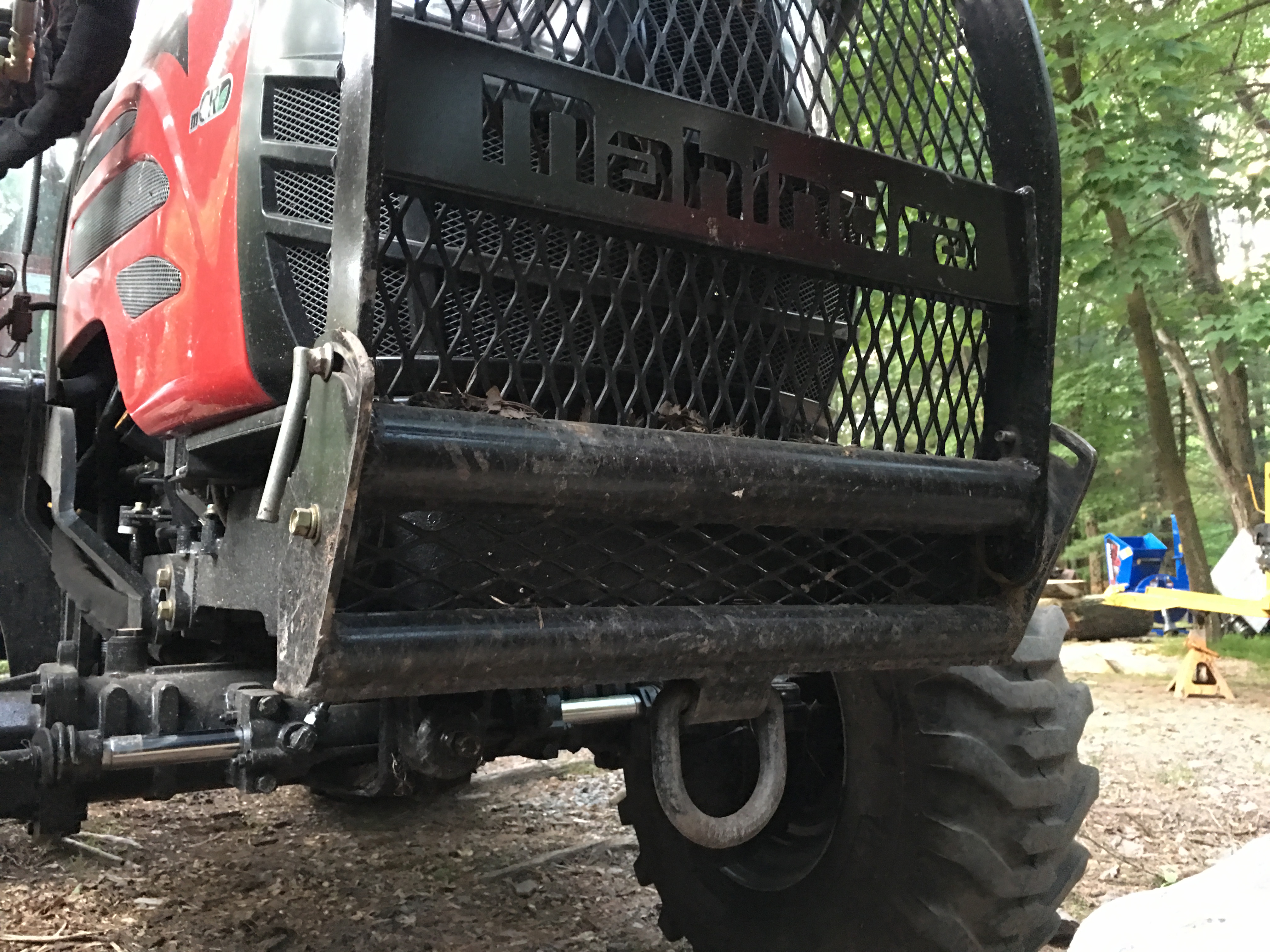

This is how I tied down the front of my mahindra 2555 cab tractor. hold.jpghold2.jpg
/ 2555 Tie Down points #25
loader cross member under the front and then get you a clevus for the back
That is how I tie down. The loader frame has a large hole in it for a chain hook. I think criss cross the front and clevis in the back.
