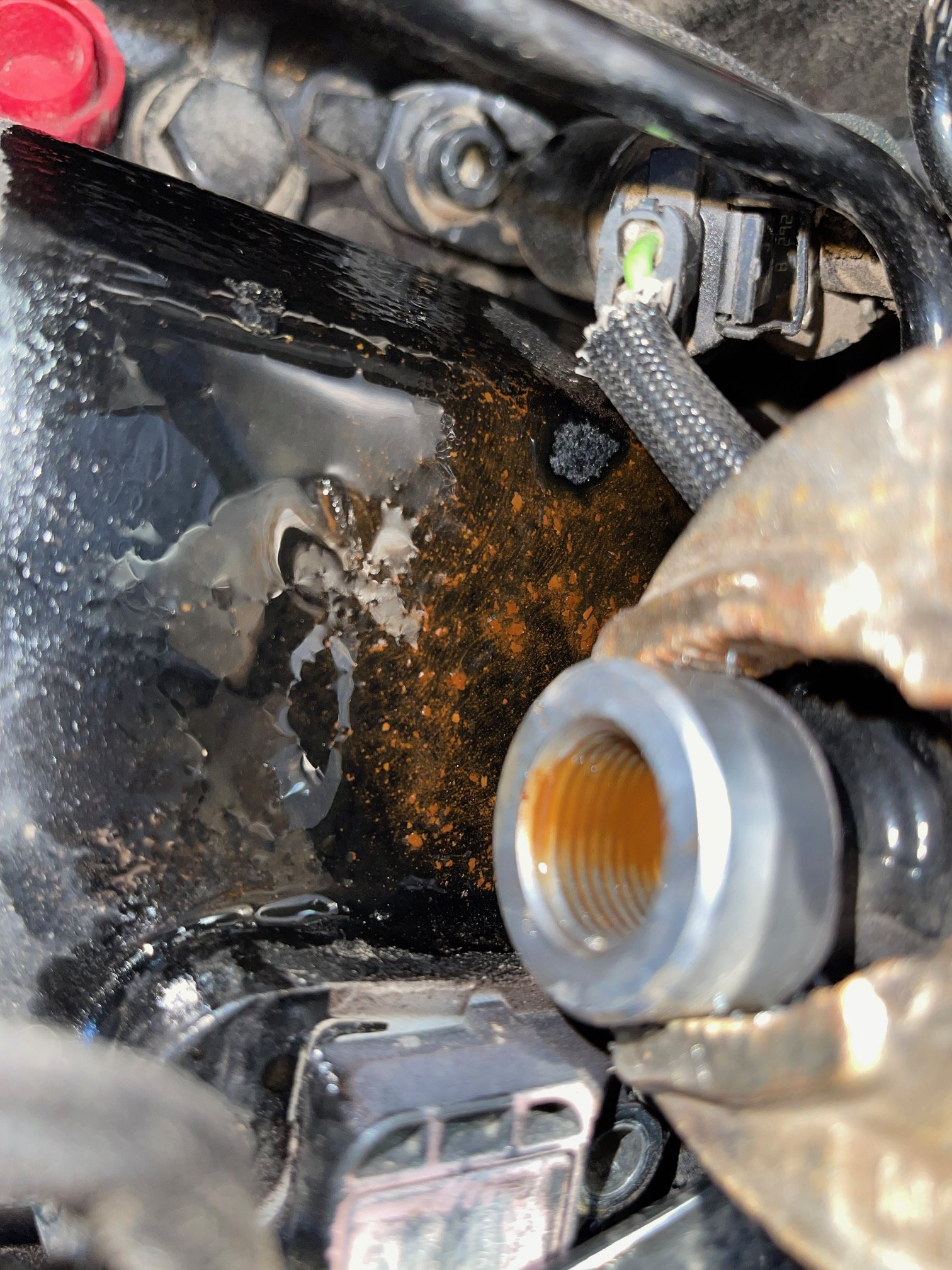

#23
This is not what i wanted to see in my common rail. Full of rusty color material. I think its is whats called THE BUG, but it appears dead and wipes off easy. But why would it be stuck in my common rail and not flushed out? I removed the complete rail and it easly cleaned up. I replaced the rail presssure sender and not much of a difference to say for sure, maybe a little improvement. Next i guess the fuel pressure over pressure valve at the other end of the common rail. Id like to change the fuel filter but mahindra no long stocks any parts and may take a month to get so ill be deleting the mahindra filter and installing a common cat filter.

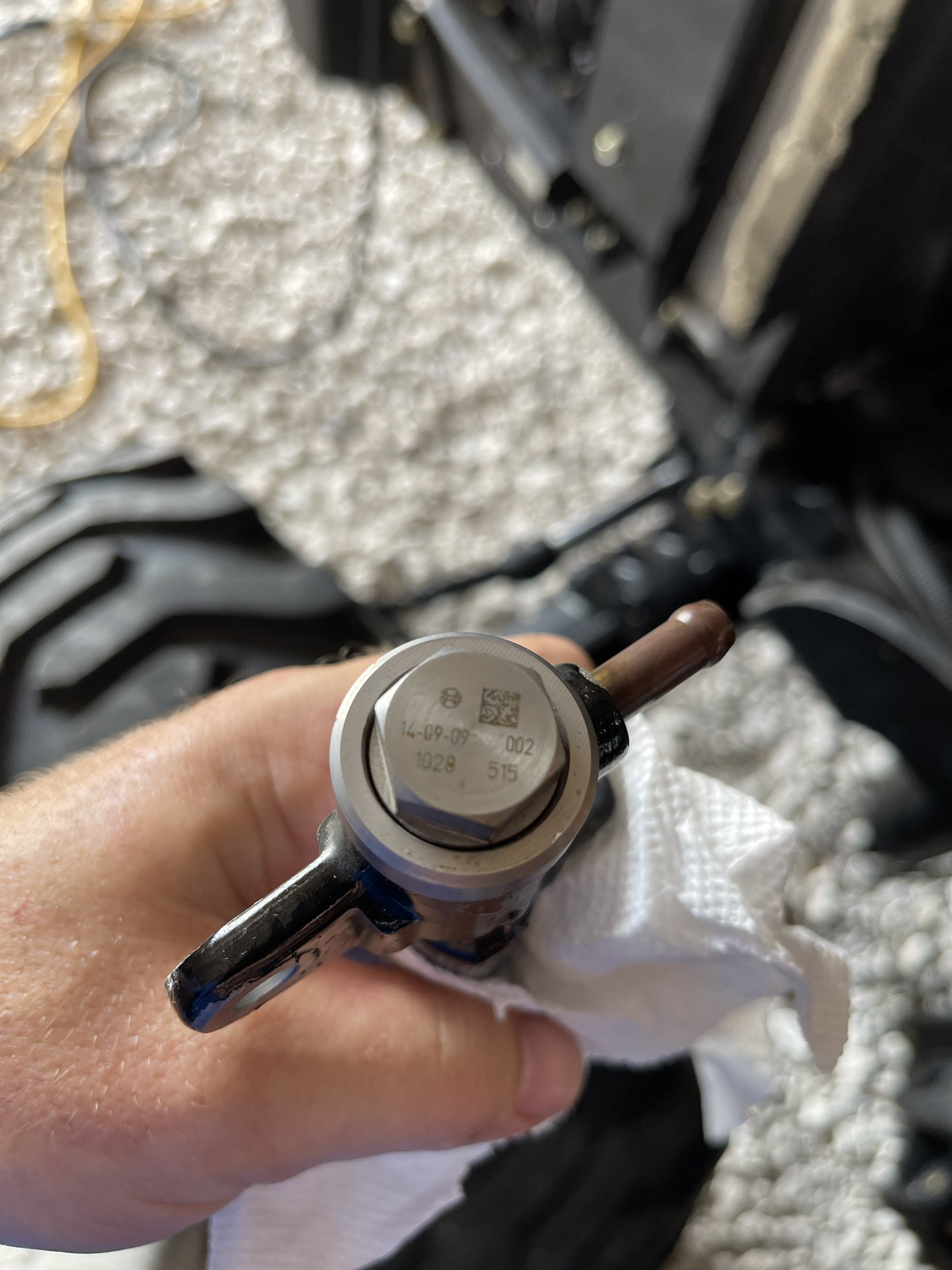

#27
My Mahindra will shut off if you plug anything into the obd port. The fuel regulator thingy at the rear of the common rail must have been bad. Replace it and all is good. Found it on eBay and was shipped from Italy.
   / 2555 Horrable engine noise. #28
Thank you!
And yes, the OBD-II scanner does shut the engine down if you try to get codes while its running. You can get get and clear codes with key on engine off. There are a lot of private codes being used and some standard ones. You can also get the sensor data. The ambient temp sensor always reads -4. They are using a non std format that the scan tools don't grok.
