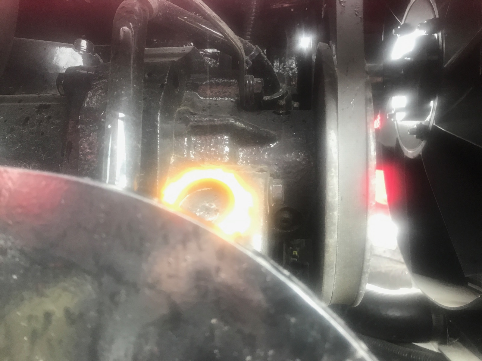

As a fellow Mahindra owner who is happy with my machine I do have one question. WTF is up with a grease fitting on the timing gear? Even my 1963 straight 6 Nova wagon used engine oil to lubricate the timing gear bearings!
Hope it's an easy fix and the parts are readily available.hope you can snap a photo of the zerk and share that with everyone on here- I'm sure other folks will want to know about that one!
/ 2555 Died & Won't Start #22
Easy one to get to its on a lot of models
/ 2555 Died & Won't Start #23
/ 2555 Died & Won't Start #25
I just found that fitting last week. Greased for the first time after 170hrs. How often do the recommend it get done?
/ 2555 Died & Won't Start #26
oh man, i have 73 hours on my 2555. glad to find out about this now. i have the manual and it does not say anything about this grease fitting. i wonder what other ones I have missed.
Mine seems to have an "outboard support" that has a fitting. Similar placement.
