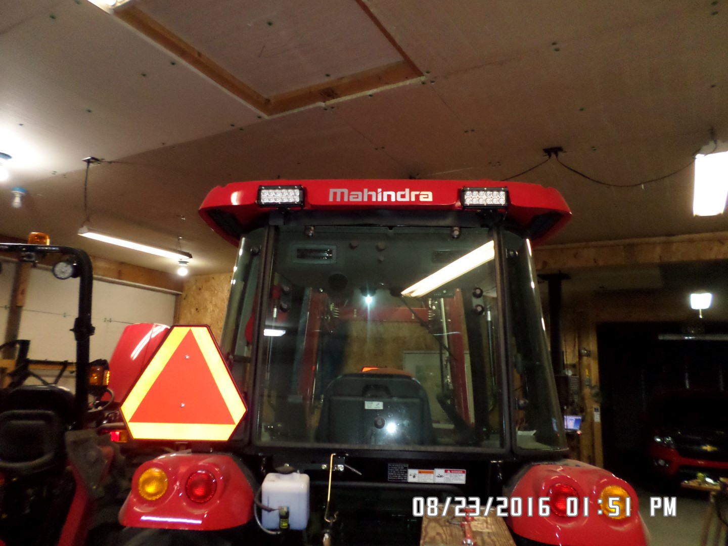

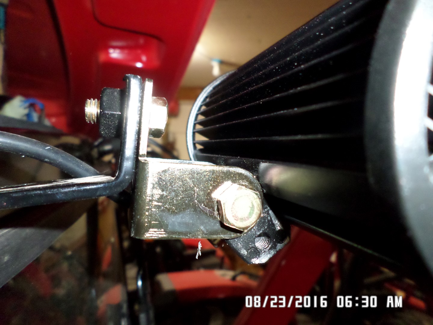

I bought four 36 watt LED floods on Ebay, they are just a little longer [wider] than the stock 35 watt halogens.
4pcs 7inch 36W CREE LED Work Light Bar Flood Offroad Lamp 4WD Boat ATV Truck SUV | eBay
The new lights are normally held onto the new brackets that came with them with 4 short stainless bolts. I bored a clearance hole all the way thru the top tap'd ones so that the stock bolt would go all the way thru them and let the new light mount exactly like the old one using the original brackets. So the new LED floods mount exactly like the stock ones did, in about the same exact position. In the second picture below, the bolt now goes thru the right set of holes all the way thru... think it was 5/16" drill that I used. You can buy higher output LED lamps, but if you stay close to the 35 watts that the stock ones draw, you won't have to worry about the stock wiring or fuse on that circuit. The 36 watt I bought fit the bill. I put 27 watts on my 5035, and they put out tons of light. Added picture of mounted lamp....

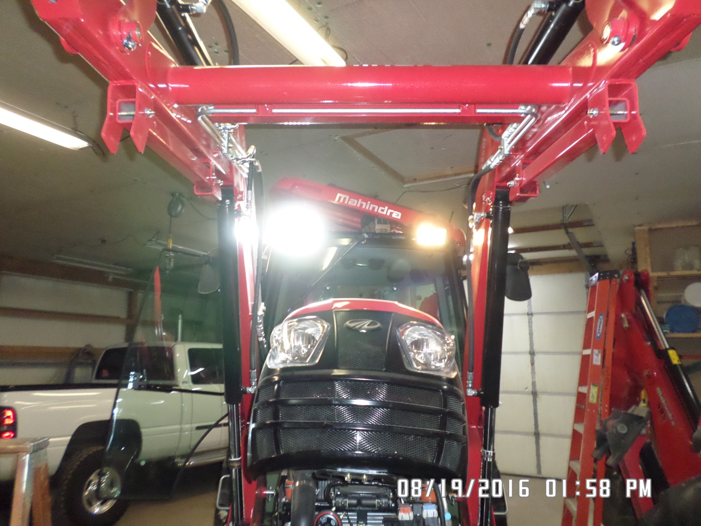

Picture of how these 36 watt lights fit into the stock Mahindra light pockets in the fiberglass cab top.. still need final alignment later. Still wiring....

Thanks! That was what I was looking for. I just measured today and the cut outs on the cab are 6" and the lights are 6.5" according to the specs but it looks like they fit fine. I was almost going to pull the trigger on the 4" ones but will reconsider now.
