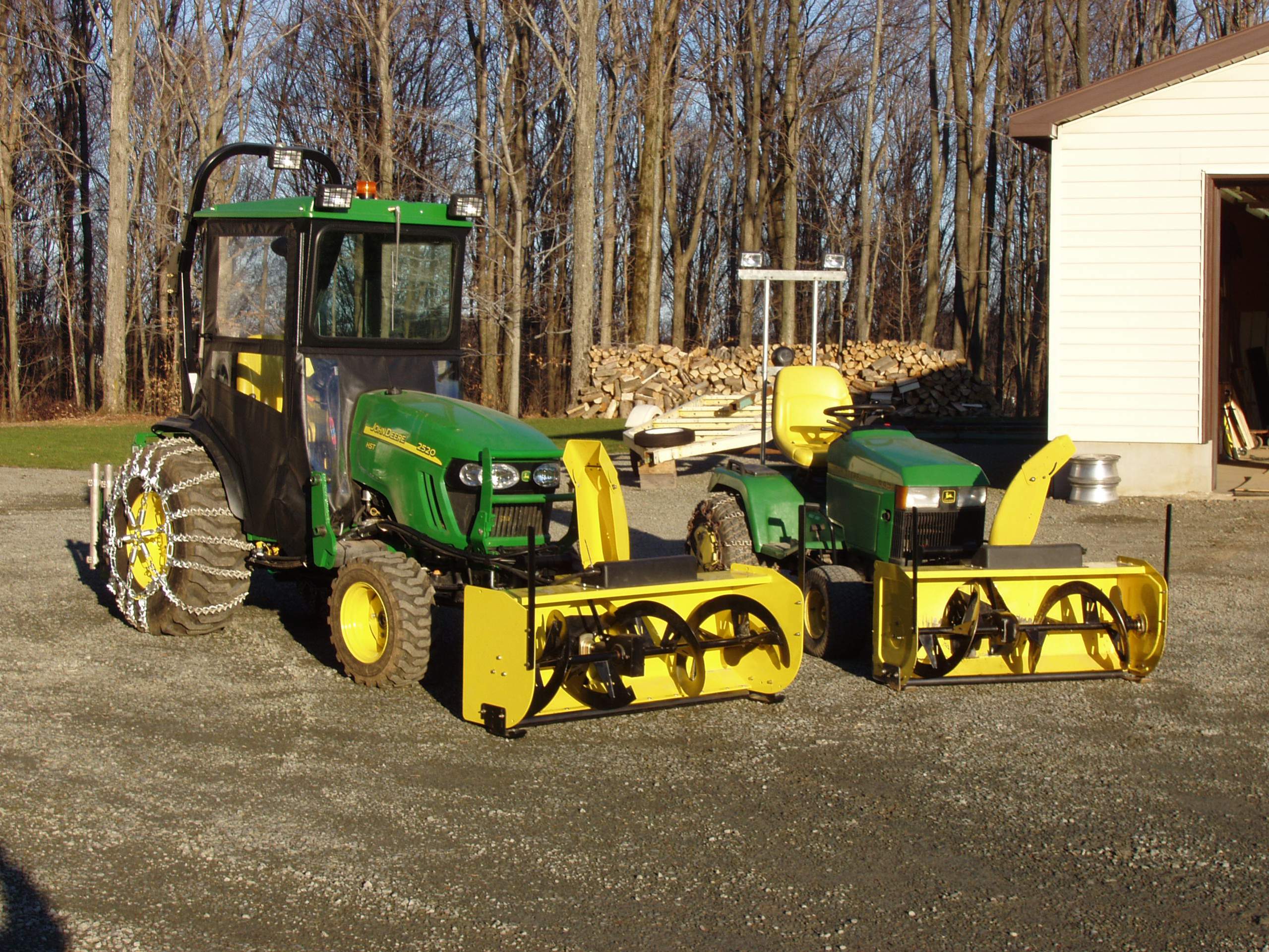

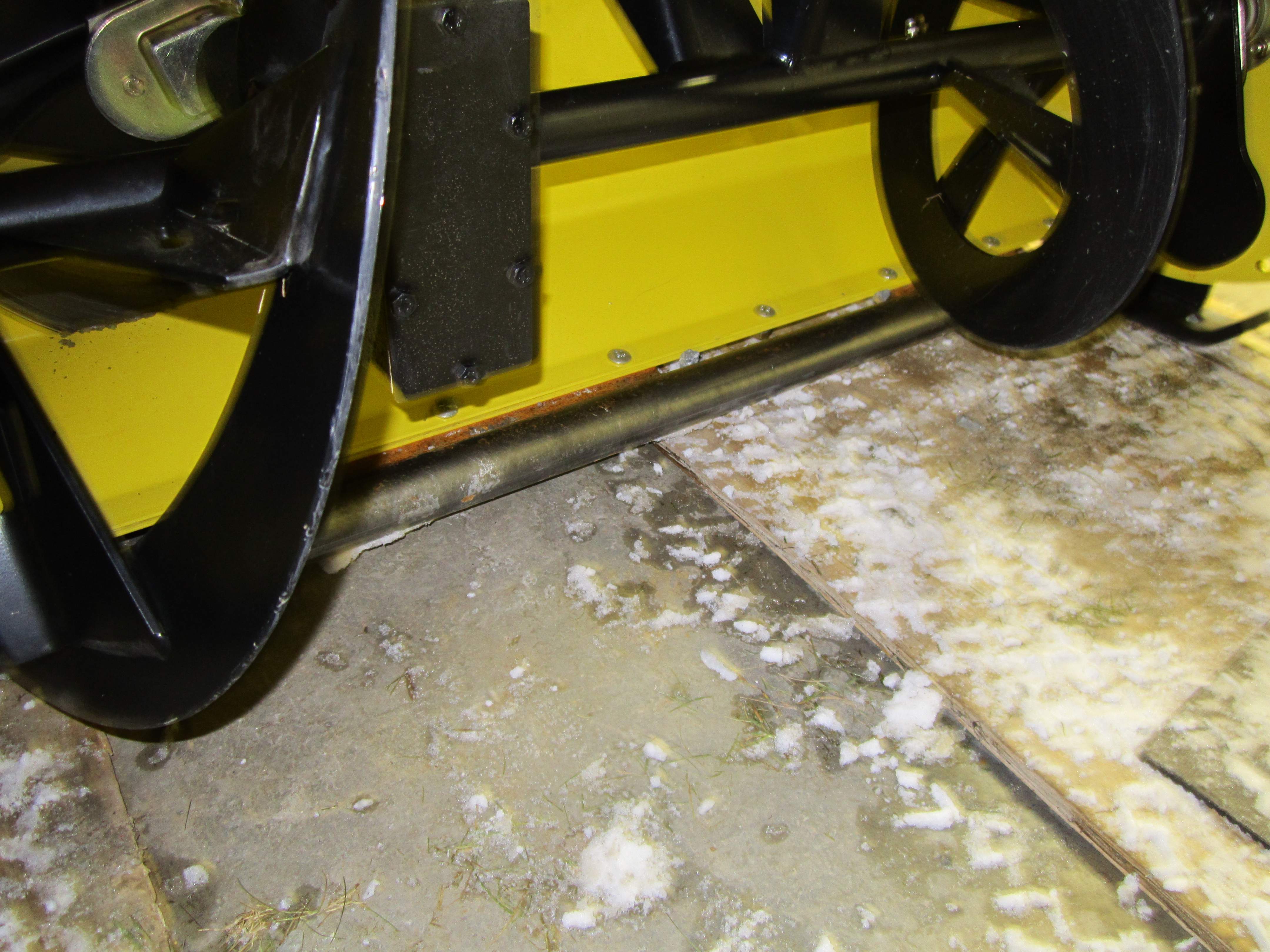

I have a 2520 with 54" blower and I replaced the cutting edge with an 1 1/4" steel pipe. I welded 3, 1/4"x 1 1/2" tabs to the pipe to bolt it to the blower using the original holes for the cutting edge. This mod has worked great for me!! It rolls right over sod and my gravel driveway and does a better cleanup up without leaving as much of a layer as before. This is the 3rd season using it and the pipe is starting to wear a flat spot. After this season I will flip it and have another few years to run it again.
/ 2520 with 54 Snow Blower #10
Nice! Too bad you couldnt have bearings on the ends of the pipe so it could rotate and maybe not wear a flat spot. Some day I hope to add a blower to my 2520. Your cab is nice as well. Is there any heat in it?
/ 2520 with 54 Snow Blower #11
I was thinking that maybe I could also weld some beads on the pipe using hard surface rod. I should be able to get 7-8 years use out of it and will probably just make another when needed. There's really not much cost or time in it.
I don't have any heat in the cab but, man does it make a difference!! I blew snow with the smaller setup for many years and most always looked like a snowman when I was done. Now I just wear thermals/jeans/coat and am very comfortable. I do have a small fan setup to blow across the windshield to keep it from fogging up.
