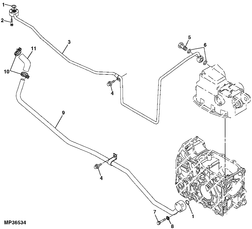

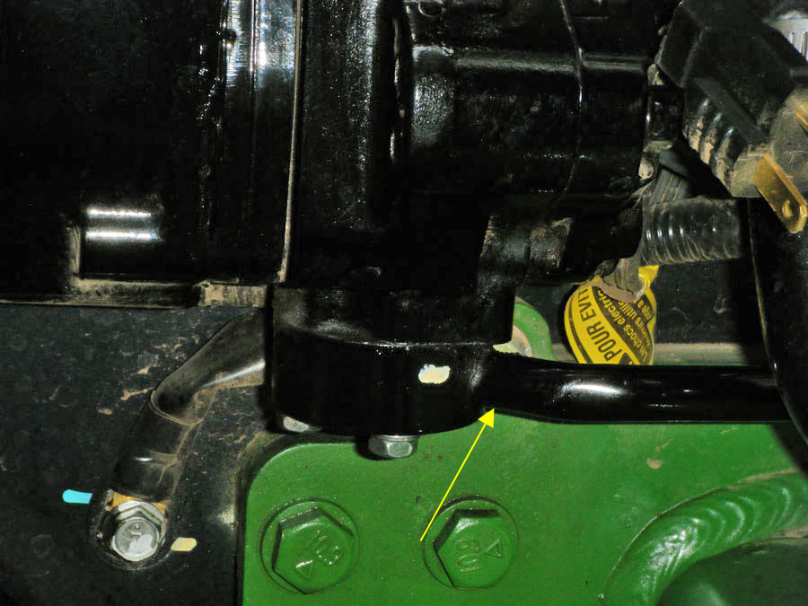

That was the same exact line that blew out on mine with 25-30 hours on it, but mine blew out under the seat. Looks like they might have a problem with this line..... The mechanic showed me where it went and it bolted in the same exact place yours does! The dealer came and picked mine up and repaired it and brought it back.....
Yup!! My leak was also under the seat. It appears that the tubing is made from flat sheet steel that is rolled and electronically welded. I noticed from the pic posted here that the leak was in the bend, (not the welded fitting) as was mine. When I ordered the part through my dealer ,he said JD had three in stock. Two weeks later I called him back and he said it was back ordered because they sold out before my order was filled. This tells me that JD is having to replace lots of these pipes in the 2520s and 2720s Good luck with your tractor , and I hope it won't happen again. Lets hope they are using a different lot number.
   / 2520 tractor hydraulic leak #23
Just had exactly the same problem with my 2520. The LVA802447 hydraulic line split near the end under the seat and was spraying oil out like a fountain when under load. Tried to replace it myself but found it was impossible to get the line out without major disassembly. Finally got the dealer to come and get it. Machine is 5 years old so is out of warranty but only has 250 hours on it. Dealer did not want to hear anything about a possible manufacturing defect. They said they check for transmission vibration anytime a hydraulic line bursts. I'm sure labor cost will be high. LVA802447 alone is about $325 not to mention pick-up and delivery so this won't be a cheap repair. Hoping to get it back in a week or so. I'll post the final outcome.

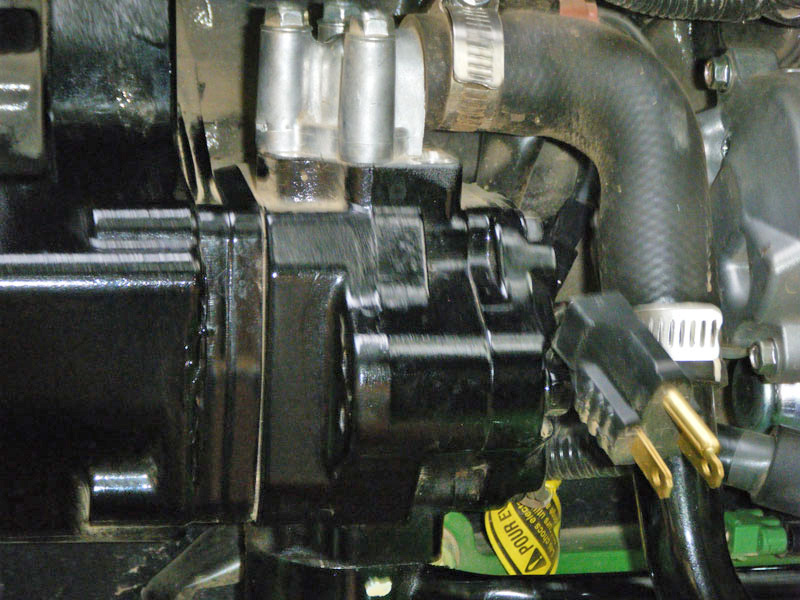

KBOTA1 I bought a 2011, 2520 and had a hrdro line issue at about a week old. My problem was very close to the hrdro pump.
http://www.tractorbynet.com/forums/...-2520-tractor-hydraulic-leak.html#post2433814
Wasn't to happy having to get my 2520 hauled back to the dealer, but it was fixed no charge. The dealer apologized for the problem, and no issues since.
