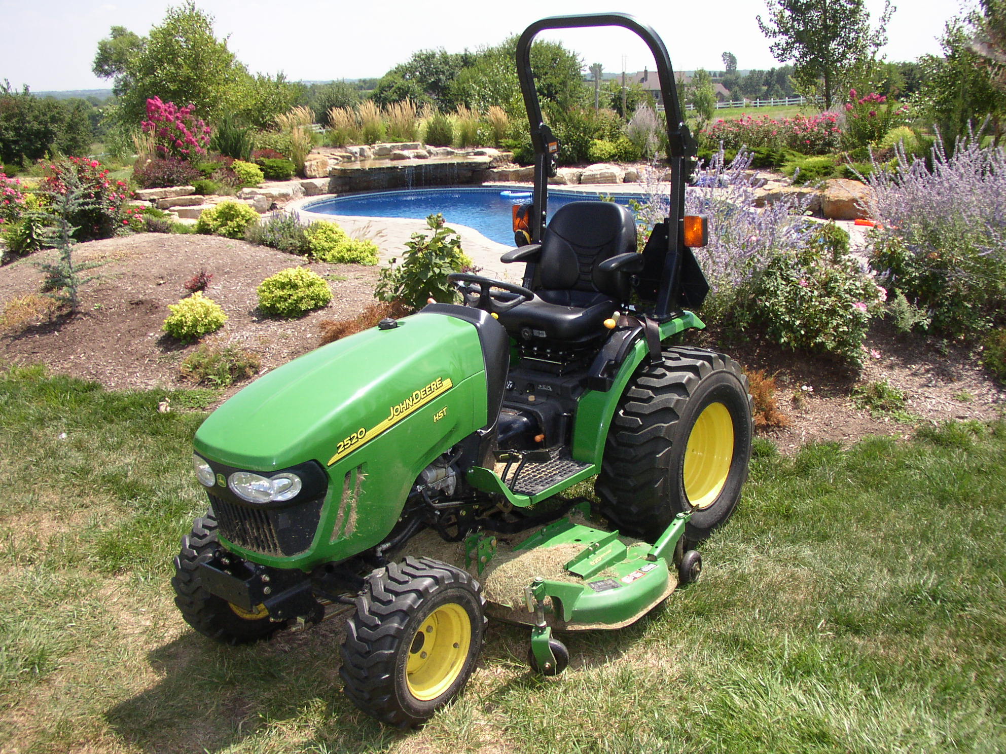

Ok, I have some springs under the rear of my seat on my JD2520, but its still a bit rough. Its much better than it was, and thanks to this board I did the springs mod.
Has anyone successfully installed a suspension system on their seat?
I have disks screwed-up in my lower back, and I just don't want to keep beating it up with this rough ride. Its perfectly normal, but my back issues just make me look for a much better ride.
Anyone have pic, or write-up?
Thanks in advance!

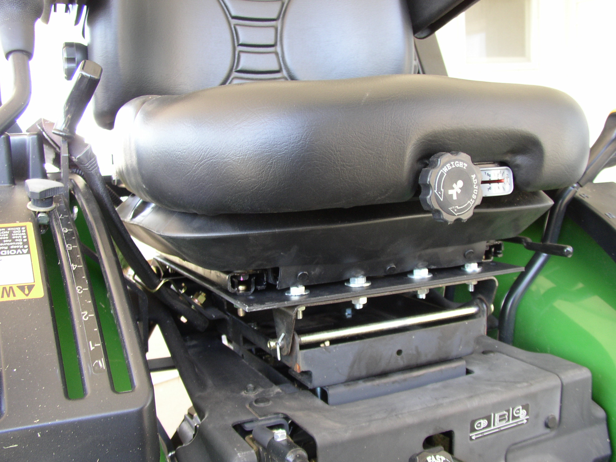

Hi All,
I recently purchased the Michigan seat in the link above for my JD2520. Fabricating an adapter plate was required for it to fit, but it was WELL worth the effort.
I am VERY impressed with this seat from a quality and adjustability standpoint. It is very heavy, close to 33 lbs but it is like sitting in a lazy boy while mowing (OK maybe not that nice) but a HUGE improvement over the factory. It has adjustments for lumber, backrest tilt and weight dial and the arms fold up if necessary.
I tried to take as many pictures of the procedure here. If you have any questions feel free to ask. I will try to get a PDF of a dwg for anyone who needs it.
This is my first post and I just realized embedding pictures is not as easy as I had hoped. I had planned to post step by step photos of making the plate and the installation. Here are just a couple pics....PM me and I can email you many pics or a Word document that outlines the steps for this.
At any rate I am very pleased with the seat, how it fits and how comfortable it is. The original height VS the new height are very close and the access to all the controls are equally good. With the plate I made fore and aft positioning of the seat are real good too. Another nice thing is you retain the factory seat belt mounts and the seat comes with a seat switch built in.
I hope this helps anyone deciding on upgrading to a new seat.

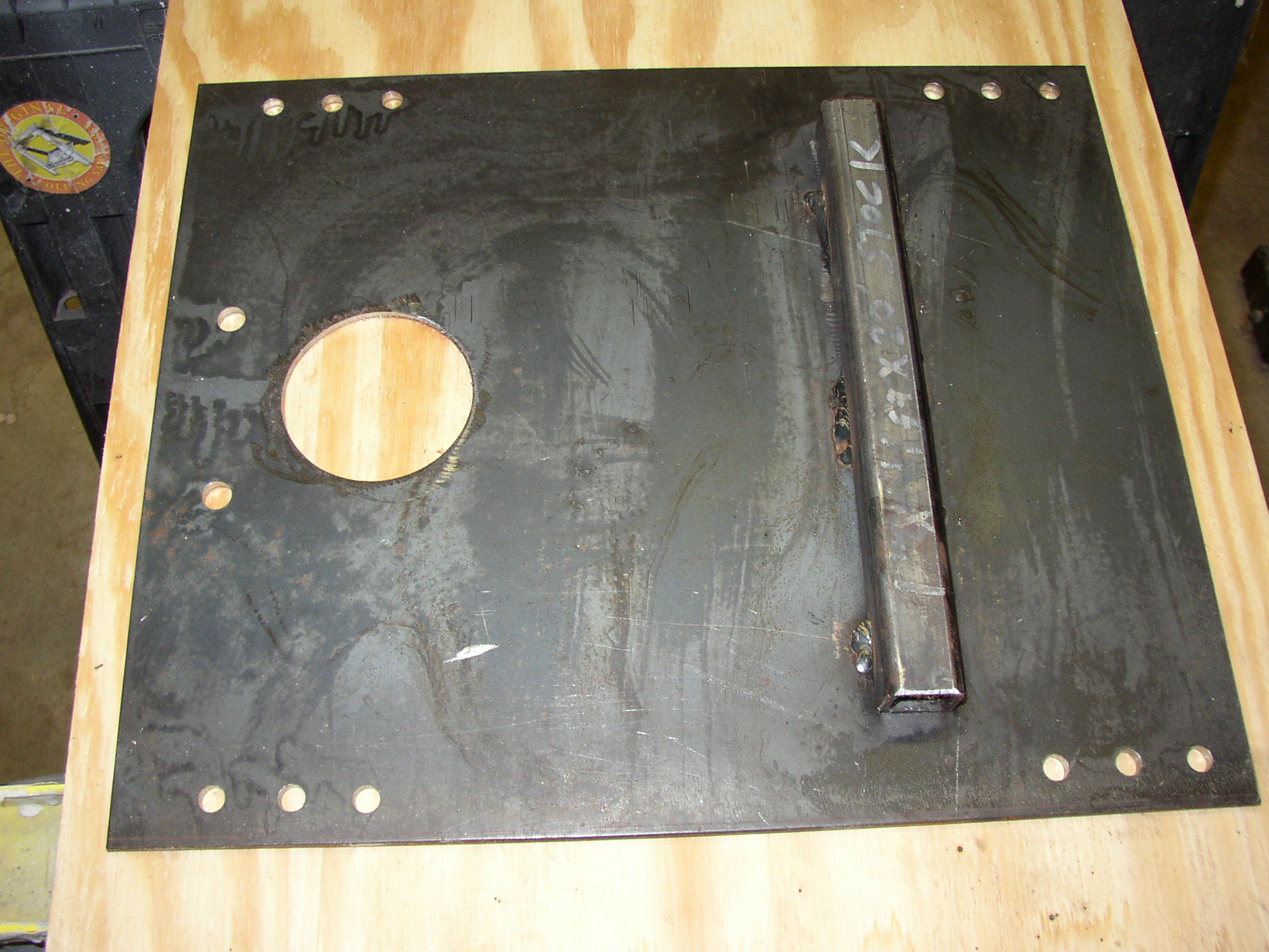

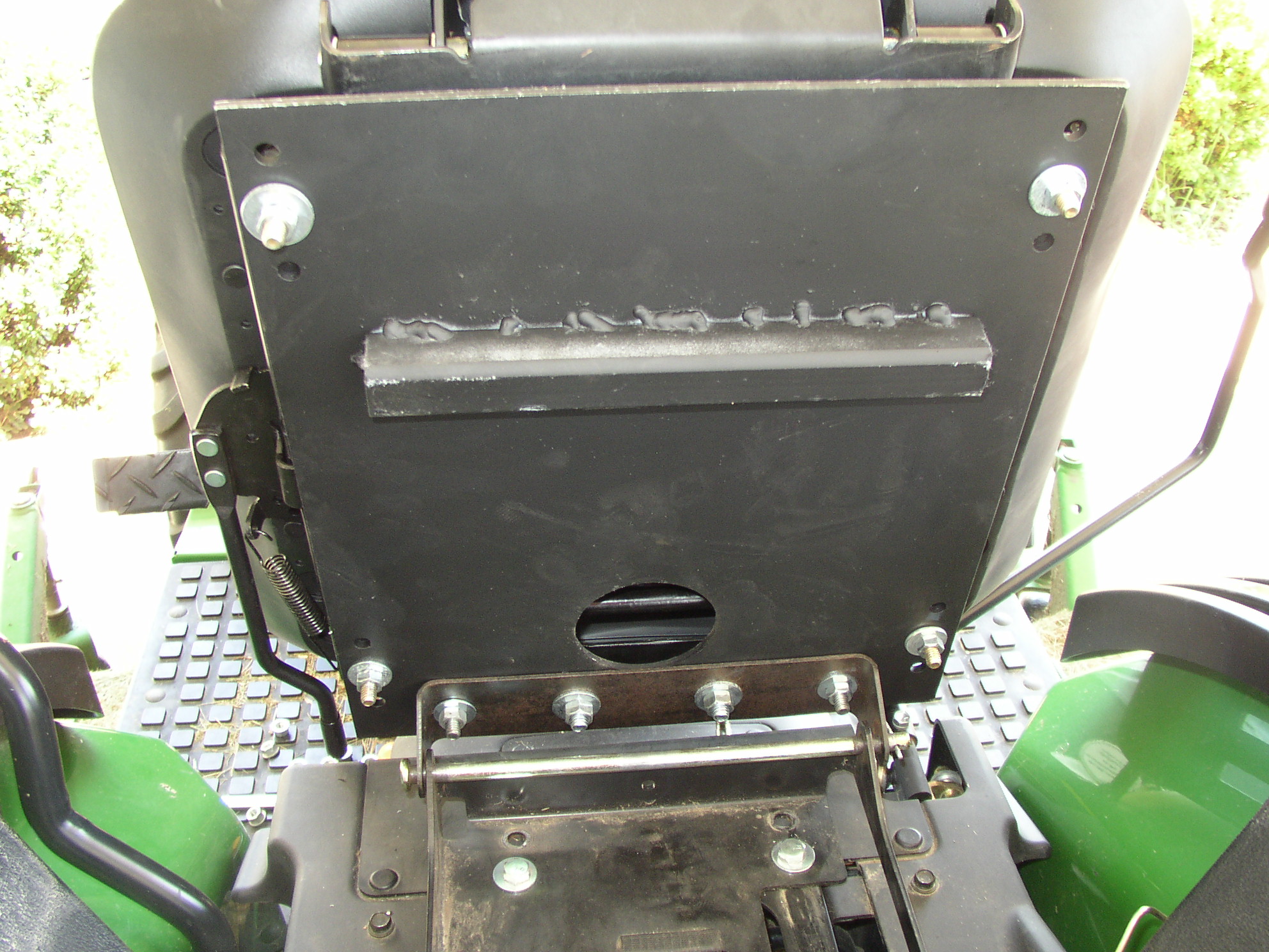

Just posting a couple more pics. The large hole in the center is to run the seat switch cable up through. I also drilled three holes at each corner of the plate to give me a little more flexibility in locating the seat fore and aft once I placed it on the tractor. I found the center holes worked best for me.

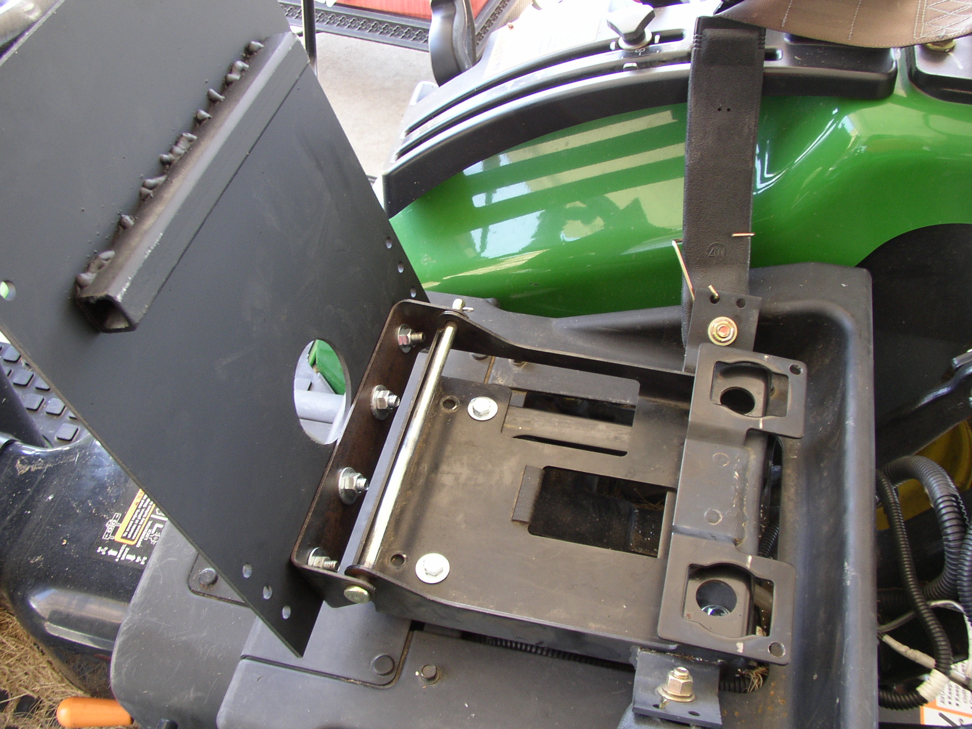

The original slide for the stock setup was removed, however the new seat has a slide which bolts to the plate I made. The three holes were simply to give me a little more latitude on the initial placement of the seat. I did not want to get it all installed, run out of travel and wish I had moved the seat forward or back just an inch.
Essentially the steps involved in this mod are:
1. Remove original seat
2. Remove the upper bracket that the seat belts bolt to. (This bracket bolts to the top of the seat slides.
3. Remove the seat slides.
4. Mount the original upper bracket where the slides were previously mounted. This requires drilling two additional holes.
5. Make the new seat plate.
6. Bolt the bracket from the original seat to the new plate. This is the bracket that the seat pivots on to tip forward. Attach the new plate and seat bracket to the upper bracket from step 4.
7. At the point you have a nice flat platform that pivots forward and this is what you attach the new seat to. The new seat has slides, so it is adjustable forward and backward.

Would you be able to measure the size of the piece of plate steel you used, and how thick was yours?
Is that square tubing just to make the seat sit level? If so, does yours sit level, or should I raise or lower mine from what you did? I assume thats 1 inch square tube?
Can you still tip the seat up, or did you bolt it down solid?
Thanks so much for the info. This is priceless! :cool:

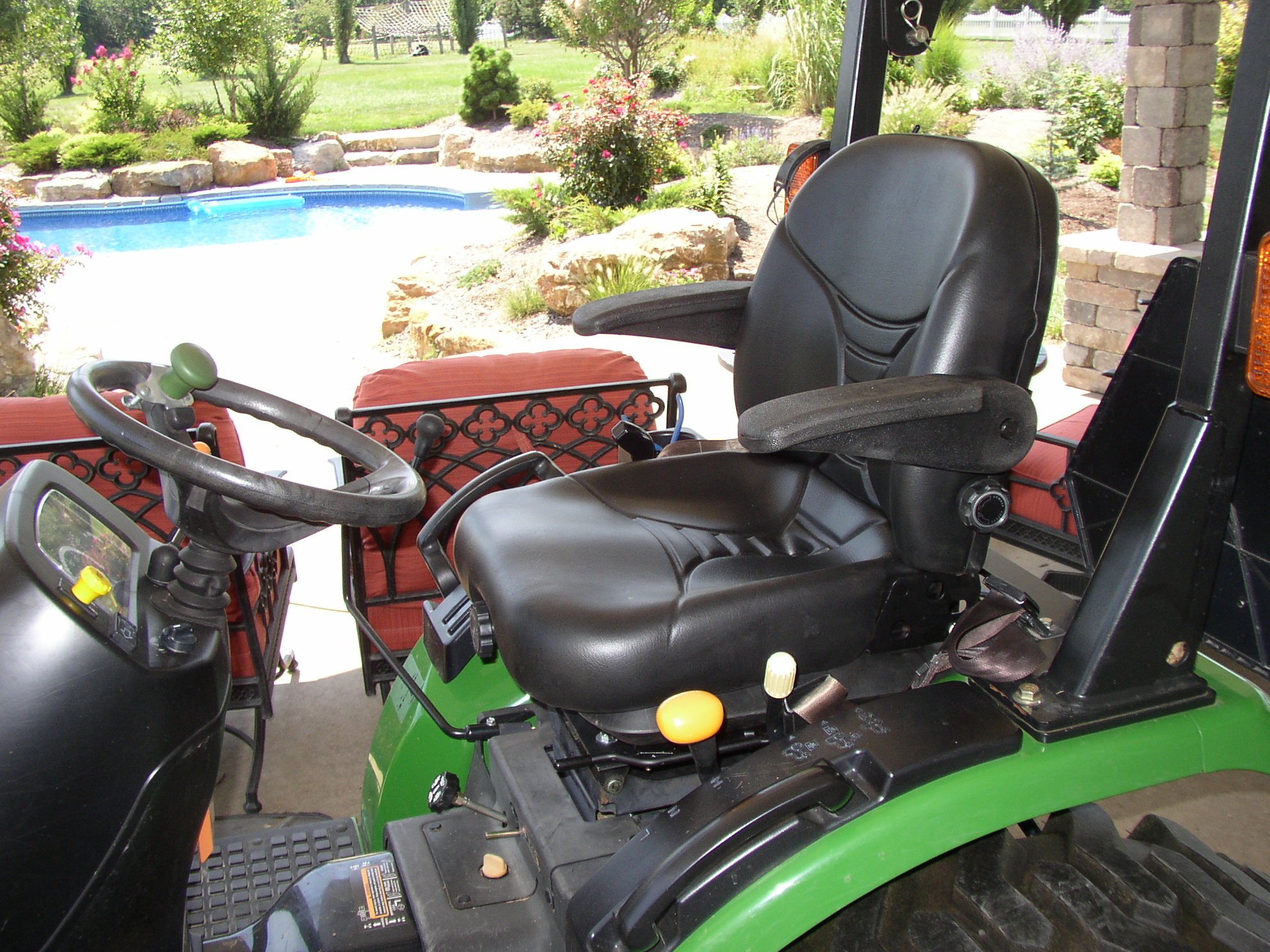

I am attaching a DOC file that has the dimensions. THis was exported from Autocad in WMF format. I also have this in Autocad if anyone could use that format it would make things easier for you. Just email me and I can send it to you.
After my modifications the seat will still tilt forward, the seat switch functions. The 1" tube is simply to set the rear height of the seat, you could change this if you wanted a different rake to the seat. Mine sits pretty level with a slght rake down towards the back and I have found it very comfortable. I am close to 6'1" and 200 lbs. I have attached a picture to give you a better idea of how it sits.

What did you use to cut that 3" diameter hole?
/ 2520 suspension seat????? #17
I used a hole saw commonly available at Lowes or Home Depot, just be sure to get a Bi-Metal or Carbide one, not high speed steel.
I drilled all the holes using a drill press, but a good quality hand drill would work fine too.

I don't have my tractor to look at right now....Is that large 3 inch hole needed for anything other than the seat safety switch? I don't have mine on now, so I could eliminate finding a big hole saw maybe.
Looks great BTW!
/ 2520 suspension seat????? #19
The only thing the 3" hole is used for is to route your seat switch cable up through to the underside of the new seat.
Looking back this opening could have been a little larger to allow more room to reach up through the seat to connect the cable.
If you leave the seat switch disconnected, you will need to place a jumper between the two terminals on the cable to by pass the safety shut off.
I don't advocate bypassing safety features, but I do know this is one of the common ones that do get bypassed.
