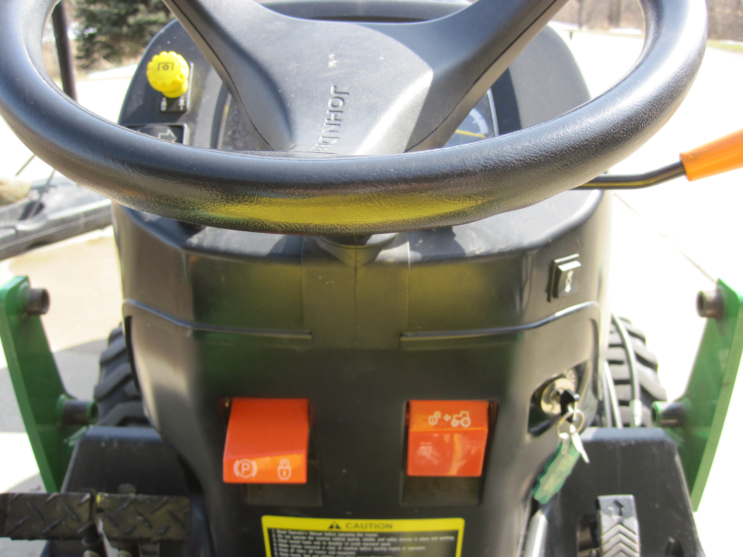

I need to mount a rocker switch in the dash of my 2520, it will be used to control an actuator that I mounting to my snowblower for chute deflector control. I would like to install it in the dash next to the throttle to the right of the gauges or just below it. Has anyone installed any switch or something other in their dash? Or has anyone had thier dash apart or the fuel tank out to get under the dash?

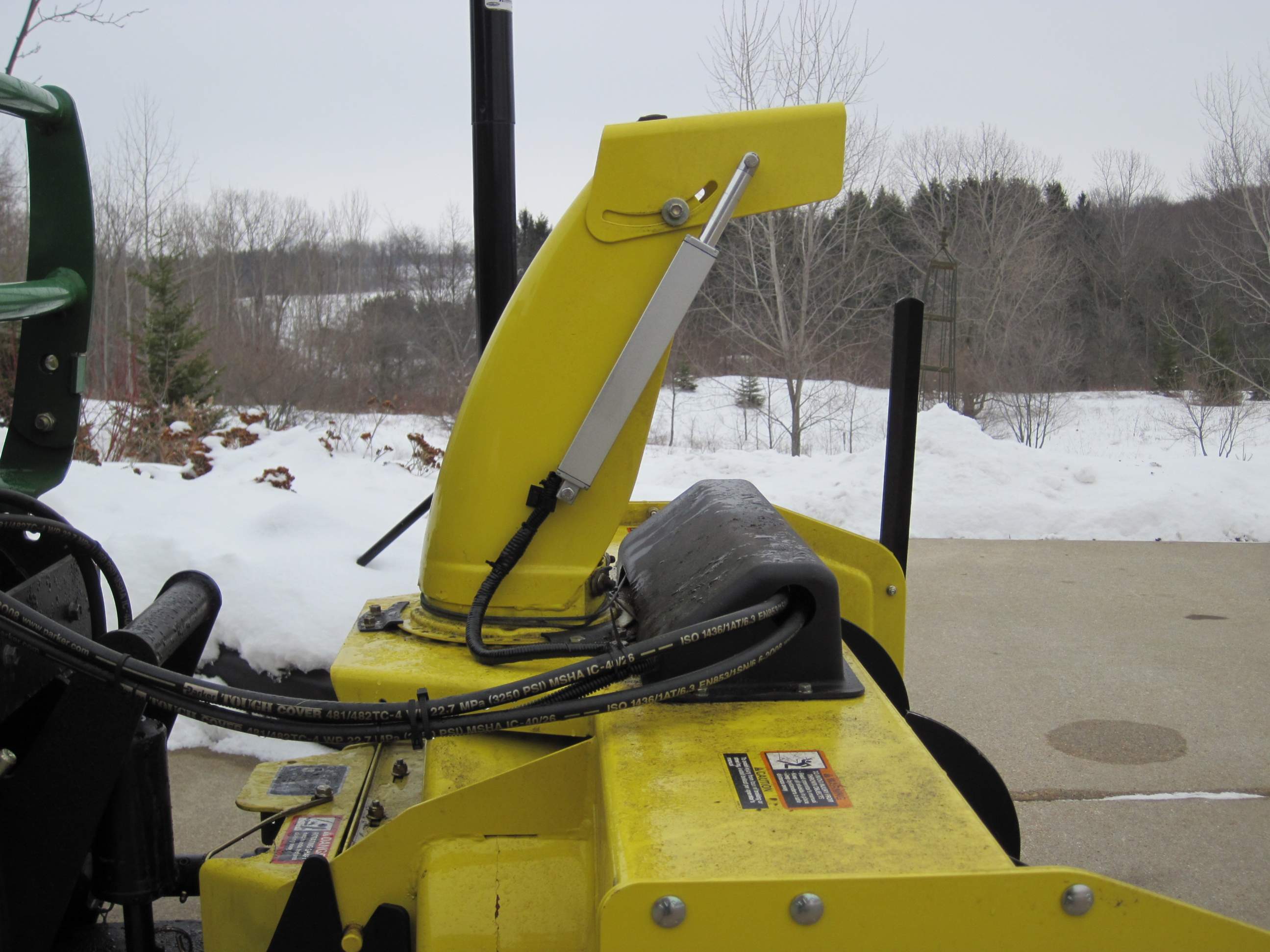

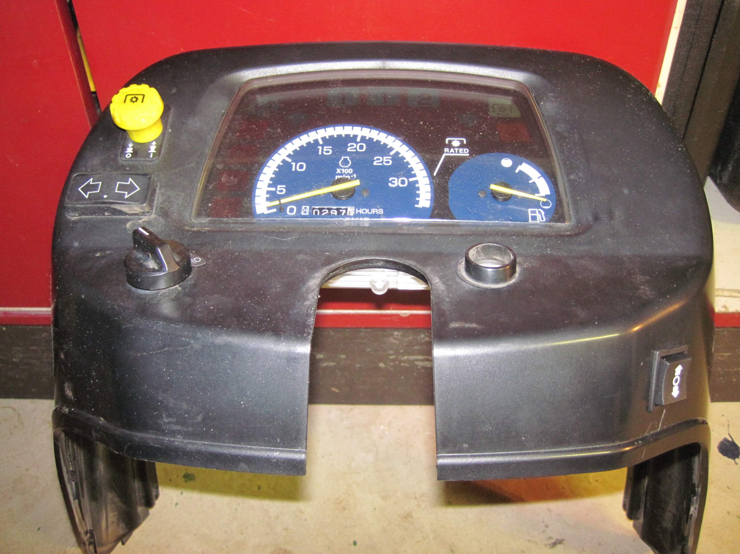

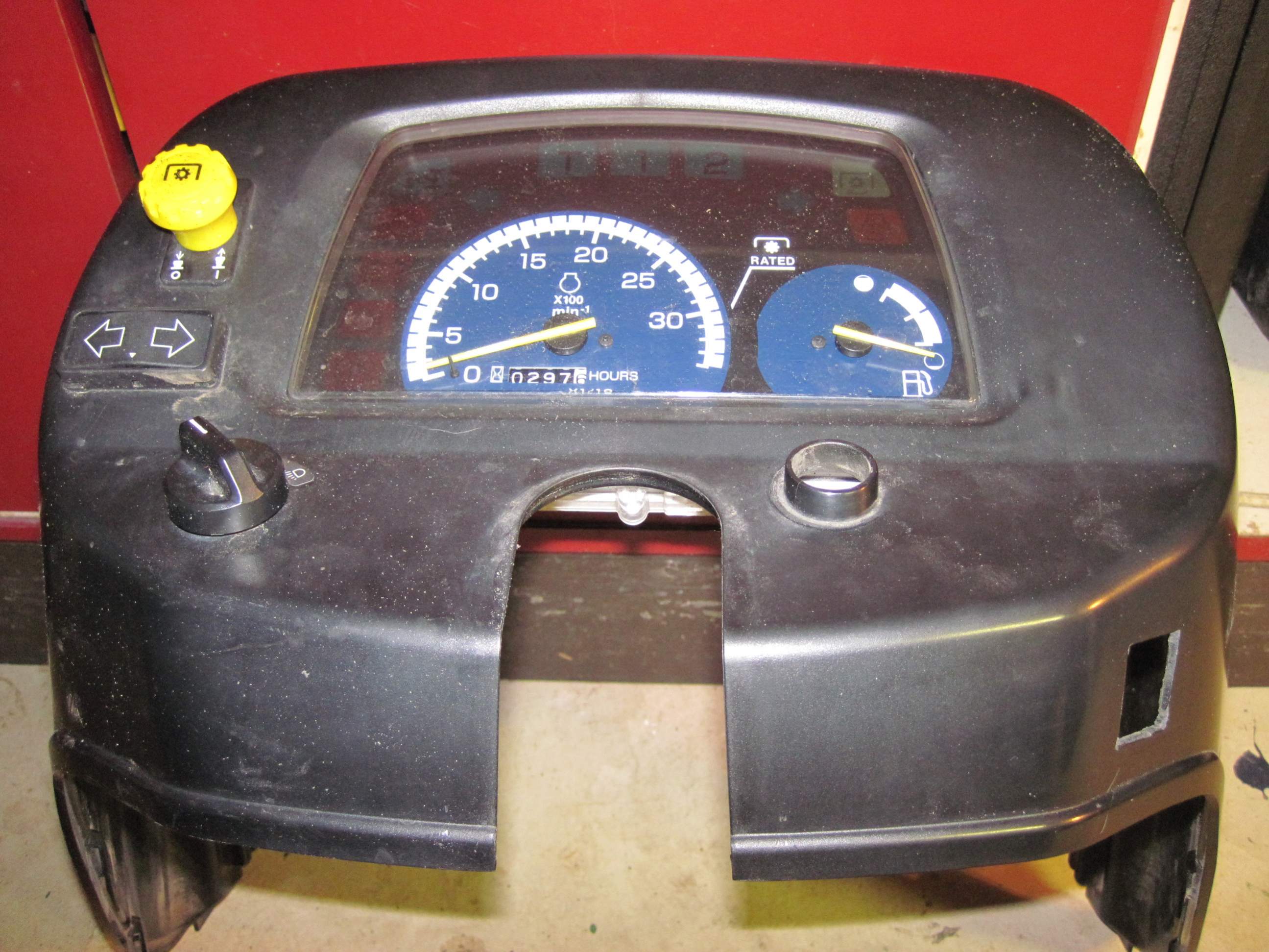

Deere 2520,
It appears as if you are tackling the project I did last winter on my 2320. As advised by the other posters...the process is pretty simple to remove the dash. I used a hot knife to cut the hole in my dash. Below are some pics of my dash and finished product.

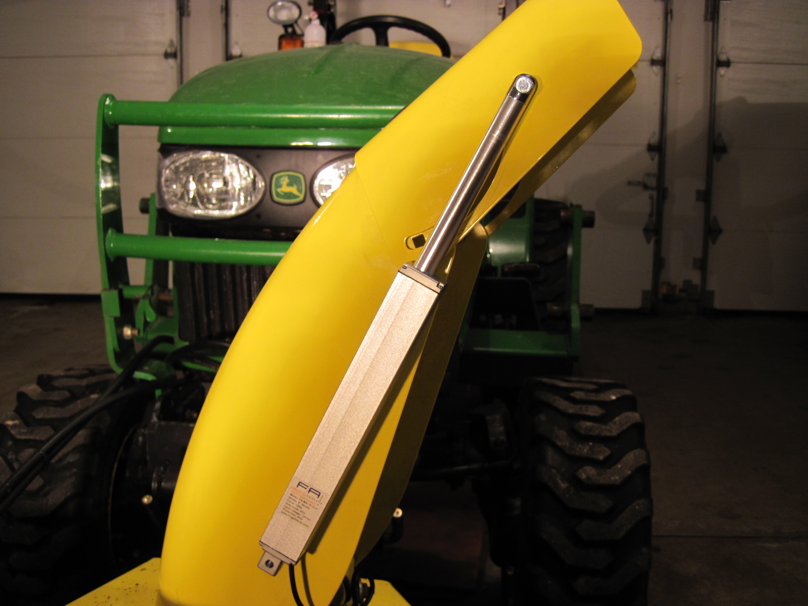

oh...i found some time and here is a quickie of my BOM and pic of materials
a. Liner Actuator (15 lbs, 12v, 4 Stroke)
Source Firgelli Automations (Linear Actuators, Linear Motors, Micro motors, Electric Motors)
PN - FA-MS-15-12-4
Cost - $75.00
b. Momentary Contact Rocker Switch
PN - MAN-RS2
Cost - $18.00
c. 16 Gage Wire (2 colors for a someone like me to keep straight)
d. 16 Gage Heat Shrink Butt Connectors and Quick Disconnectors
e. In Line 12v Fuse Holder
f. 2 Wire Flat 12v Connector
g. Hardware
2 Stainless Steel Hex Head Bolts シ x 1 ス
4 Stainless Steel Nylock シ Nuts
h. Flex Tubing and Kwik Clips
