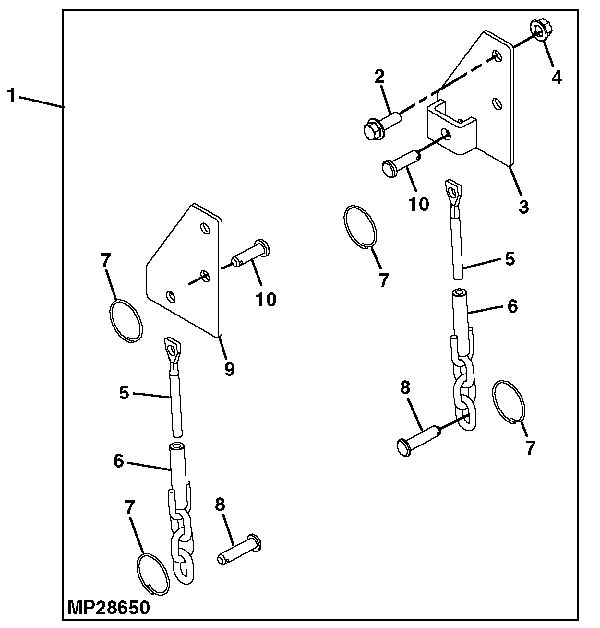

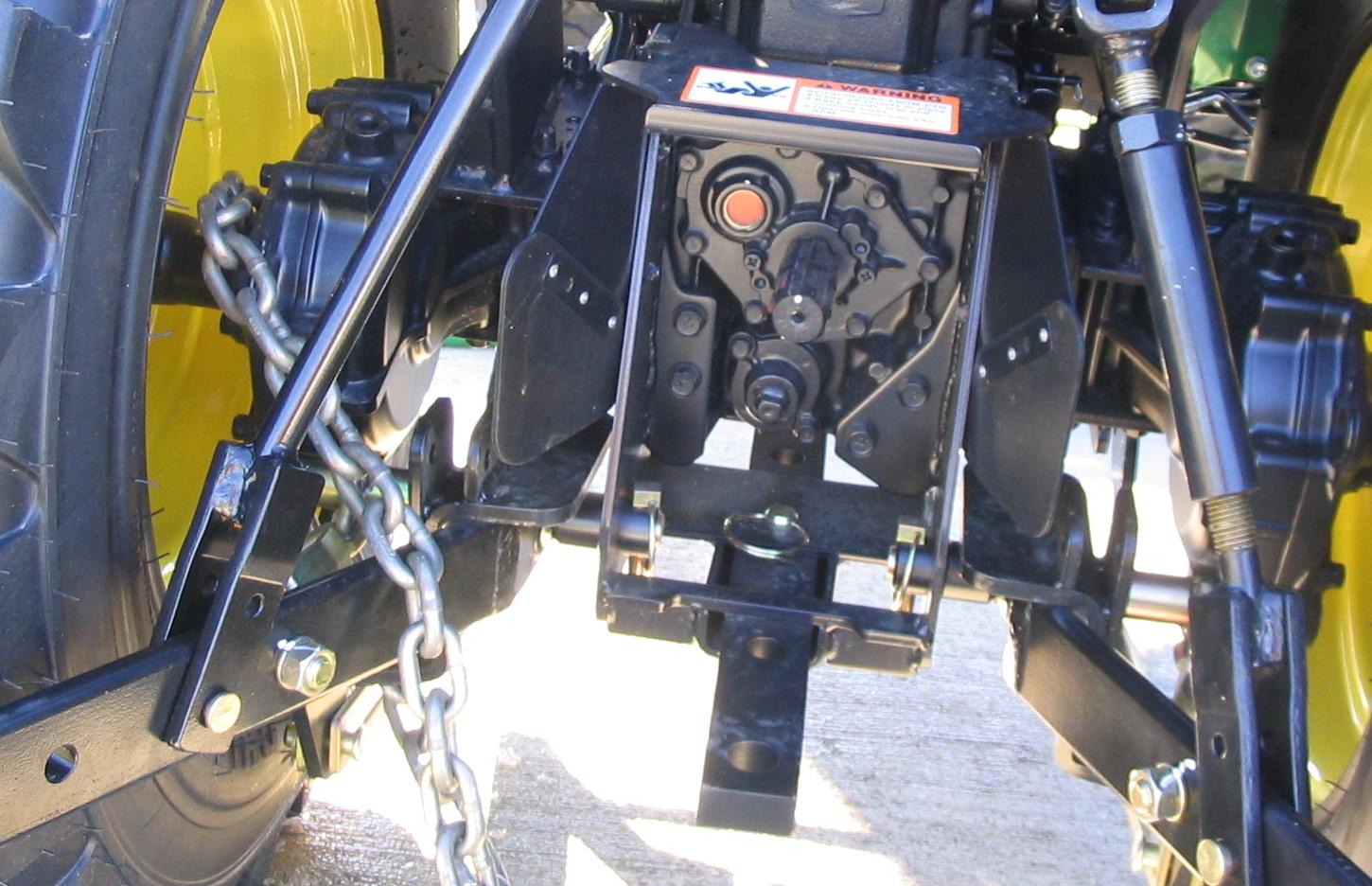

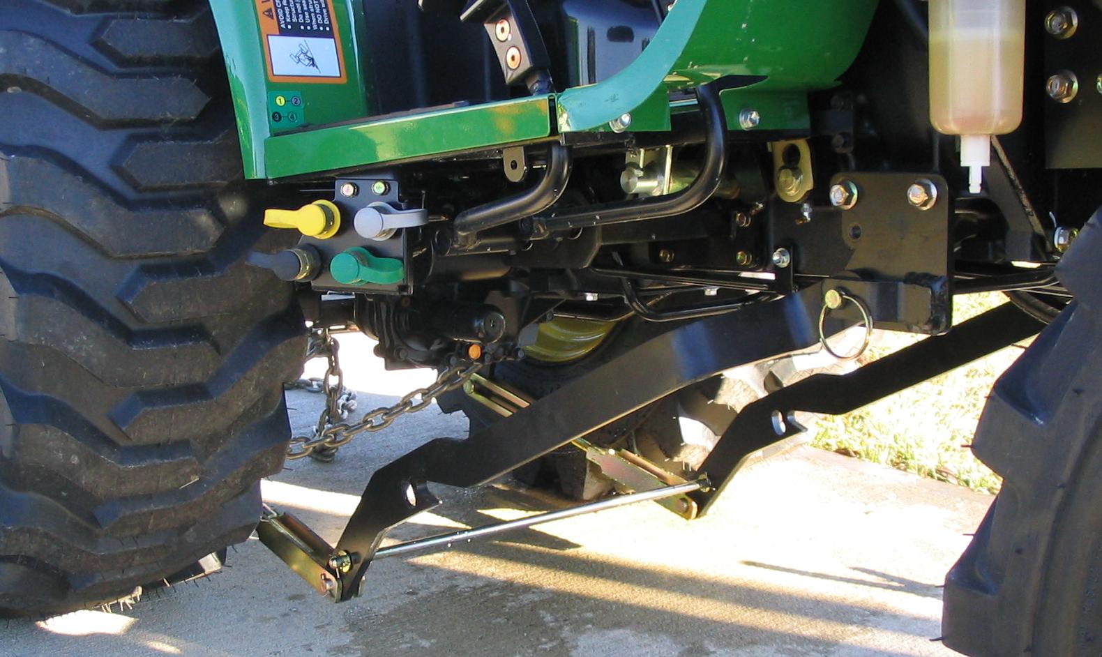

After I posted that, I remembered that I had taken some detail shots of that linkage on a unit sitting on a dealer's lot, waaaaay back before I bought mine.
These pics show it pretty good. Now I see that the rear attachment point is just a flange type thing that is hung on the draft arm pin. So it looks like it would be super-easy to remove when installing the backhoe. In fact, that has to come loose anyway to get the draft arms off in order to attach the backhoe.
Regarding holding the arms up, JD now is listing a lockup kit in the parts catalog, but I can't tell where that attaches to the linkage at. See attached pic.

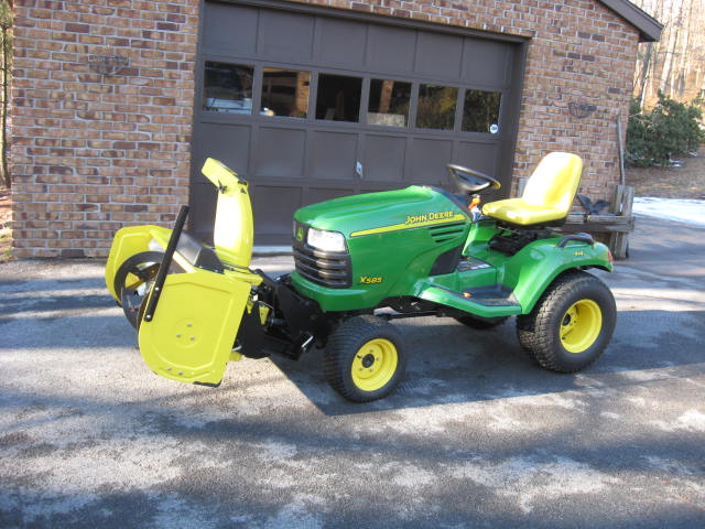

Then if I'm reading this right I should be able to change over from backhoe to mower in 15 mins or so? And back to the backhoe in another 15? I think I'll stick to the standard mower lift, I don't see much advantage with the optional lift or am I missing something..
The tractor will be used mostly to mow about 3 acres of lawn. The hoe and loader are for misc. chores I have around here. Thats why I think the turf tires would be best for me JD. I'm pretty fussy with my lawn.
Been mowing it with my X585 the past 2 years which does a great job. I was going to trade the X585 but I just might keep that and get the 2520 with just the loader and hoe if its going to be a pain changing over.
