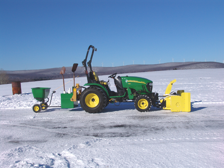

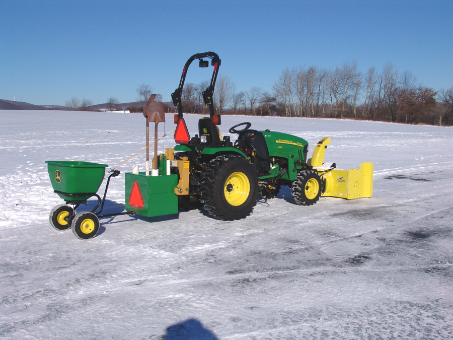

Attempting to attach pics of my winter setup, hope it works. Spreader is only hooked-up after clearing to keep ice off long hilly drive.
Thanks again for all of the useful info.

Welcome to the board. Looks like she'll get the job done just fine.

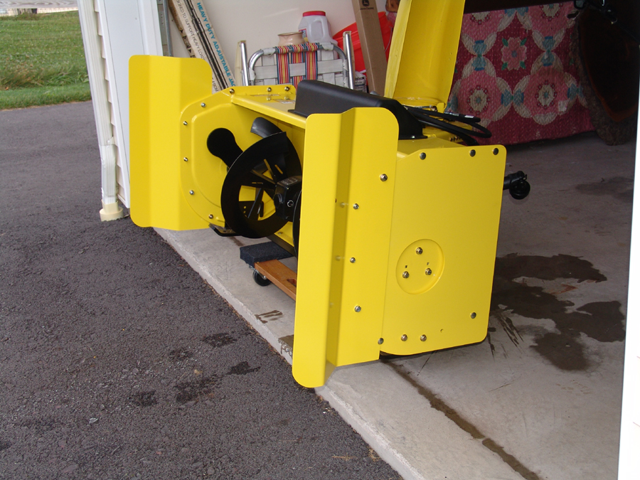

I like the blower wings. Could you post a close up of them and the attachment method?

A closer shot of the wings is attached. Mounted with bolts using existing holes in blower, with a couple added.

Nice work. Those look like they came from the factory.

/ 2520 Just keeps getting longer #7
How long is that entire set-up?
/ 2520 Just keeps getting longer #9
Wow! Nice job. How do you keep looking so clean?

Nuru - Just went to the garage and measured the set-up as pictured at 216" - that's 18 feet.
I'll have to figure out how to do the profile thing. Anyway, we're in north east Pennsylvania near Waymart, Honesdale, Hamlin, etc. The windmills are part of the Waymart Wind Farm, of which 20, or so, are visible from here. The ones in the picture are about 2 1/2 miles away.

Beautiful machine and beautiful country. Is the ridge that the windmills are located a natural ridge or a manmade one? It's gorgeous either way. I also like the idea of pulling the spreader behind the ballast box. It will help keep the corrosive salt from being thrown on the tractor.

Tom - The wing opening is 54 inches. I got two pieces of 11 ga. steel (approx 1/8"). I don't know the grade, but it is quite rigid. I figured that was the max for bending, so worth a try.
Sunday's nor'easter gave it a good test. Don't have any idea how much snow we got - 850' double wide drive had anywhere from a couple of inches to over two feet when the wind got done. We had no local TV (no football) Sunday because all the antennas blew down - for real.
Blower and wings did a great job. Those hard packed drifts gave the motor all it could handle, if I took a full bite. The only problem was, on a smaller bite, with ice underneath, the wings would pull the tractor into the drift - loss of steering. Had to back-up and straighten out a few times. There is another interesting thread going about getting rid of rear ballast to reclaim steering. Wings did not get damaged or bent at all. All in all, I'm pleased. Probably will change the relief curve (bigger radius) on the bottom fronts in the spring.
I picked-up the blower this fall, assembled it, installed it and made the wings. I never used it without the wings so I have no comparison.
