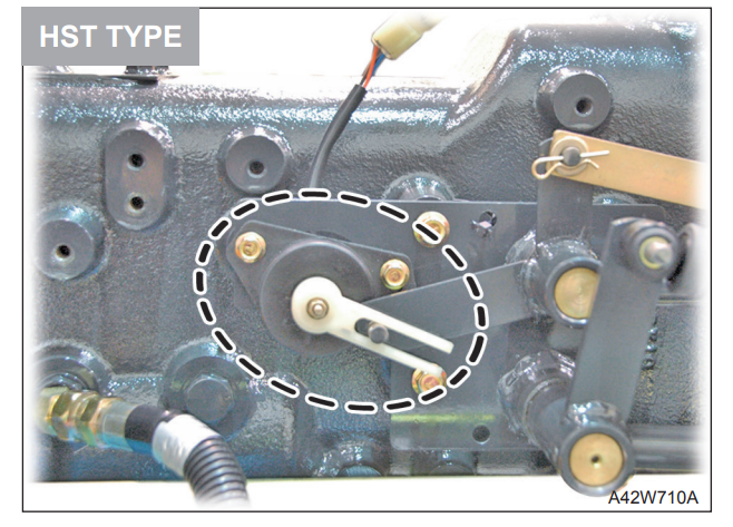

Jun 15, 2023 / 2515H Neutral safety Switch #1 N nosaj2 Member Joined Jun 7, 2019 Messages 41 Tractor none yet Does anyone know where the neutral safety switch is located on a Branson 2515H?
Jun 15, 2023 / 2515H Neutral safety Switch #2 N ning Elite Member Joined Mar 30, 2017 Messages 4,396 Location Northern California Tractor Branson 3520h nosaj2 said: Does anyone know where the neutral safety switch is located on a Branson 2515H? Click to expand... I don't think the H would have a NSS; my H (3520H) starts "in gear" all the time. If you're not starting, check if the PTO switch is turned on (not the PTO gear, just the electric switch).

Jun 16, 2023 / 2515H Neutral safety Switch #3 ptsg Super Member Joined Apr 3, 2013 Messages 7,779 Location Portugal Tractor Branson F36Rn - Agria 8900D Check under the HST pedals, on the linkages. The Neutral switch is there and needs to see both pedals at same height so it lets the tractor start.

Jun 16, 2023 / 2515H Neutral safety Switch #4 ptsg Super Member Joined Apr 3, 2013 Messages 7,779 Location Portugal Tractor Branson F36Rn - Agria 8900D Should look like this: Also, there may or may not be a light on the dash, a green "N", that should tell you by lighting up when the pedals are in Neutral.
