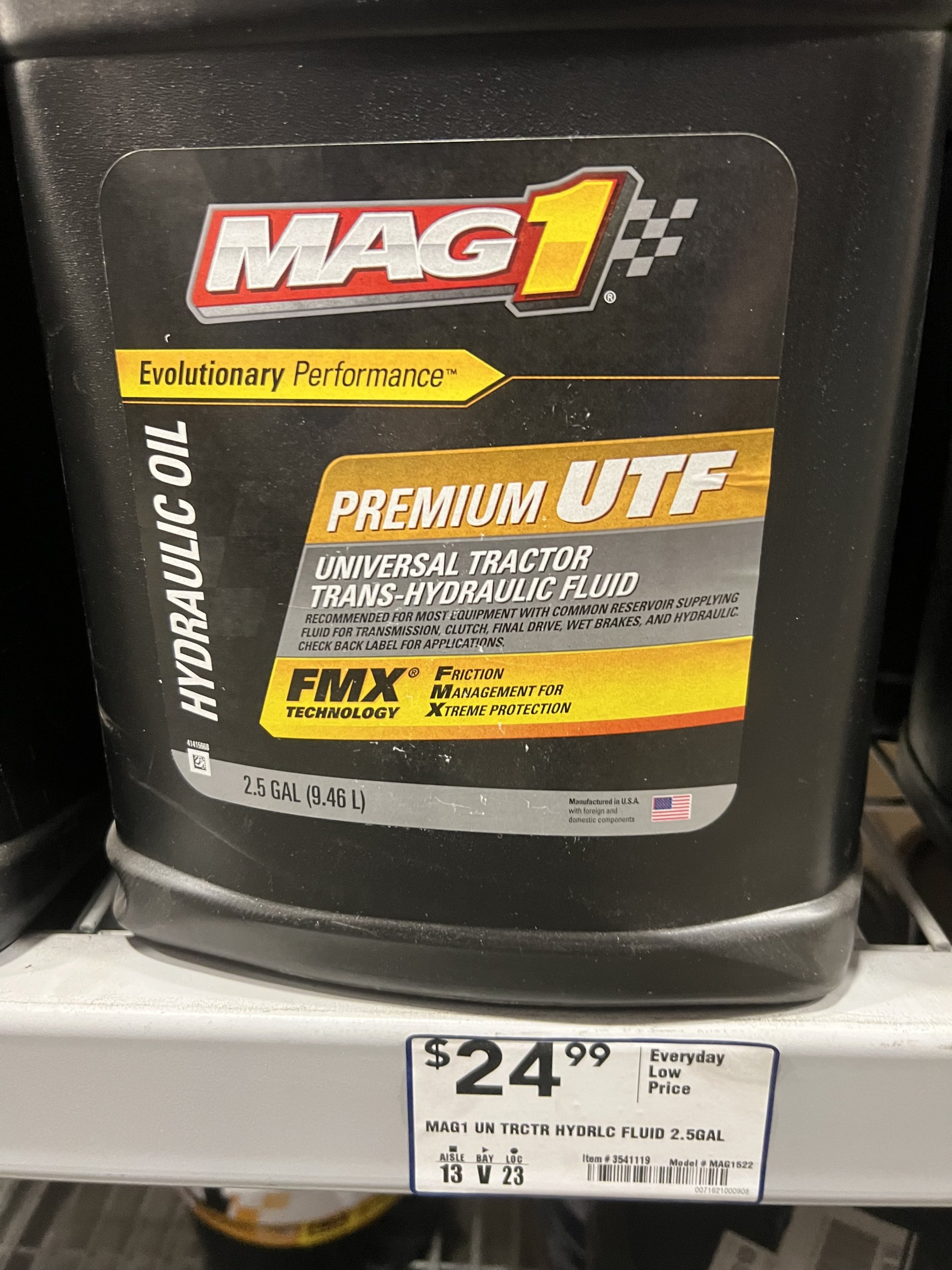

I was at Lowes and they have a Mag1 UHF, Would this be ok in my 245?
Apr 18, 2023 / 245 Transmission Fluid #1 J jtbuck Member Joined Jun 5, 2010 Messages 34 Location North Florida Tractor Massey Ferguson 245 I was at Lowes and they have a Mag1 UHF, Would this be ok in my 245?

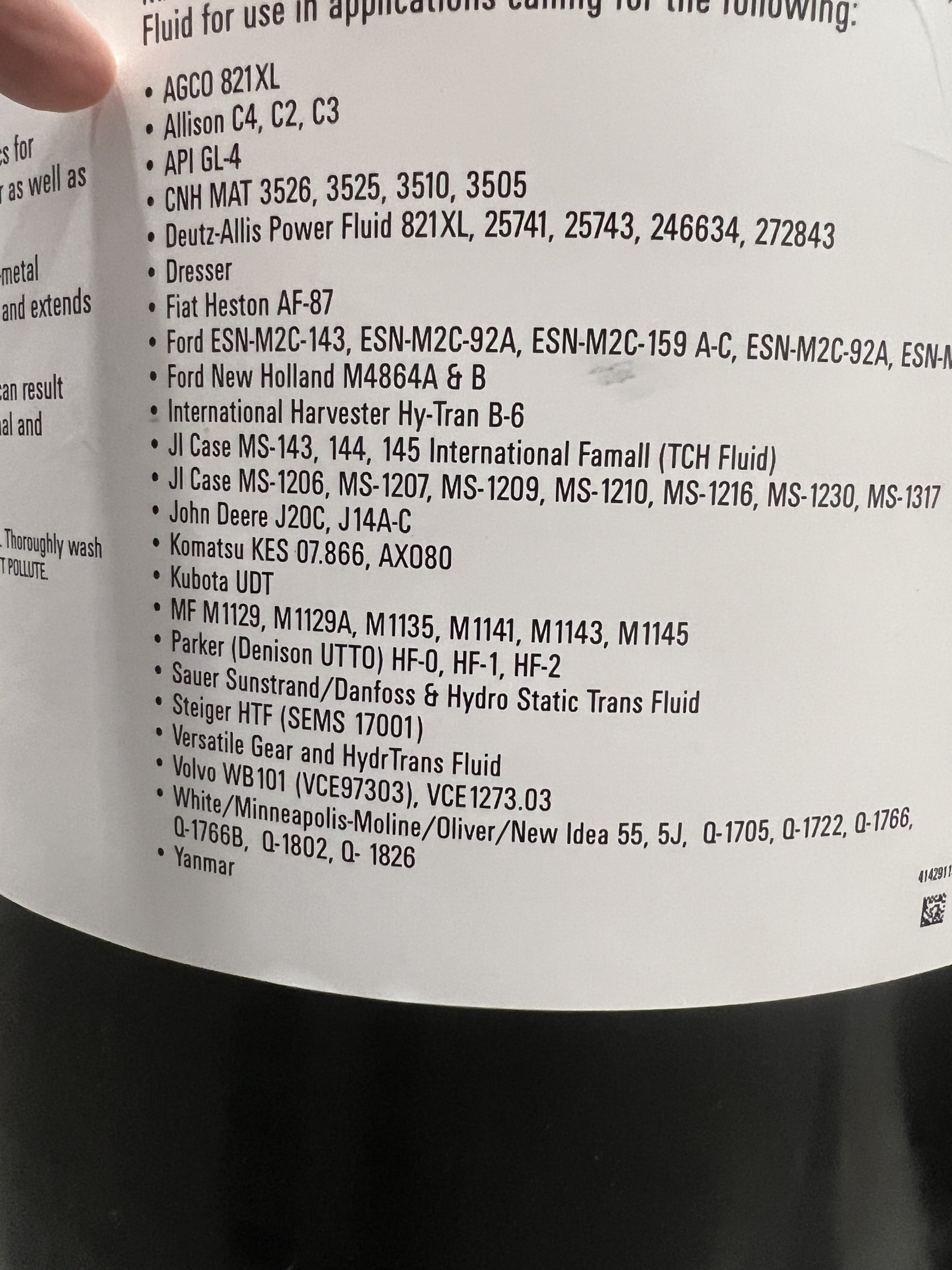

Apr 19, 2023 / 245 Transmission Fluid #2 T TractorTech Veteran Member Joined Jan 26, 2012 Messages 2,300 Location California Tractor Ford 7710, Ford 550, Ford 1910, Ford 4430, KD Forklift, Ford LGT17H, New Holland L255 Skidsteer In a 245, being an older model and not needing the latest oil, it would be fine according to the specs on the label.
