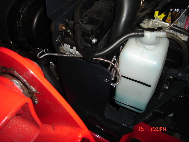

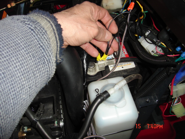

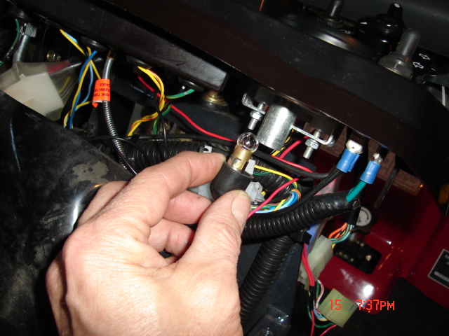

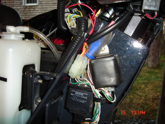

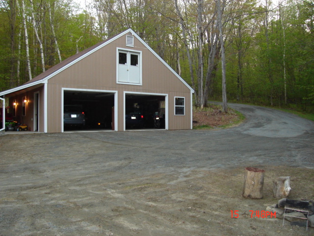

For what it's worth-- here are some more pics of the install; I also included some shots of my (now nice & dry) driveway that I'd been doing with an 8HP walk-behind for the past 20 yrs or so; hence the tractor/snowblower combo.
I powered the lights on both the temp gauge and the OEM fuel gauge (which had a tube for a light, but no light...) from the molex plug shown. This has 12v on the lead with the mark on the plug only when tractor lights are turned on. Maybe I'll change it to "on-with-ignition" later, but right now gauge lights will come on only when tractor lights are switched on. Grounds were tapped into battery neg line from blower deflector control switch wire.
The excess capillary tube from the gauge can be seen coiled up in front of radiator & squished under air intake tube. Think it'll be safe there.
Last pic is a shot into the woods of some of the downed trees I hope to use for firewood, now that I have a way to get at it & haul it uphill. Not much flat ground here!

Where'd you find a light socket for the fuel gauge, I've been looking around and their tough to find (and expensive).
DEWFPO
   / 2400 temp gauge #14
Going back to my previous days as a troubleshooter for pinball machines, jukeboxes, etc, I had some bayonet sockets kicking around- may have also gotten some @ Radio Shack at one point. Want one? If you can't find one locally, let me know. A couple of pieces of heat shrink and a rubber cup that had covered the end of a piece of tubing were the only other things needed. Yes, I'm a bit of a packrat; never know when you might need that little doohicky.... :D
