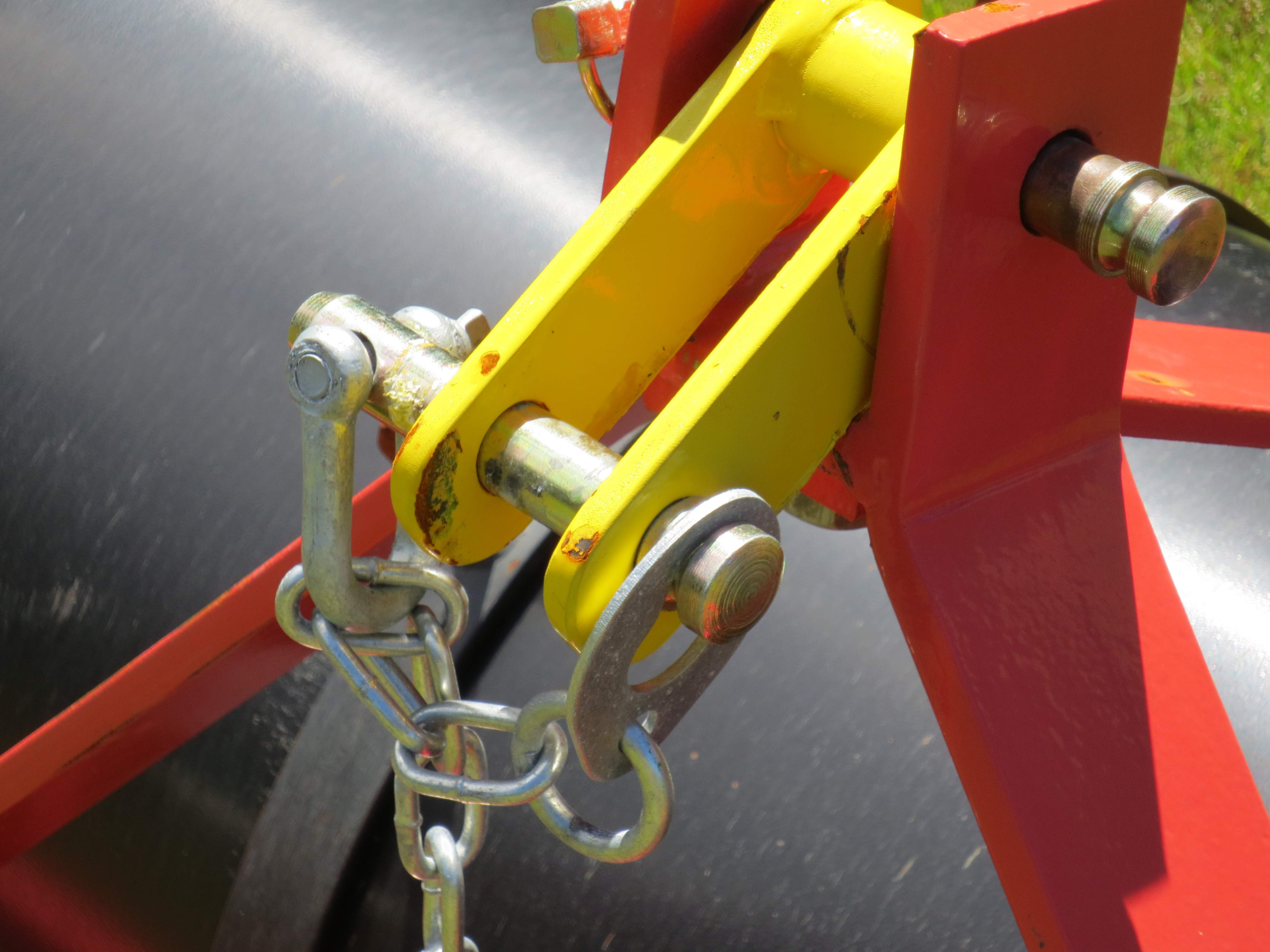

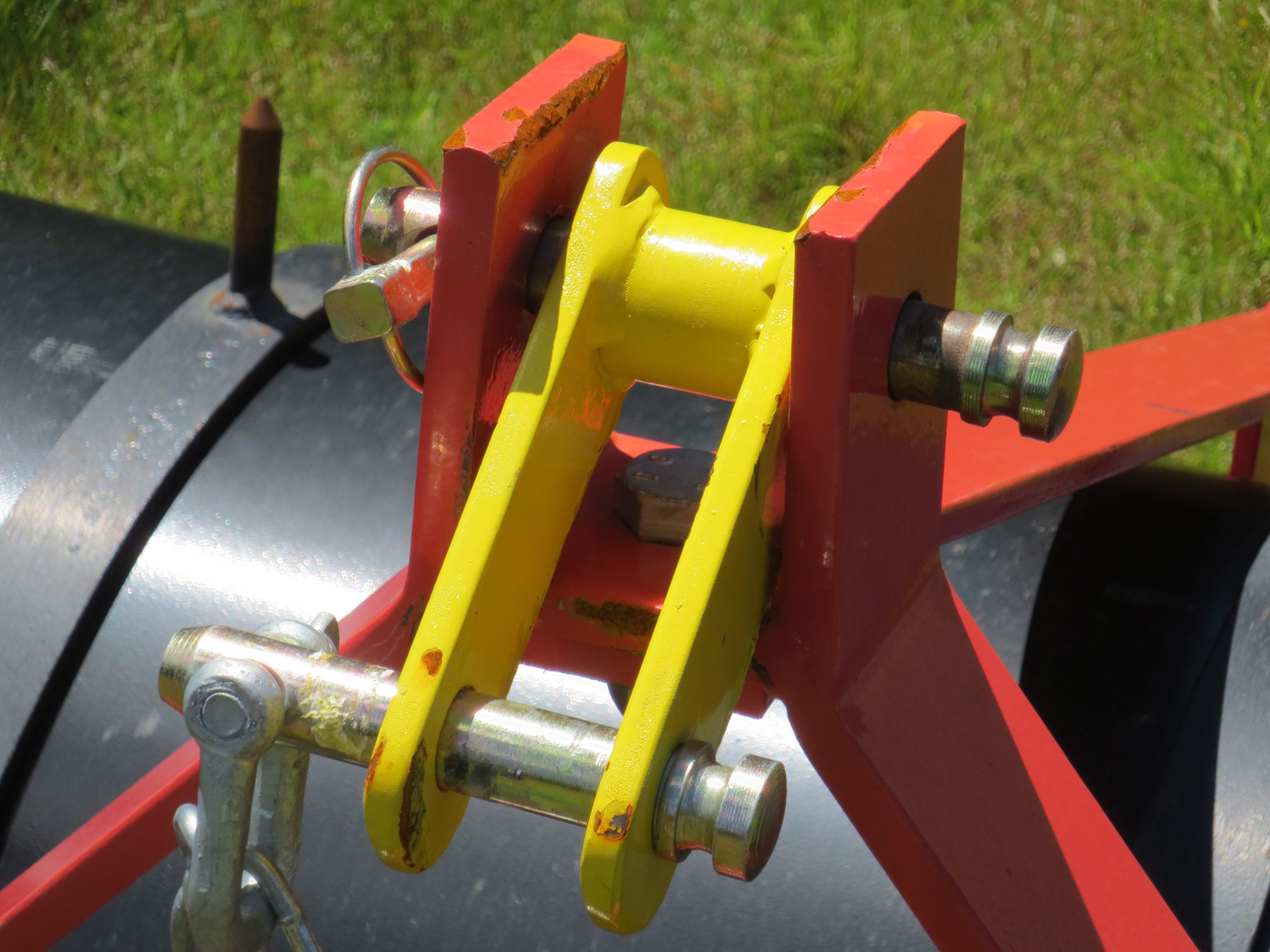

/ 2320 iMatch with Countyline Log Splitter #2
I also have the older iMatch and use an 'adaptor' that I had knocked up at a local welding shop. I also use a curb chain on certain ground-running implements (landscape rake, slasher, ballast roller) to ensure that the adaptor doesn't come out of the hook.

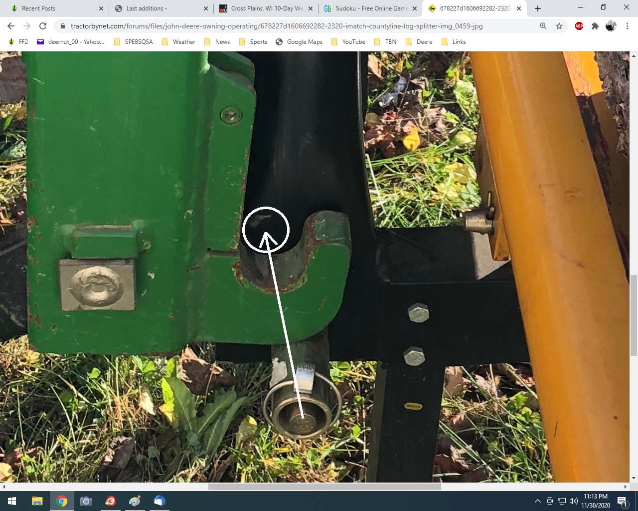

/ 2320 iMatch with Countyline Log Splitter #7
Don't give up so easily. Remove the lower pins and drill out a hole to re-mount those pins at a higher point.. looks like a couple inches.
Might have to find a drill bit the right size..
Move to the white circled spot.

/ 2320 iMatch with Countyline Log Splitter #9
That would work. Simple solution to this situation beenthere. :thumbsup:
If the OP is going to stick with that old-style iMatch (and why not? It works) I'd still recommend making up/getting one of those implement top-link extender thingys for future implements.
