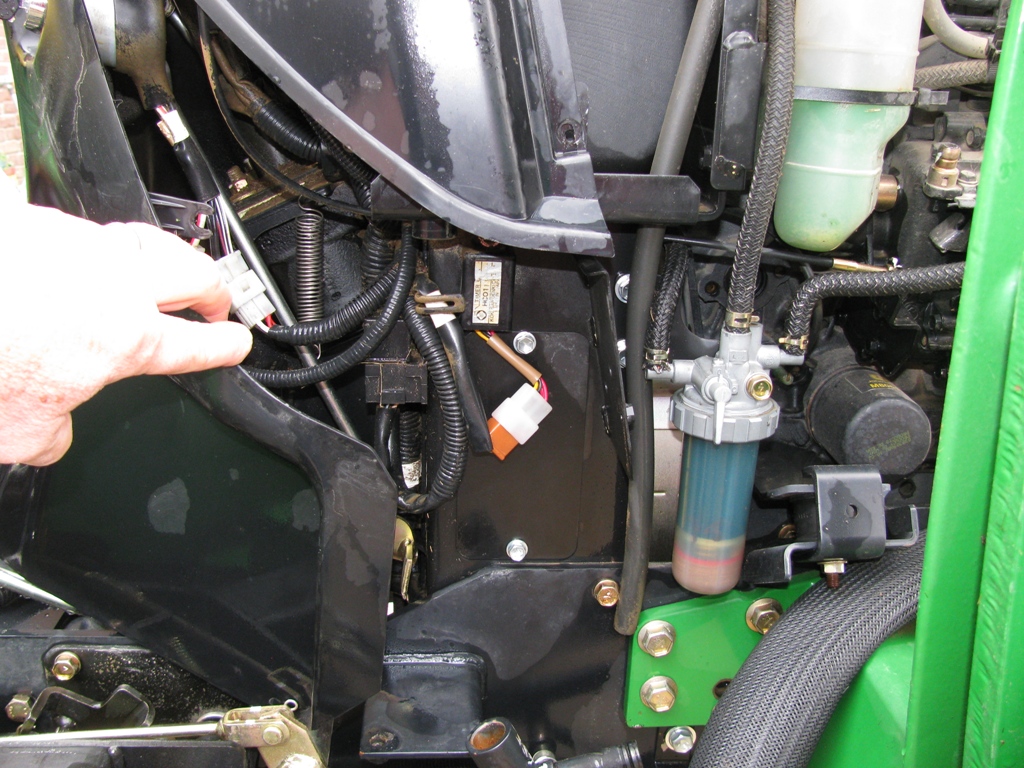

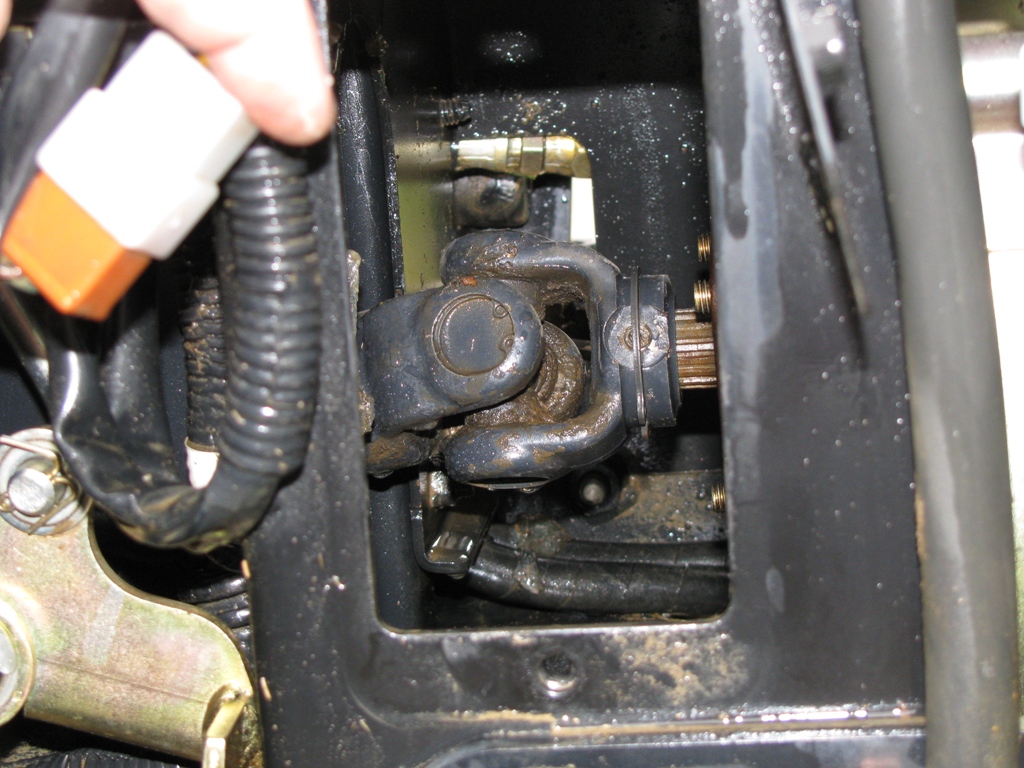

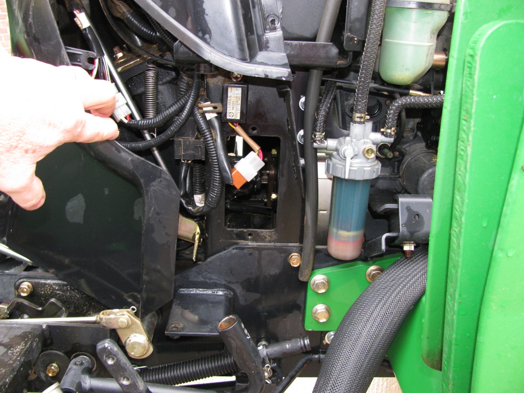

There is an access door on the right side just about shin high if you are sitting in the drivers seat. Problem is you need to pull back the plastic skirt to even see the door. the door or hatch is just behind that plug in the picture. This problem of greasing the U-joint next to the engine has been discussed ever since I bought my 2320 in 2007. My tractor is in the garage warming up as I type this getting ready for the morning when I was planning to tackle this really hard to get to Zerk. I'm also installing a water temperature gauge.
Here are a few pictures of the access hatch.
This is the first time I've heard of this access. I've been trying to figure out how to lube mine. Just how much do you have to take off to get at this access door?
