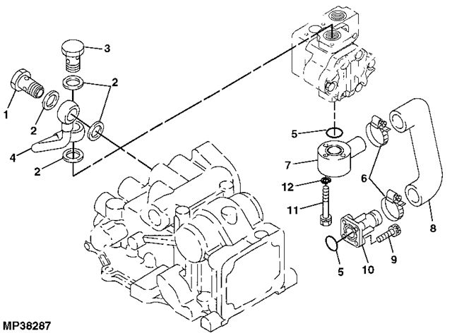

Ok, I am convinced that you are right and that the tech manual is accurate.
This is what I got today:
The implement pump supplies fluid to the housing where the rock shaft mounts thru. From this housing the fluid goes out two different fittings, one to the power steering and one to the scv. The diverter must be internal to the housing as I do not see anything externally. To get a really good view of this you have to remove the seat and plastic shroud as it is all hidden under there. The attached image shows the pump and the housing that I am talking about.
Now my friend was either confused, telling me a lie or confusing the 2320 with the 2520. The 2520 has a implement pump mounted on or in the front cover of the main pump housing and this supplies the power steering. Another implement pump supplies the same rock shaft housing where it supplies the rcv and scv.
From my previous post discriptions of what I was told it seems that I was explaining a 2520 and not the 2320 so the diagram and info that he was giving me was the wrong tractor. I would like to give him the benefit of the doubt but the service manager today took the time and pulled both tractor books.
Also to note is the last post that 2Malamutes posted. This was a very through explaination and documented with page numbers and a complete diagram of the hydraulic system. With this kind of information I was ready to go to the dealer and also with this type of information we all can trust that it is accurate and not just an idea of how it works. My hats of to you for being so through with your posts. Hopefully I was clear enough in my explaination.
Hopefully no one took offense by my insistance, but I just wanted to know one way or the other. Now I know and so should anyone else that has this question.

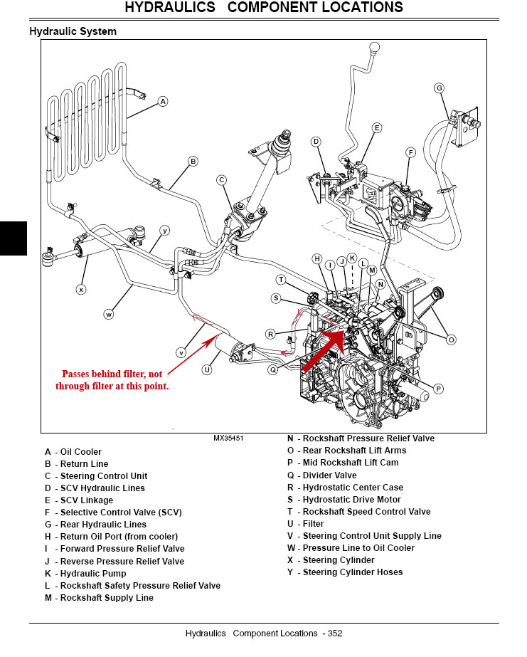

   / 2320 and 2520 Hydraulics #15
PCABE5 said:
2Malamutes,
Thanks for the detailed references. I will take this and the schematic to the dealer and have them try to give me some references or pictures of what they are talking about, that is if they can rebute anything that you said.
It will be interesting to hear what they have to say, based on what they've already told you they "know".
I've attached the most illustrative schematic I can find, which clears up any doubts I had since I took this out and traced lines on my 2320 and it looks exactly like this schematic from my tech manual. Big arrow (and "Q") point to Divider Valve, and the "Steering Control Unit Supply Line" (V) comes out of the Divider Valve just as the schematic I posted in an earlier thread shows. I've added some poorly drawn red arrows that show direction of flow, which is why I questioned your earlier post stating the steering supply line originates in the cooling circuit, since as you can see the cooling comes into play on the sump side of the steering circuit, which follows with typical hydraulic systems (return side cooling).
