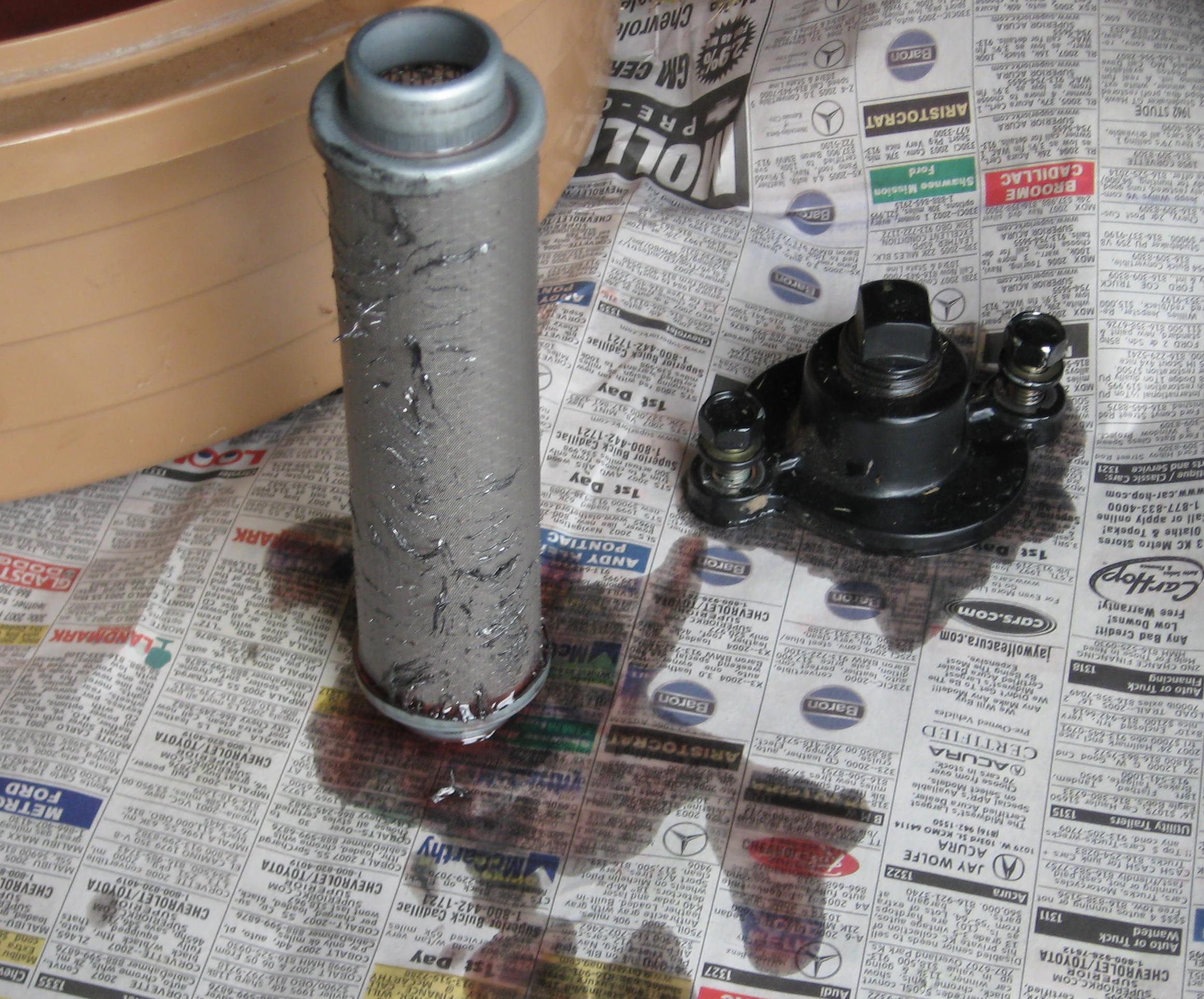

Here's what the screen looked like on my 2520 at 50 hours. I don't think changing the hydro oil and filters is a bad idea at all. Don't forget to pull the plugs on the final drives to get that oil out too, if your machine has them.
Well I don't think you need much more convincing then that if your on the fence about changing at 50 hrs or not.

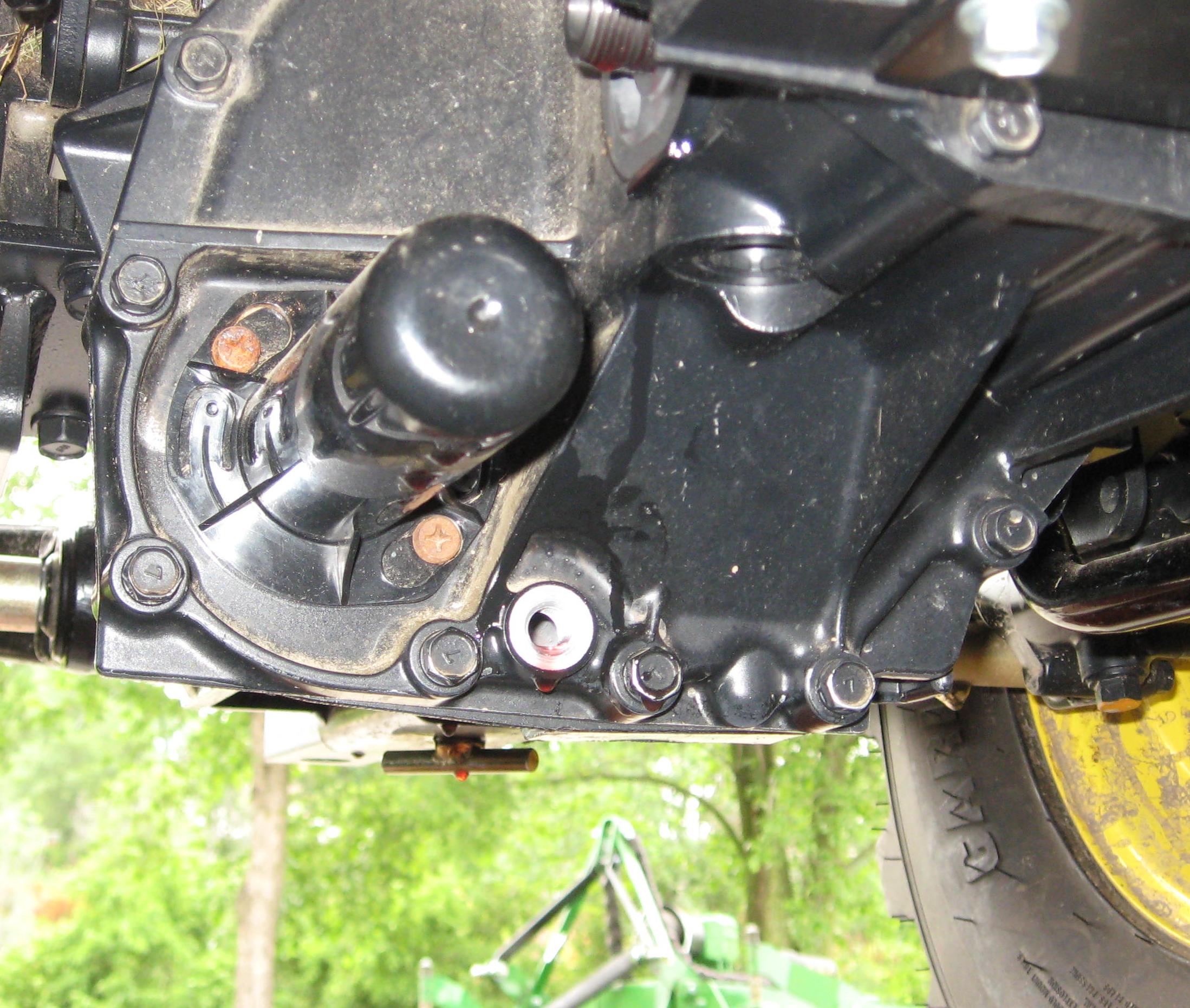

I really wasn't on the fence about whether or not to change everything, I've already seen pictures like Runners on this site before. I was just wondering if JD misprinted the chart under the hood. My tractor probably had less than a half of a teaspoon of metal shavings and the screen looked really good. It's a little late now, but what exactly would be the "final drives"?

The final drives are the reduction gear boxes in the drive train just inside of the wheels. In my attached picture, you can see the orange plug in the bottom of the left final drive in the background. My 2520 manual did not mention draining these and I missed them on my 50 hour service. By the time I figured out that they contained the same oil that was in the rest of the hydraulic system, it was too late and I already had $65 worth of new oil in there.
For that reason, I will also be doing a "90 hour" hydro oil change on my machine....
Since the publication of my manual, JD has corrected the instructions and now calls for pulling these plugs too. I should have known, but am just too much of a newbie...

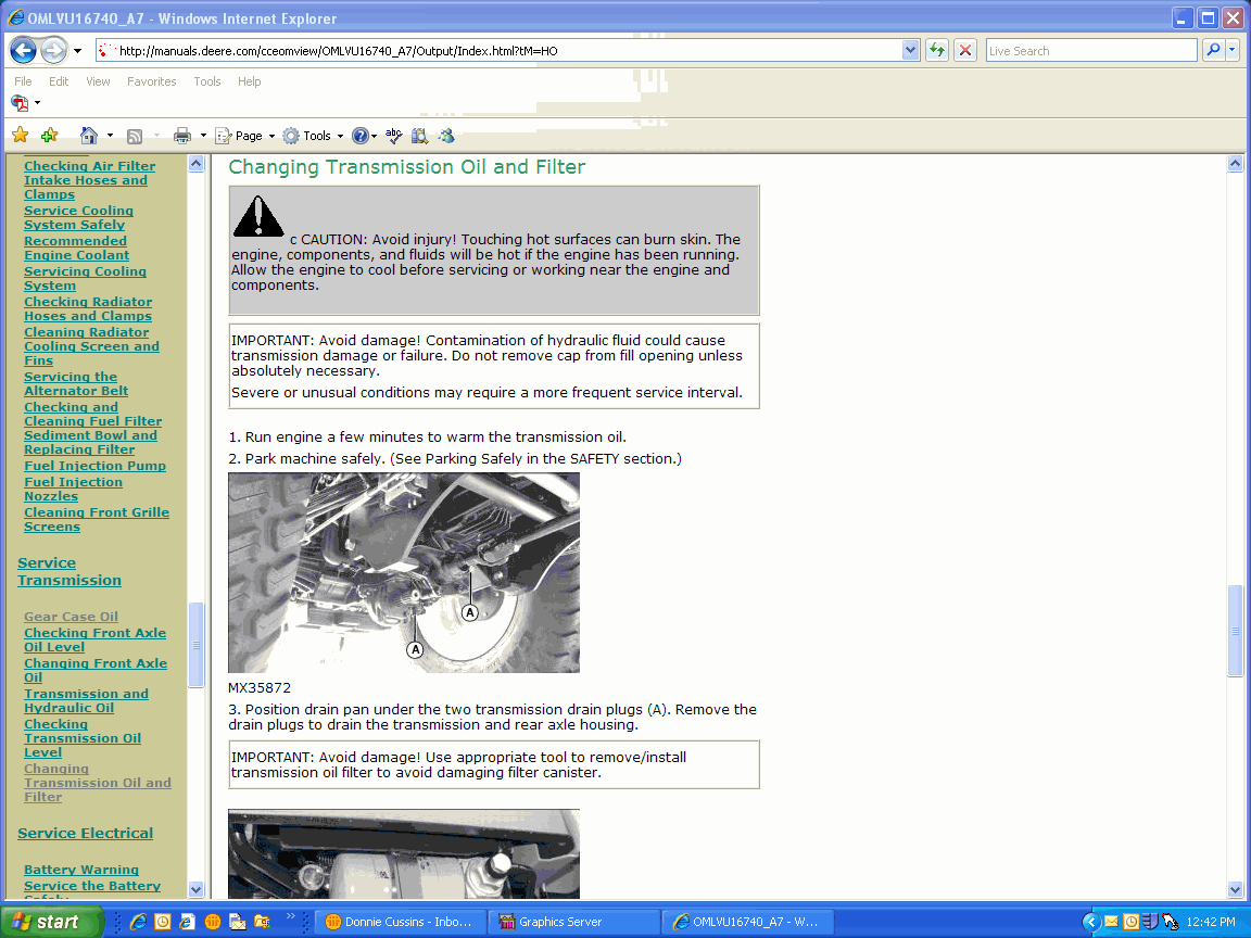

I removed both of the ones the manual showed. Looks like the same area your talking about. Thanks for the pics.

I intended to change my hydro oil at 50 hours as the chart and manual stated for my 2520. But when I looked at the manual, the pictures were of some other model tractor, so I waited that day. It took me months to print out the trans section of the more-current on-line manual, and get back at it, and the tractor had 110 hours on it by then. Meanwhile I had added top and tilt cylinders, a new three-spindle valve, about 20 feet of hose, a rake with two of its own cylinders, and a backhoe. All this new hydraulic stuff had been on and off many times and used quite a bit, and each hydraulic component probably added its own share of contaminant to the oil. The day that forced the issue was one where I spent 7 hours moving dirt, probably 40 yards of dirt, with the loader, from an old fenceline and forming a waterway. After that day, I felt I better get the oil changed. I used half and half standard JD oil and low viscosity. It took 17 quarts. The screen had about ten times as much metal on it as the photo by Runner showed.
