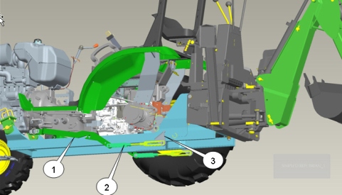

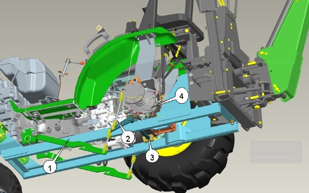

Unfortunately the 2520 / 46BH / MMM combination does have issues. See John Deere's explanation in text and pics below:
46 Backhoe - mid-mount mower interference - 2520, 4115
With a 2520 or 4115 Tractor, the sub-frame for the 46 Backhoe needs to removed if changing from backhoe to mid-mount mower. Depending on which mower deck lifting system is used, the parts are different.
For independent lift system, remove:
1 - (2) Lift arms
2 - Lower rockshaft and adjustable links
3 - (4) Screws and huts
4 - Hydraulic cylinder and hoses
(see drawing "46bh1")
For mechanical lift system, remove:
1 - (2) Lift arms
2 - (2) Adjustable links
3 - (2) Rear draft pivots and 3-point hitch draft arms
(see drawing "46bh2")
Regardless of which lift system, remove:
Front draft arm pivot assembly
Note: With 2320 Tractors, this does not apply. The mower deck does need to be taken off the tractor for the 46 Backhoe, but the attaching parts for the mower deck can stay on the tractor.
