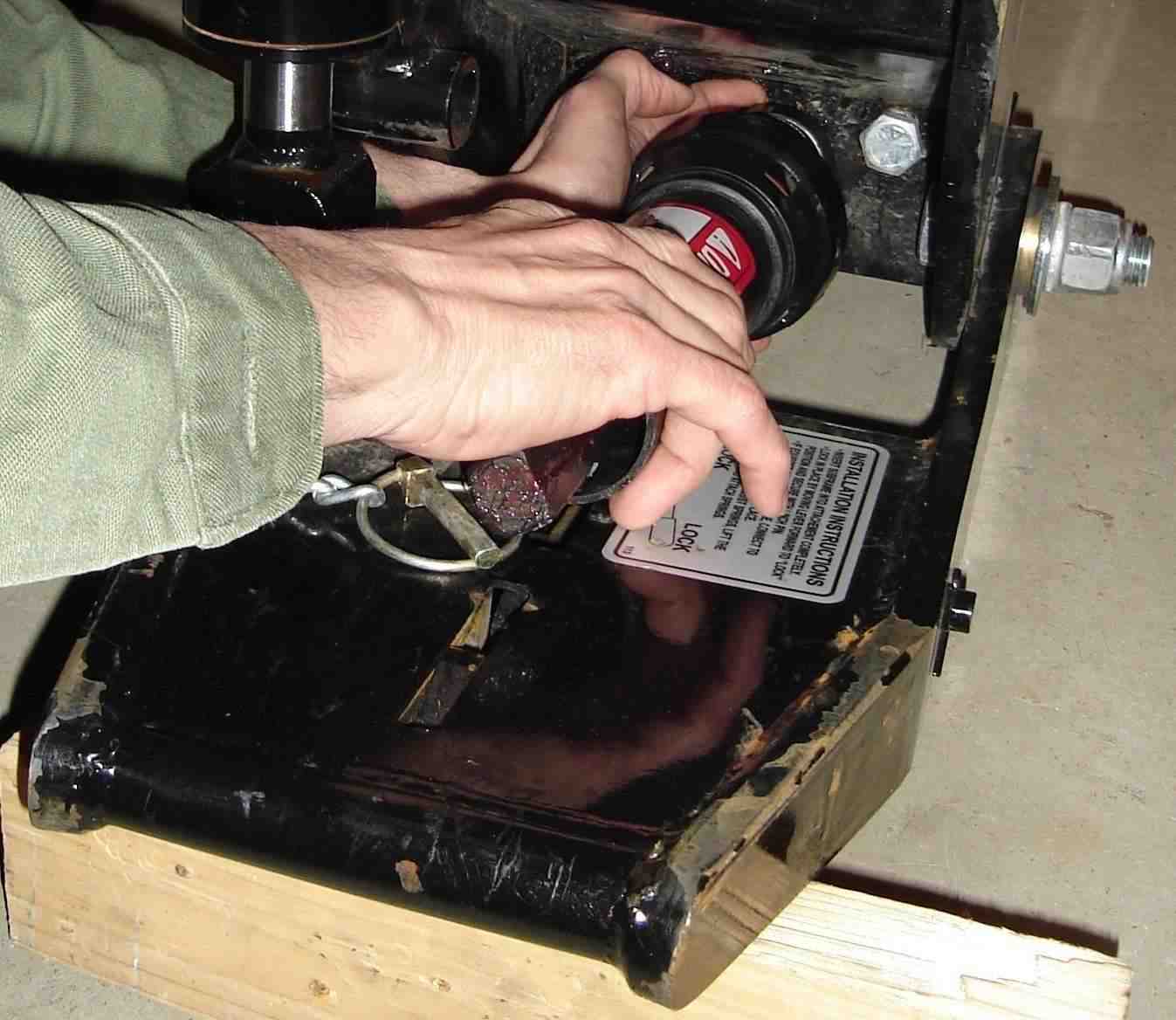

What would be a good idea is to put a cover over the male splined shaft in the rear-- I found, after asking at an auto parts store, that there IS such a thing as 1" heater hose (everything I'd ever seen was 3/4"), which fits beautifully over the 25mm splined shaft; the end cap is a cover from a can of spray window cleaner, jammed on & spotted with a few drops of thin super-glue (hobby shop item). Crude, but effective.
Also, I do NOT trust "hand-tightening" the T-handle on the metal plate bolt-- I tap it several times with a small hammer to be sure it's secure. (No way to gauge torque with that T-handle.) If you look closely, I believe you'll see that most of the stress on the attachment is carried by the hooks that the whole thing hangs on where it attaches to the front of the frame--the "bumper" in the manual.

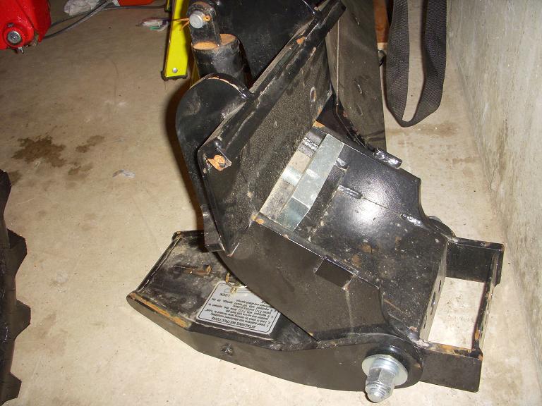

Husky Driver-- as an aside, the front portion of the quick-hitch driveshaft is removable, with a quick-release sleeve. It's WAY in the back, but once pulled forward, the "square" shaft piece will pull off-- (I'm making the assumption here that, even though the plow you got doesn't need it, the quick-hitch assembly came with it.)

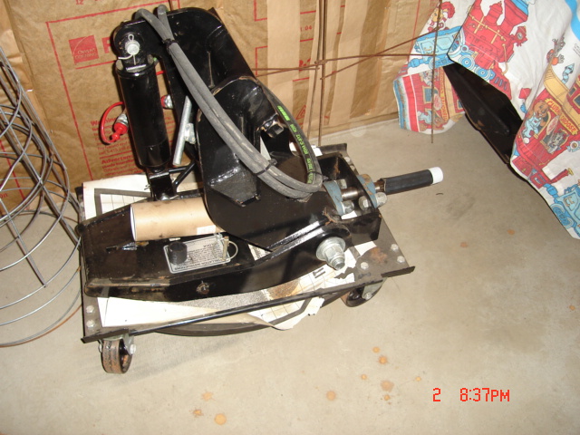

The quick hitch did NOT come with the spline setup (shown in the pictures below). Now I'm thinking it should have???

Huskydriver-- sounds like, since the plow doesn't need a driveshaft they just left the drive stuff off, most likely to keep the price down.
I know a good part of the relatively high price for the blower was due to the drive system "extension" from the mid-PTO to the rear of the quick-hitch, and the adapter shaft & bearings for the front-mounted items that require it (blower, rotary broom). You could call your dealer and ask about the blower- I suppose they'll ask (or know) that you'll need the driveshaft items to be mounted into your quick-hitch....
