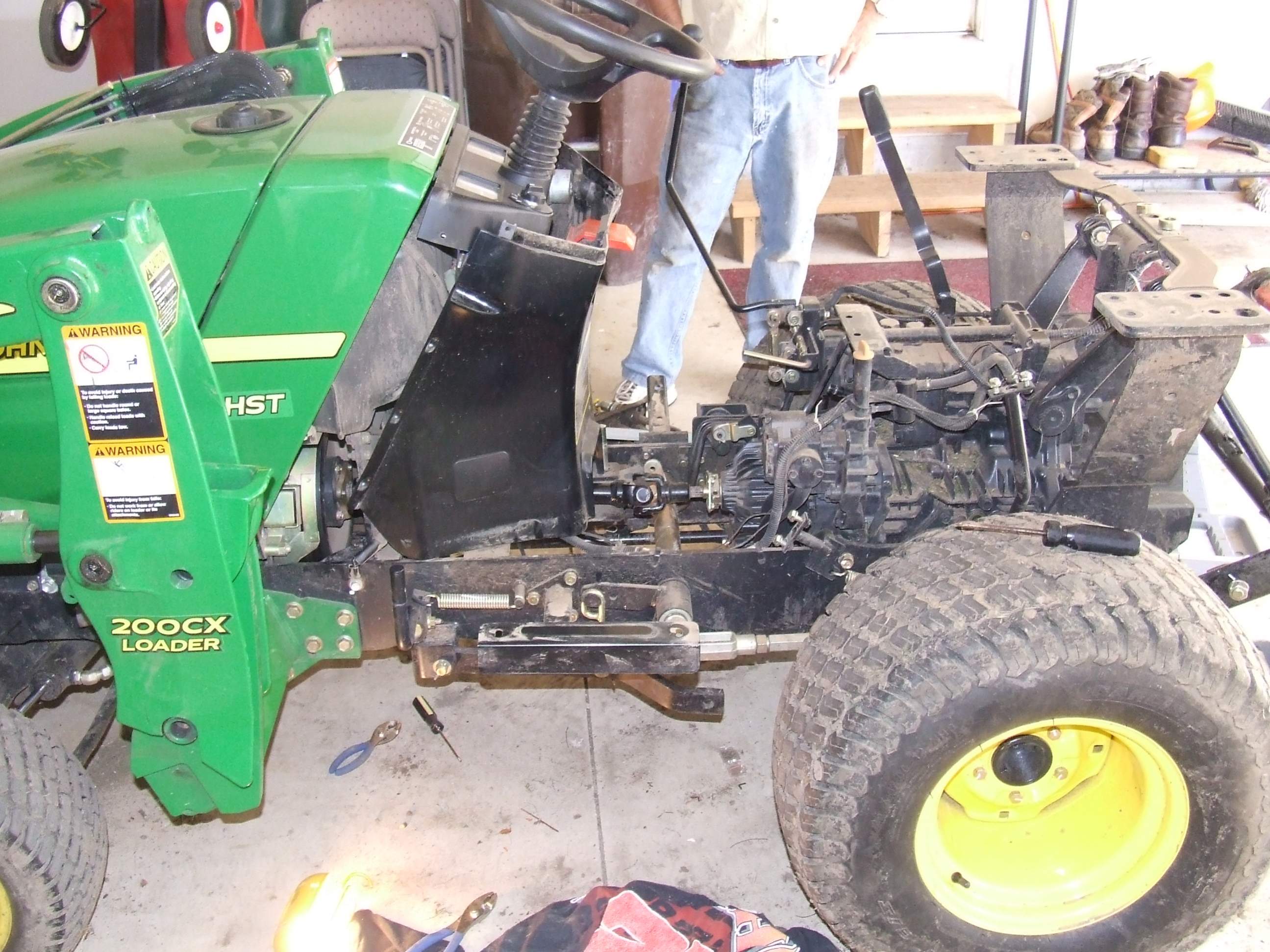

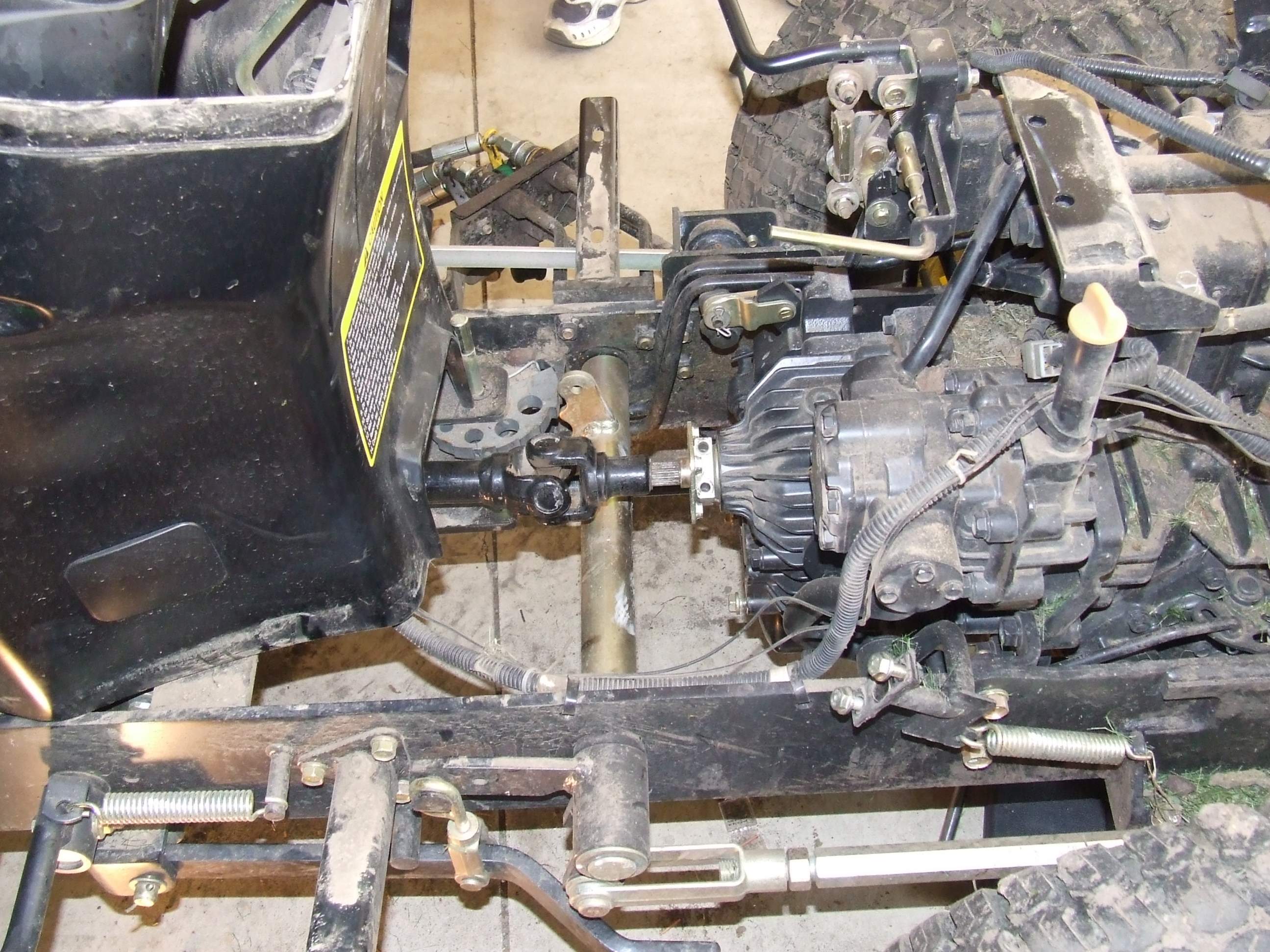

All fixed about 6hr job but I have some new ideas if it happens again. Not sure I needed to take all the finders apart and floor but I did and it did make it easyer but I think I might be able to just get the front pin of the driveshaft out with a little help from someone. I do have some pics if anyone is interested. Just a few of it apart I forgot to take one I replace the fan LOL.

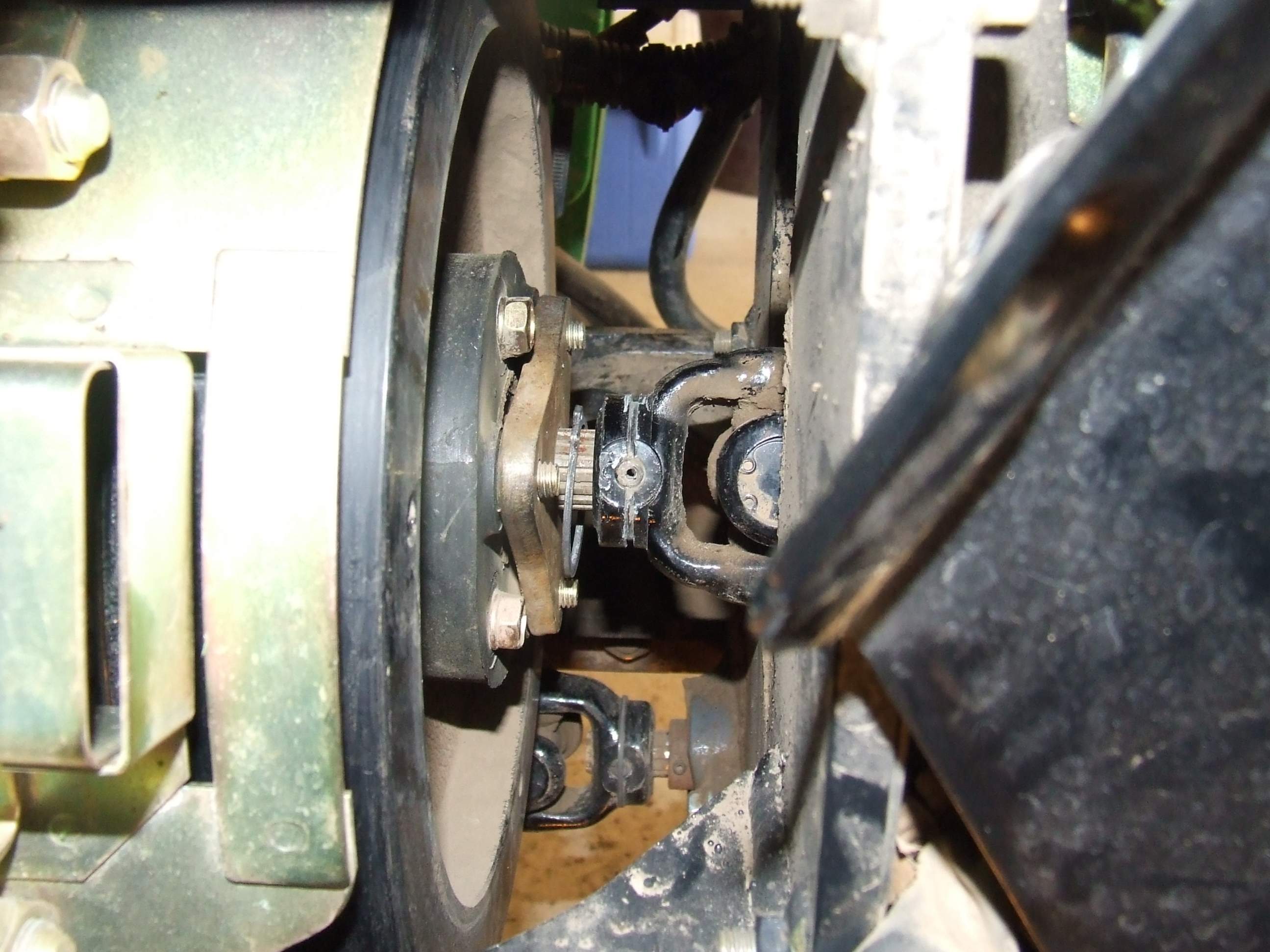

#12
I hope this works
/ 2305 Trans fan gone #13
How did you remove the driveshaft? did you remove the roll pins,flange or something else?

I am here. :) You need to get to the front pin of the drive shaft. Take off the clip then drive it out. That should allow you to push the shaft back far enough. That is the hardest part in my oppinion and getting the clip back on is a little tuff too.
/ 2305 Trans fan gone #16
fan problems .I just serviced my 2305 50 hours I was having a hard time greasing the joints they were turned could not get grease to it so I pulled the shaft and greased it on the bench realy easy job so changing the fan would be easy also taking the shaft out and back in maybe a half hour.but the 2210 to take the shaft out is a b''''''ch done that to about 6 hours.the 2210 the tractors are not to easy to work on.
