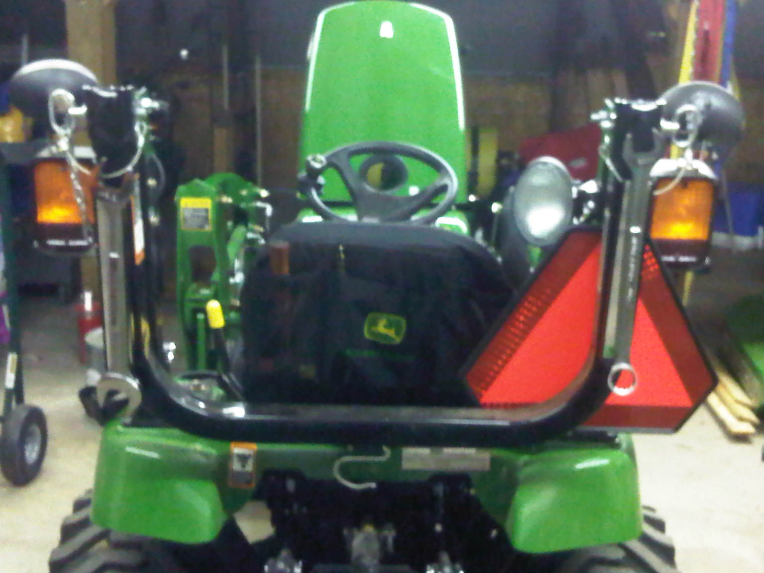

Attached is a pic of my 2305 with the folding ROPS. The folding ROPS is made by FEMCO (search TBN), also a link:
Femco, Inc.
I purchased the folding ROPS, and had it shipped to my JD dealer. They installed the ROPS for me and wired the lights prior to taking delivery of the machine.
Of note, the 2 wrenches on the back are a 30mm combination and an open face with a 1-3/8. The 2 necessary sizes (for my 2305 anyways) to tighten the leveling nuts on the 3 pt hitch. I bought a couple of them magnetic tool holder thingys from Sear's and slapped them on the ROPS.
I LOVE my machine. It can do anything a big machine can do, just takes longer.
