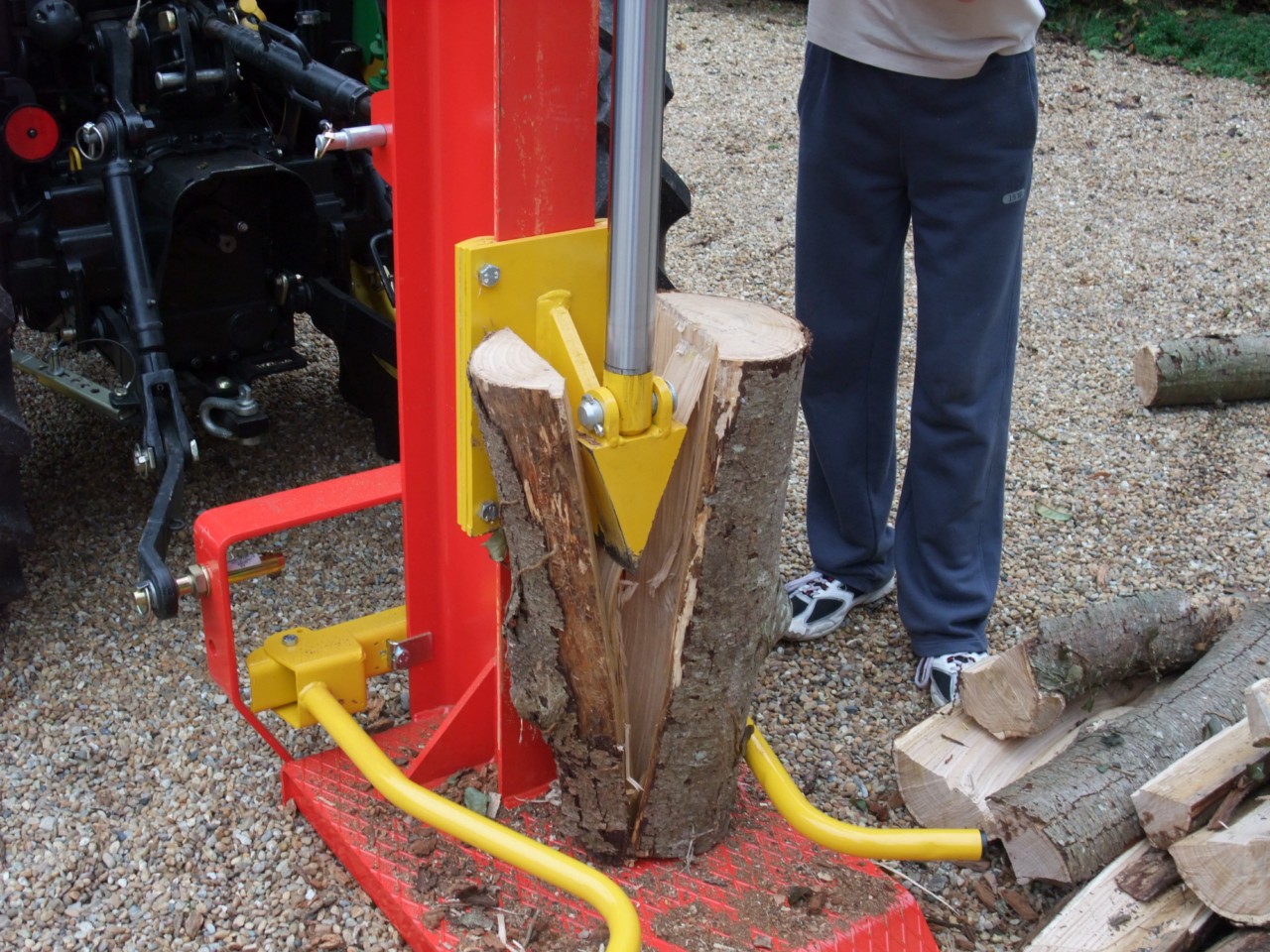

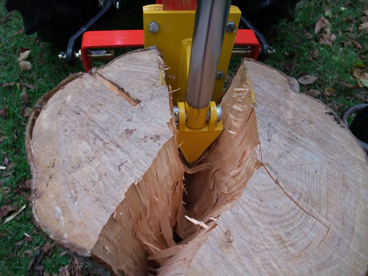

I bought the 4-way wedge from Ramsplitter for an extra $75. It slides over the existing wedge, so you can change from 4-way to single wedge very easily.
The 4-way wedge works great for logs that are just the right (perfect) size. If they're too small, you'll get 2 nice chucks that split off the bottom, and 2 slivers that split off the top.
If the log is too big, you'll get 2 big chunks off the top that don't ideally make "perfect" size pieces if you run them back through the 4-way.
Most of the time I split with the single wedge, then slide the 4-way on to do a bunch of "perfect" size logs all at once.

Sorry it took so long, Pics of logsplitter in action, and the tractor dressed for winter. Fred
