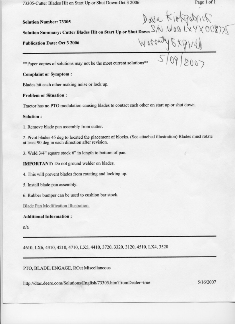

Copies of JD Solution # 73305 for anyone that's interested.

After two more attempts, it appears the JD dealer finally got it right. The blades bang around a bit when you start it, but so far the modification seems to be working.

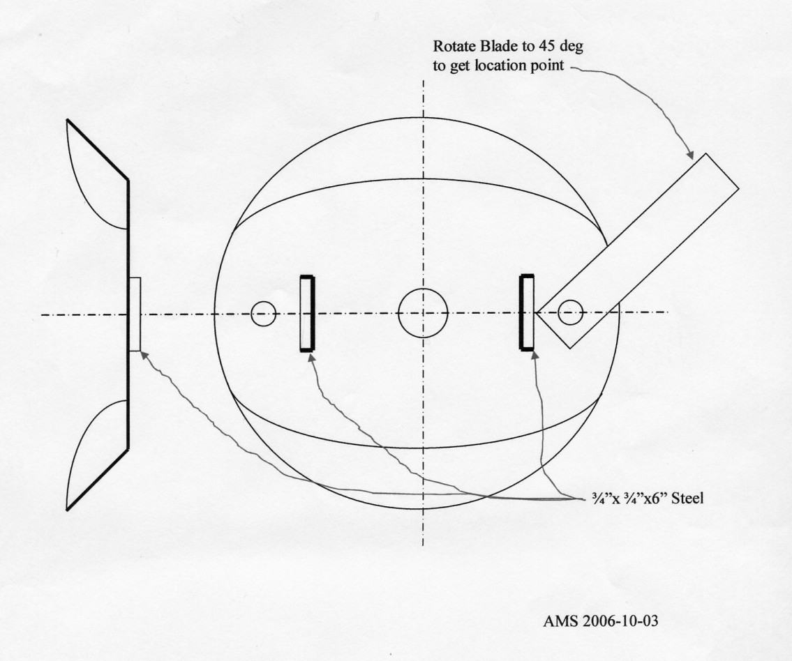

Glad to hear that your cutter is up and working again... Gotta ask if they rewelded those stops or what solution did they finally use?

Just rewelded it in the "correct" place. (The second time they rewelded it, they put the stops against the blades so they couldn't turn at all.)
