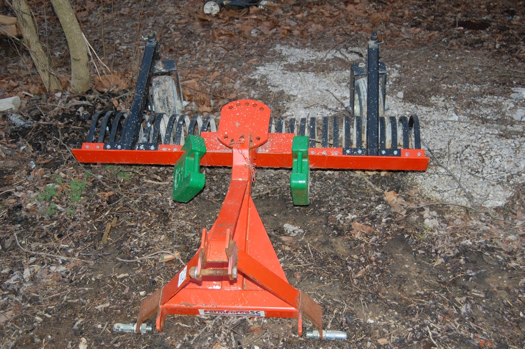

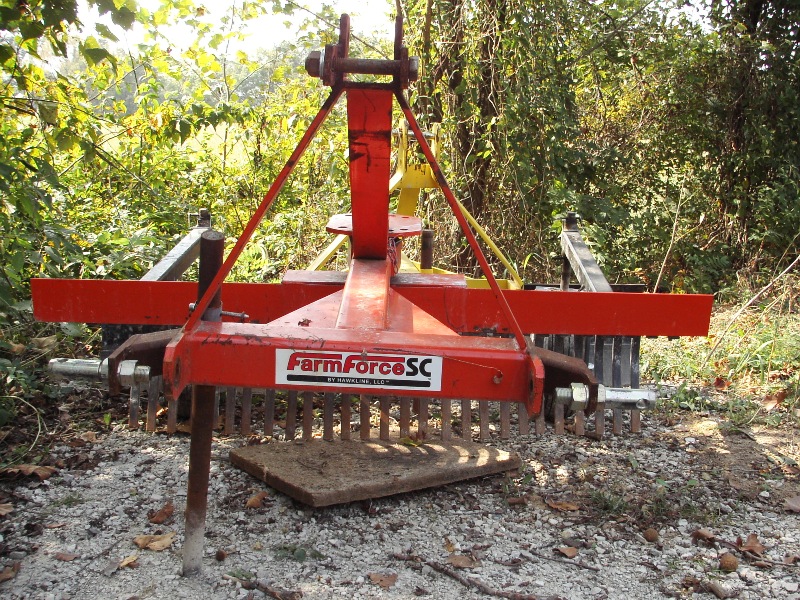

ensoll,
I use a 5' rake with my 2210 (almost identical to the 2305) and the size is a good match.
I have a FarmForce SC which is a sub-compact model similar to the XB line. It's not as strong as it needs to be. I've actually bent mine with my little 2210! If I were buying again I'd pay a little extra for a more heavily built unit. This is the only one I've ever used so I can't recommend what brand is better in this size.
The Sub compact stuff like the King Kutter XB and Farm Force SC is usually set on 20" pin spacing.This isn't a problem unless you use a quick hitch like I do. I had to modify my rake to fit the hitch.
I like the wheels, others don't. I personally wouldn't buy a rake without them.
Good luck in your search! I'm sure you'll enjoy having a rake. The only thing I have that gets used more is the loader!
