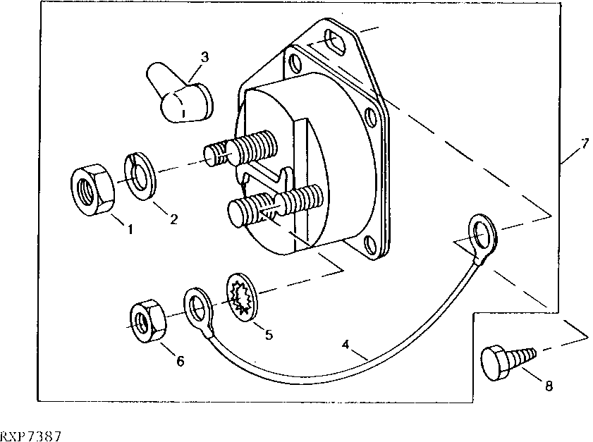

You're correct ign switch in the on(run) position should no affect temp of solenoid unless ign switch was shorted internally. Check for voltage when ign switch is "turned on" at wire on starter solenoid that attaches to ''S" terminal. With someone sitting in seat with clutch pedal depressed try shorting across from top post to "S" post on solenoid to see if starter will engage. On some models JD added a starter relay to provide more volts to wire that attaches to "S" terminal.1st photo is a kit but just the relay(2nd photo) is about $25
With tractor in neutral, I am getting 10.5v at the S terminal as well as the copper link to the starter. If I hold the lead on the S terminal, voltage starts to slowly increase to 10.51, 10.52, 10.53 etc. is this normal? I didn't have anyone to help me hold in clutch today but I tried jumping solenoid with screwdriver and got some sparks but nothing else. I may try replacing the relay. It's pretty rusted and one wire has some pretty noticeable corrosion.
