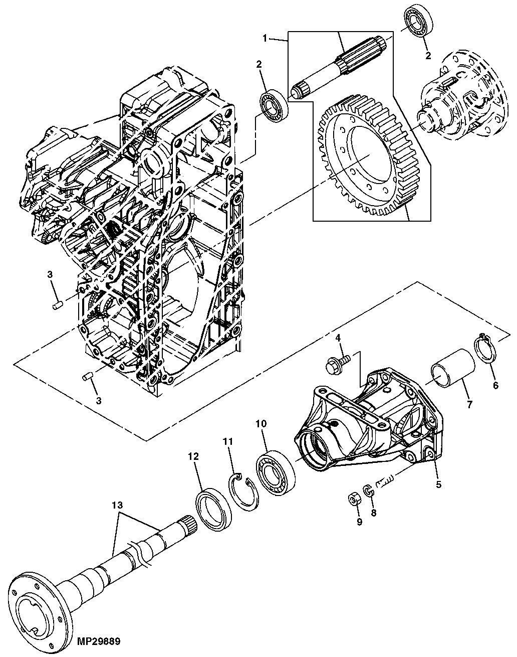

Anyone have to replace a rear axle seal on a 2210? I took it into my dealer to have it replaced and was told its a 2 and a half hour job. (Told this 2 times, the second time after they had determined what needed to be replaced and had the parts on order) Only to get a call a week later telling me its now a 20 hour job and will be over $1600. Pretty big jump from about $250 to now $1600. Needless to say I am not having them do it. Another dealer just quoted me 5.5 hours.
Anyone have an idea of how long this actually takes???

Don't know what "book" time is, but here is the parts involved:
REAR AXLE AND FINAL DRIVE
Cart key PART NO. PART NAME QTY SERIAL NO. REMARKS
1 LVA801043 Gear Kit 1 FINAL GEAR
2 LVU800542 Bearing 2
3 M802255 Pin 2
4 19M7786 Bolt 14 M10 X 30
5 LVU800869 Housing 1 LH
LVU800870 Housing 1 RH
6 CH13489 Snap Ring 2
7 LVU800965 Bushing 2
8 12M7066 Lock Washer 2 10 mm
9 14M7274 Nut 2 M10
10 CH13506 Ball Bearing 2
11 40M7043 Snap Ring 2
12 CH13163 Seal 2
13 LVU800867 Axle 1 LH
LVU800868 Axle 1 RH
.. TY24344 Liquid Gasket 1
/ 2210 real axle seal #3
I don't. But, looking at mine, it appears the outer axle seal is an internal seal. Don't see any seal flange or edge sticking out of the case. If it is installed from the inside that would explain the high labor cost.
Looks like the outer axle housing would have to be removed from the main transaxle case. To do that the case has to be unbolted from the chassis because a frame mount is built on that outer housing. Could probably cheat and support the transaxle somehow and remove the housing. But don't know that for sure.
Again, if it's an internal seal and it can be replaced without removing the transaxle I'd say your last quote is logical. Even with removing the transaxle it's not a 20 hour job.
Lastly, I'd be concerned why the seal started leaking?? Did you wrap something around the axle shaft and take out the seal by using it that way?? If not, then I'd suspect a bearing issue. As long as the bearings are good and no foreign object has intruded on the seal there is no reason for it to start leaking.
I'm very curious how this ends. Please post any progress.
/ 2210 real axle seal #4
I was typing the same time as Kenny so didn't see his diagram until I had posted.
If you look closely at the diagram it's clear that the seal comes out, rather than going in to remove as I suggested. But look still closer and you'll see that the short axle shaft is held in the outer case by snap rings. So the outer housing has to be removed from the transaxle. Then remove the inner snap ring and the axle shaft with wheel flange will come out of the housing. This allows the seal to then be removed and replaced.
I'm still thinking your quote of 5 hours is pretty fair.

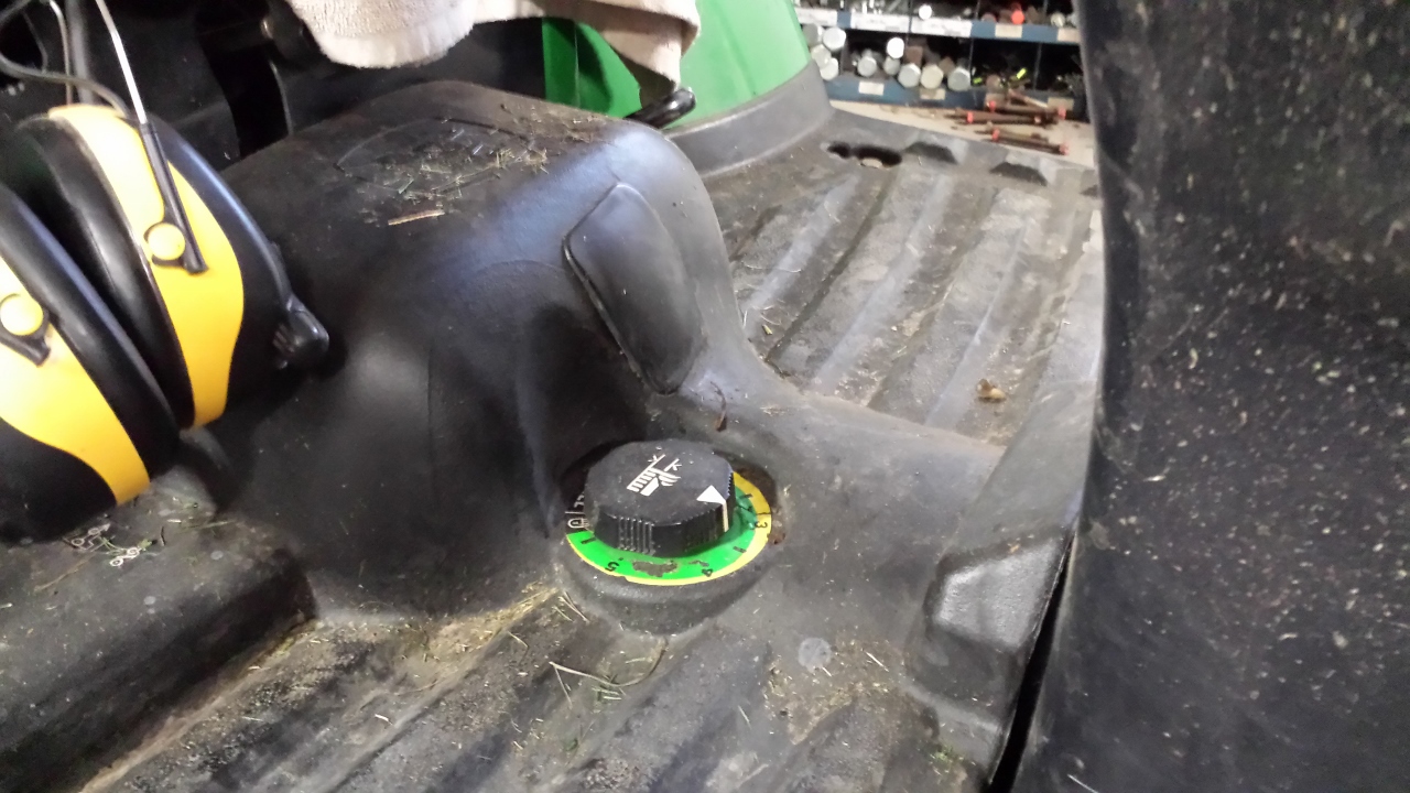

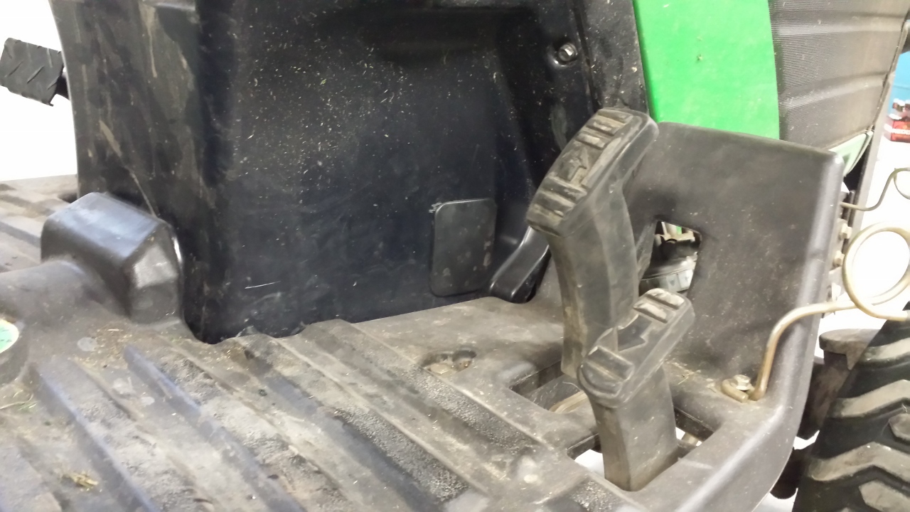

Let's see if I can help ya.
First I cut a square hole in the floorpan, center, over the rear u-joint. Cut the right size you can buy the JD rubber plug to fit. That let's me reach the rear u-joint zerk with a needle fitting.

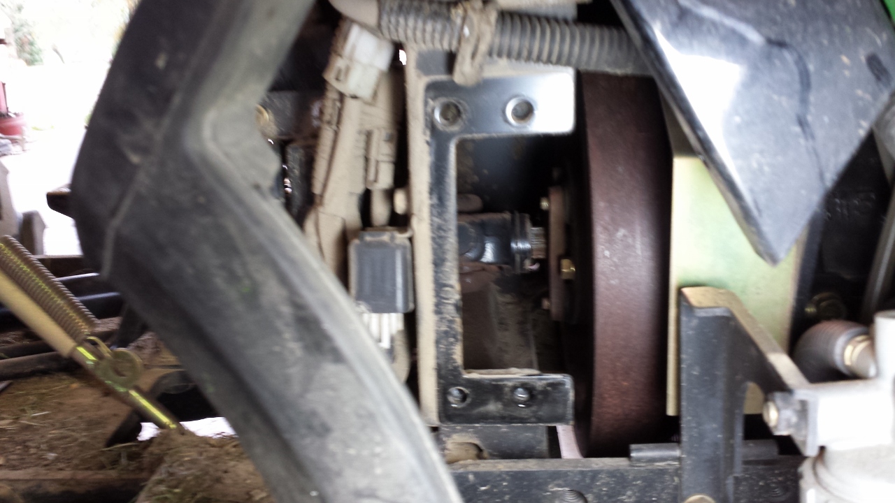

Then I removed the plastic cover below the steering column, then cut away a portion of the metal framework, then cut another square hole in the plastic with factory plug to close it, this allows me to reach the front U-joint.
These two modifications allow me to grease both joints. I grease them every 30-40 hrs or whenever I remember. :)
