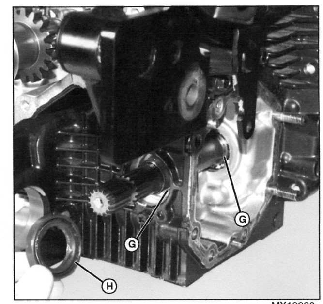

Any suggestions on how to approach this problem? I noticed some leaking from the mid pto shaft area last night after "mowing" the fields with the LX4 cutter (the 62" mower deck was also in place, but not in use). There appears to be a very slow, but consistent drip from the bottom of the mid pto shaft (I have taken off the mower deck). After looking on JDParts, I can't tell if there is some kind of rubber gasket/seal on the this shaft-it appears to have only bearings and sleeves. Any other leaking 2210's. About 150 hours now.

Maybe this picture will help you out. If you have oil dripping from mid pto you need a new seal. My father in laws 2210 seal started leaking at around 260 hrs, after raping a piece of baling wirer round the shaft. He replaced the seal and all was dry around the shaft again.

Thanks for the comments on the seal--the pic really helped. I am guessing that it was the seal causing the leak. Will be contacting the dealer tomorrow.

The dealer called--it was the seal. They had to order the part, should be in tomorrow and good to go! Thanks for all the information.
