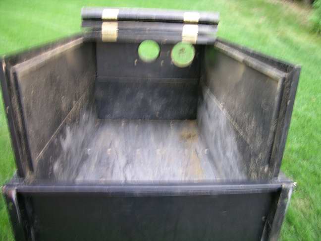

Re: 2210 bagger, Mat\'l Collection Systm, ballast rack!

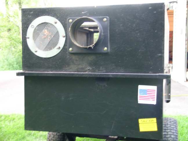

front view of cart. note that the screened hole to the left is a mistake I made and covered with a screen. I realized the plastic flange needs to be dead center. This is the only mistake I had in building the cap for this cart.

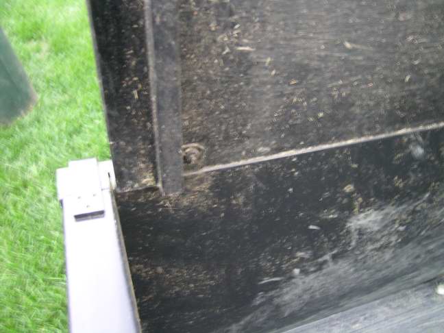

another front view at a different angle

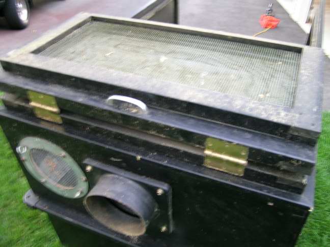

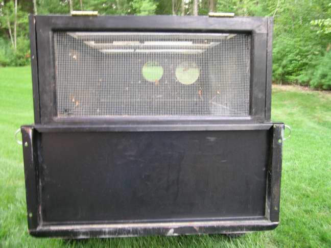

back view. note that the screen fits snug behind the tailgate. Probably 2-3 inches lower than the tailgate.

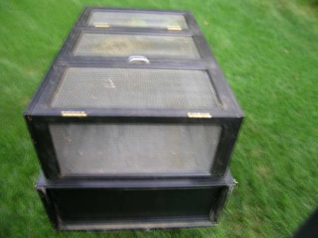

top view of the cart. in a moment I will show you how it all folds up.

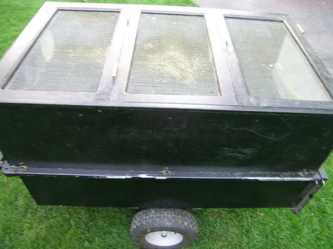

another top view.

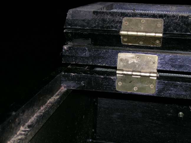

ok. all folded up and a look from the inside. The door jam is mitered down the back side of the cart and goes all around the inside of the cart to serve as support for the screens.

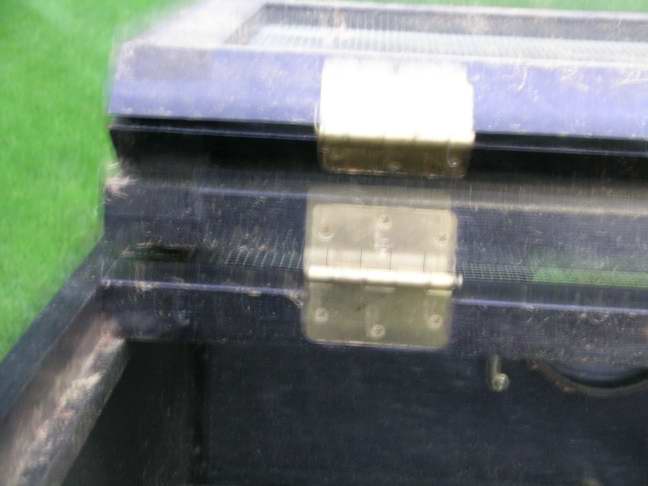

here is another folded up look from the front. This shows how the second set of hinges (front of cart to back ) are oriented.
