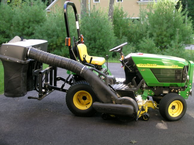

Don,
Take a look at the first post in this thread. I showed a pict of the complete 3 bagger MCS. You will also find a few tips sprinkled throughout the thread that you may find useful. The components are as follows:
- 3 bag (10 bushel) material collection system: 50 & 55 series tractors. This includes the 3 point bagger frame, bags and hopper top
- high performance power flow unit for X series tractors
- lower boot to join duct with powerflow. The lower boot includes a ready/full reminder pressure guage to let you know when the bags need to be emptied (extremely useful!).
- a length of 7 inch thermo plastic duct

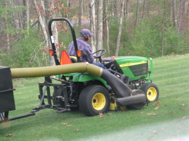

Haven’t had time to post anything but I’m up and running with that pto trac vac. Had a big problem, the guy I bought the vac from left a 6 " ratchet extension down behind the vac gear box, couldn’t see it with the guards on. When I started the vac up, the extension vibrated out and took out the main drive pulley. I’m Lucky that I didn’t break something in the vac gear box or on the tractor. The ratchet extension took out all 6 heavy cast iron spokes on the 8” pulley, so another $67.00 for a new pulley. Knock on wood it's working great now. I will try to post some pictures.

Here are the pictures of the PTO TRAC VAC on the 2210. I’m pulling the mower & Vac off tomorrow to put the snow blower on, so it was now or next year for the pictures. The TRAC VAC worked great, chops the leaves up so fine that the cart supposedly holds 52 bushels of leaves. At lest that what’s in the owners manual. I figure I was vaccuming a cart load of heavy leaves per acre.
