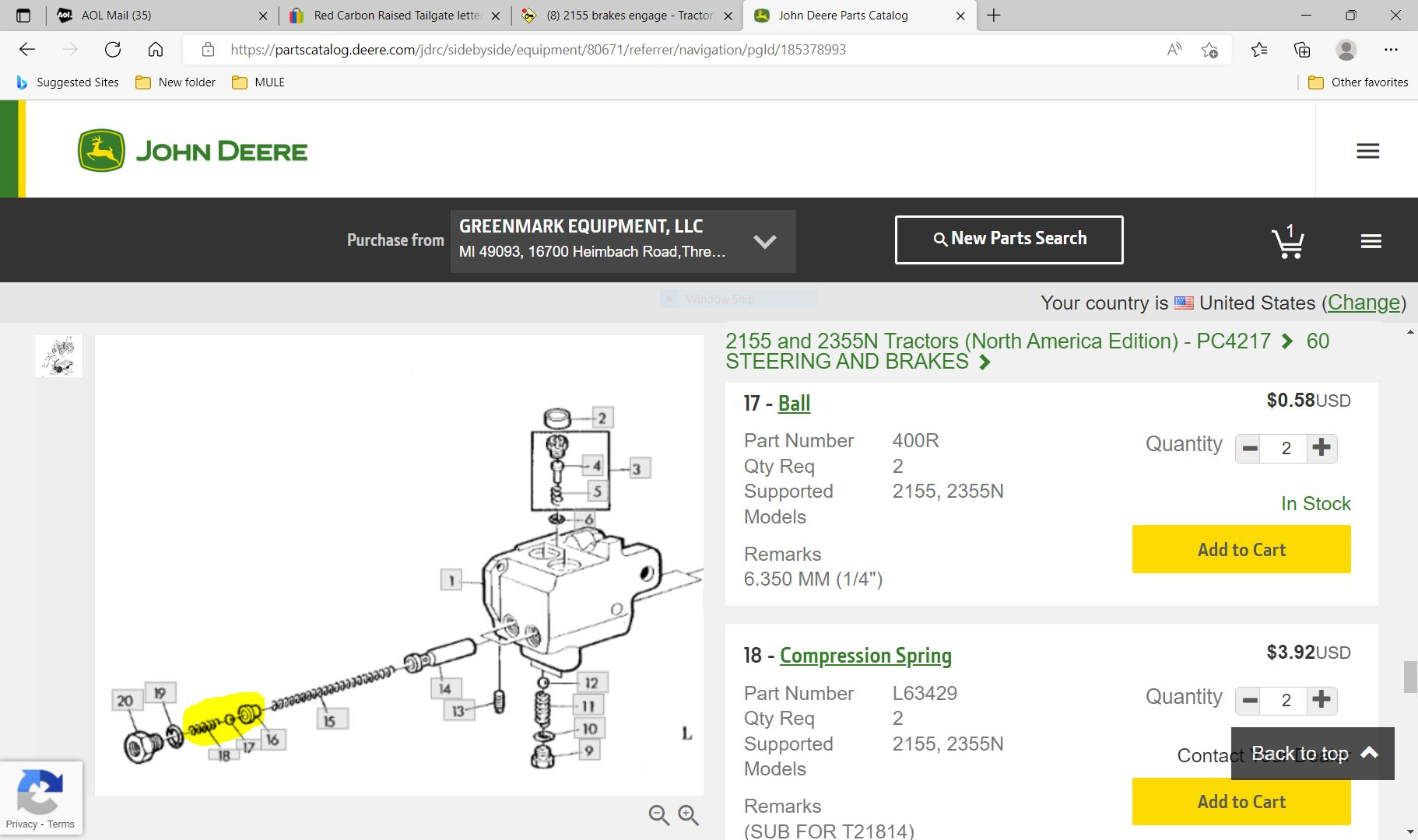

/ 2155 brakes engage
Yes, when I started the tractor and opened each brake bleeders at different times they both leaked hydraulic fluid out without the brake peddle pressed. So this is an indication that the valve body the break peddle is attached to has an issue with a leaky seal inside?
/ 2155 brakes engage #6
It might be the check valve that is for each brake line at the brake valve. Parts key 16, 17, & 18.
Check for contamination holding check valve open. Defective seat key 16, or weak/broken spring key 18
