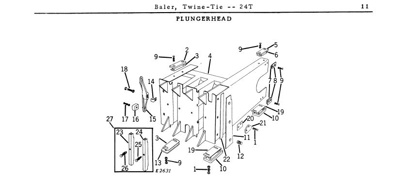

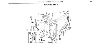

214 although older is higher capacity than 24. I never liked the wear pad bridge(parts key #15) on a 24 that was held onto the plungerhead with "one bolt" that could come up AWOL

Tx Jim thank you I can see if that wear pad come off in operation it could cause some real down time both machines are about the same price. I just need to go see them. thanks for your input.
