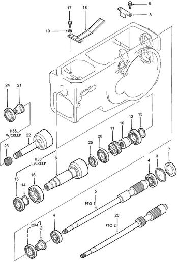

Own a NH 2120 with HSS that I bought new in 1997. Great machine but lately the PTO pops in and out when running an implement. If I push clutch in and out it will come back. Any ideas on what the fix is? Thanks.

do you have to shift the pto back in, like it became disengaged? or merely pushing the clutch in and releasing pedal fixes it?
soundguy
   / 2120 PTO stops and starts
Just depressing the clutch brings it back. Sometimes it take a couple of tries, then the PTO works fine.
   / 2120 PTO stops and starts #4
If the engagement lever does not jump back to neutral, it's probably not a gear related problem. There is a one way sprag clutch in the PTO drive train that could have an issue. Looks like it's in the rear housing, under the 3 Pt lift housing. Don't know what you use the tractor for, but this sprag would only come into play when decelerating with a high momentum load on the PTO. A built-in over running clutch.
When this problem started, I had my log winch on the tractor. When I engaged the PTO (at idle), it turns for a short while then just stops with no load. The PTO lever does not go back to neutral. Sometimes the PTO comes back on its own and sometimes I need to depress the clutch and it comes back. When the PTO is turning, it works fine.

Thanks, can someone describe the function and location of the "sprag" and what's involved to fix this?
   / 2120 PTO stops and starts #12
function? as discussed.. 1 way drive.. ( think ORC )
http://en.wikipedia.org/wiki/Sprag_clutch
1 1 SBA040109041 BALL BEARING Bearing, Ball, W/12x4, Start Year: 01/01/1987
2 1 SBA322610920 COUPLING Coupling, W/12x4, Start Year: 01/01/1987
3 1 80300633 SNAP RING RING, SNAP, Int, M80, Start Year: 01/01/1987
4 2 210048 BALL BEARING Bearing, Ball, Start Year: 01/01/1987
5 1 SBA322570920 COUNTERSHAFT Countershaft, PTO, W/12x4, W/540 PTO, 2120, NH-NA Only, Start Year: 01/01/1987
5 1 SBA322570910 COUNTERSHAFT Countershaft, PTO, W/HSS, W/540 PTO, 2120, NH-NA Only, Years: 01/01/1987-07/31/1993
5 1 SBA322570911 COUNTERSHAFT Countershaft, PTO, W/HSS, W/540 PTO, NH-NA Only, Start Year: 08/01/1993
6 1 SBA322570890 COUNTERSHAFT Countershaft, PTO, W/HSS, W/540 PTO, L/Creep, Years: 01/01/1987-07/31/1993
6 1 SBA322570891 COUNTERSHAFT Countershaft, PTO, W/HSS, W/540 PTO, Start Year: 08/01/1993
7 1 SBA322200180 COVER Cover, Start Year: 01/01/1987
8 1 SBA322280060 SUPPORT Bearing, Retainer, Start Year: 01/01/1987
9 2 SBA011510820 CAPTIVE WASHER SCREW SCREW, CAPTIVE WASHER, Hex, M8 x 20, G5, Start Year: 01/01/1993
10 1 SBA322611100 COUPLING Coupling, W/HSS, 2120, Years: 01/01/1987-07/31/1993
10 1 SBA322611101 COUPLING Coupling, W/HSS, Start Year: 08/01/1993
11 1 SBA398560891 BEARING ASSY Clutch Assy., One Way, W/HSS, Start Year: 01/01/1987

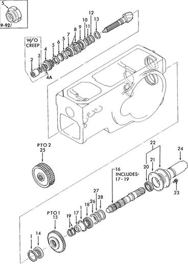

1 2 80300633 SNAP RING RING, SNAP, Int, M80, Start Year: 01/01/1987
2 1 SBA322611360 COUPLING Coupling, W/O Creep, Start Year: 01/01/1987
3 1 301646 CIRCLIP Ring, Snap, Int, M32, W/O Creep, Start Year: 01/01/1987
4 1 SBA322341610 GEAR Gear, Slide A, W/4WD, 2120, 26 Teeth, Drives counter gear Ref. 42, Fig. 7E3, Start Year: 01/01/1987
4A 1 370006 SNAP RING RING, SNAP, Ext, M40, CS040, 2120, Start Year: 06/01/1992
5 2 SBA022700400 LOCK NUT NUT, LOCK, 2120, Years: 01/01/1987-08/31/1992
5 1 SBA399370750 NUT Drive Pinion Lock Nut, Start Year: 09/01/1992
6 1 SBA028100400 LOCK WASHER WASHER, LOCK, 2120, Years: 01/01/1987-08/31/1992
7 1 SBA042530209 BEARING ASSY Bearing, Taper Roller, Start Year: 01/01/1987
8 2 370021 SNAP RING RING, SNAP, M85 x 3, Int, Start Year: 01/01/1987
9 1 SBA042532209 BEARING ASSY Bearing, Taper Roller, Start Year: 01/01/1987
10 AR SBA199280600 SHIM Shim, 0.1T, Start Year: 01/01/1987
11 AR SBA199280610 SHIM SHIM, 0.2mm Thk, Start Year: 01/01/1987
12 AR SBA199280620 SHIM Shim, 0.5T, Start Year: 01/01/1987
13 1 SBA199260070 THRUST WASHER Washer, Thrust, Start Year: 01/01/1987
14 1 210048 BALL BEARING Bearing, Ball, Start Year: 01/01/1987
15 1 SBA322341600 GEAR Gear, Slide A for PTO 1, NH-NA Only, Start Year: 01/01/1987
16 1 SBA322500750 PTO SHAFT Shaft, PTO Assy. Includes: Ref. 17 thru 19, Start Year: 01/01/1987
17 1 SBA399233240 COLLAR Collar, Start Year: 01/01/1987
18 1 SBA040109043 BEARING ASSY Bearing, Ball, Start Year: 01/01/1987
19 2 370006 SNAP RING RING, SNAP, Ext, M40, Start Year: 01/01/1987
20 1 5116701 SEAL SEAL, M35 x 55 x 11 Thk, Oil, Start Year: 01/01/1987
21 1 SBA322990341 GASKET Gasket, Start Year: 01/01/1987
22 1 SBA322150130 COVER Cover Assy., Start Year: 01/01/1987
23 4 SBA011510820 CAPTIVE WASHER SCREW SCREW, CAPTIVE WASHER, Hex, M8 x 1.25 x 20, G5, 2120, Start Year: 01/01/1987
23 4 SBA011510820 CAPTIVE WASHER SCREW SCREW, CAPTIVE WASHER, Hex, M8 x 1.25 x 20, G5, 3415, Start Year: 01/01/1993
24 1 C5NN726A COVER Cap, PTO, Grey, Start Year: 01/01/1987
24 1 SBA378110021 GUARD Cap, PTO, Grey, 3415, Start Year: 01/01/1993
25 1 SBA322360960 GEAR Gear, Slide B for PTO 2, 2120, NH-E Only, Start Year: 01/01/1987
26 AR SBA199280750 SHIM SHIM, 0.1mm Thk, Start Year: 01/01/1987
27 AR SBA199280760 SHIM SHIM, .2 or 0.008", Start Year: 01/01/1987
28 AR SBA199280770 SHIM SHIM, .5 or 0.020", Start Year: 01/01/1987
   / 2120 PTO stops and starts #13
i changed three of them last year on 1715 fords
I was wondering if you can help me out with a sprag clutch repair/replacement on a 2120 Ford. Does the Counter shaft (#6) typically need replaced as part of the repair? or is it the bearings, clutch and collar only(#s 25, 26, 11, 10 and 12) ?
