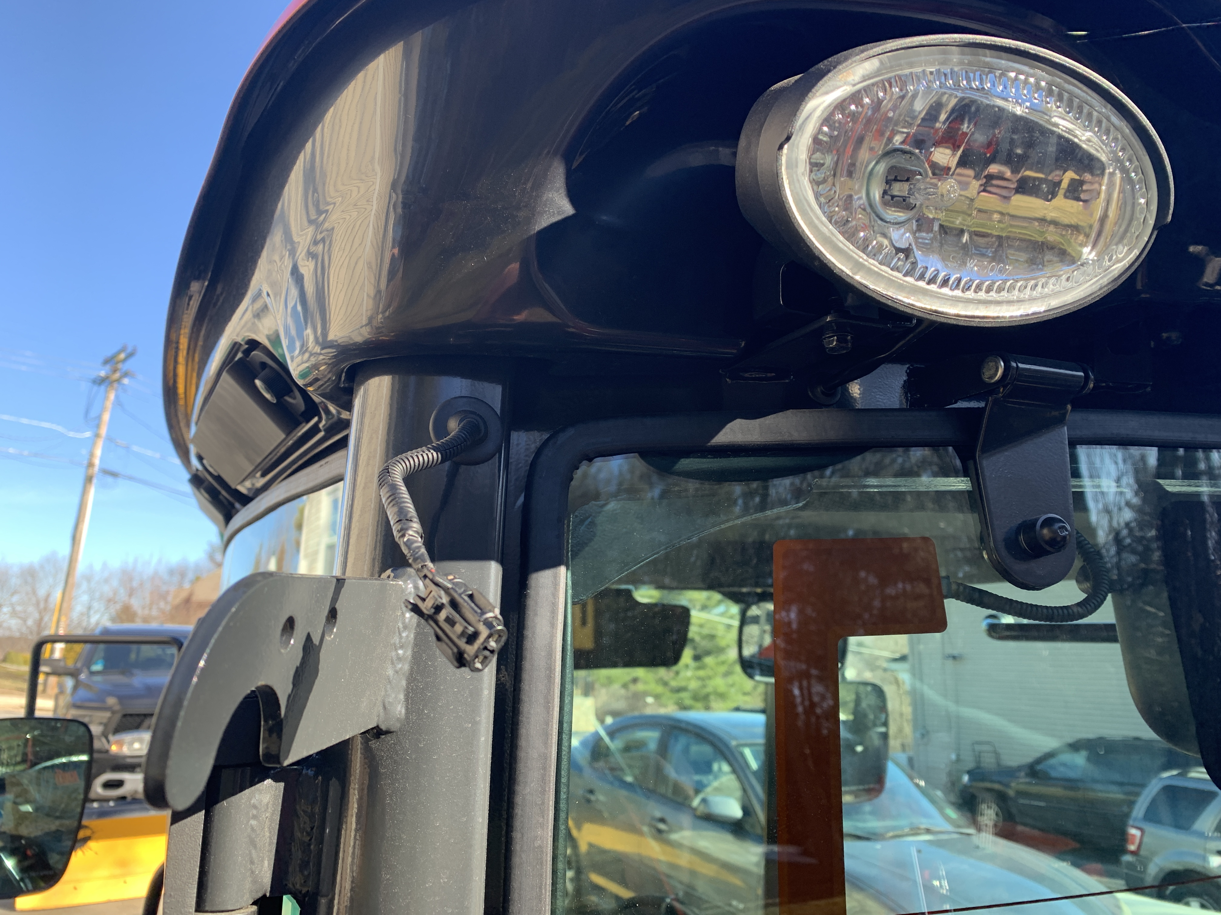

Kioti ck2610 se
On the back of the cab top right corner there is a spare plug. Does anyone know what powers it. The dealer thought it might be for a warning beacon but nothing is current made for it. I attached a small led and hit all the likely switches work light hazards headlight etc and nothing. Multimeter is my next go to. Thanks

I think that the plugs are for the beacon light option.
I plan to use them for side lights so I can see better through dust covered windows when it's dark.

Exactly what I planned on. Just trying to figure out what button sends power to it .

I have a ck4010sehc... The switch panel on the right in mine has blanks so there might be a plug end underneath and you'll have to purchase a switch to plug into it?

Yep that's what I was going to look for also. I think matching switches are available for not too much money. Just need to get the proper plugs to get the whole thing connected.
I will post if I find the correct switch and plug sources. Please post if you find anything.

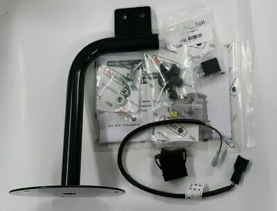

This looks like like it part # T5758-A7031 or TC25-A0003A although I cant find any online sources that sells it. This kit appears to includes everything for plug and play Ill have to check with dealer

Isn't it nice when the people who sell and service these machines don't know what it's for and how it's connected?
While my tractor is smaller and older I asked this same question in 2014 and they didn't know. And 2018 when I had it in for service in Perry Cty; no clue.
I think the 6 pin connector is probably for a trailer wiring kit. I tapped into it for my Aux ROPS mounted led work lights forward. The bullet connectors...who knows. I tapped it for my rear work lights.
